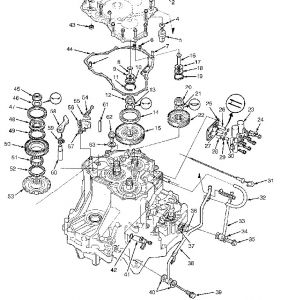

I have an automatic 1999 honda accord, 89,000 miles, that I put into park while I was moving. It makes a clicking sound when you drive over 10 miles and hour and in reverse. The clicking gets louder as you accelerate. It starts, stops, and shifts from P,N,R,D ok. No sound in when it idles in park, but some in nuetral. What do you think?

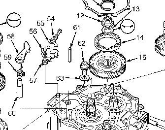

You probably damaged the parking pawl or parking pwal stop wold be my assumption. Maybe gear damage?

Suggested Repair
Inspect the transmission parking pawl and parking pawl stop for damage from shifting into park while moving, and check for related gear damage.
