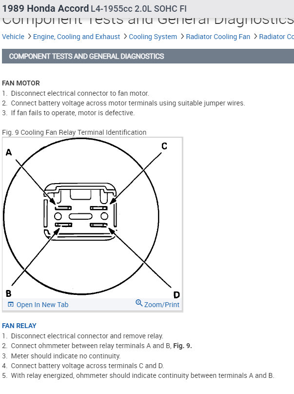

I recently received a 89 honda accord with 200000 miles took it to get emissions. Under the passenger headlight it started to leak water or coolant I was wondering if this could be from the reservoir or something else. Also the car runs hot when idle but when moving there are no problems. I was told to replace the thermostat and then if that does not fix the problem move to the water pump what is the best plan of attack?

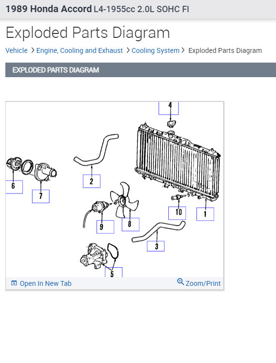

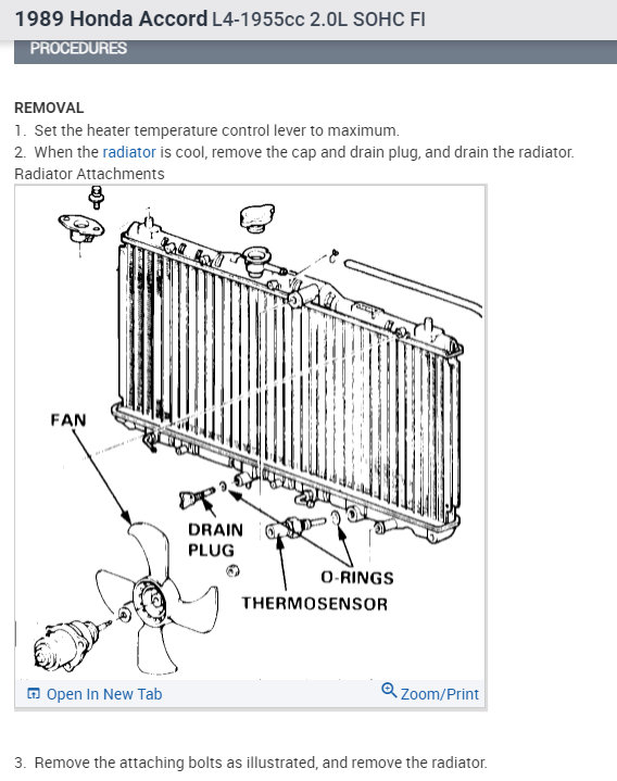

The first step should be to figure out where the leak is coming from. It could be the radiator hose or the radiator itself. Unless this gets fixed it could be difficult to pin down the overheating issue. As you know the engine can overheat due to being low on coolant.

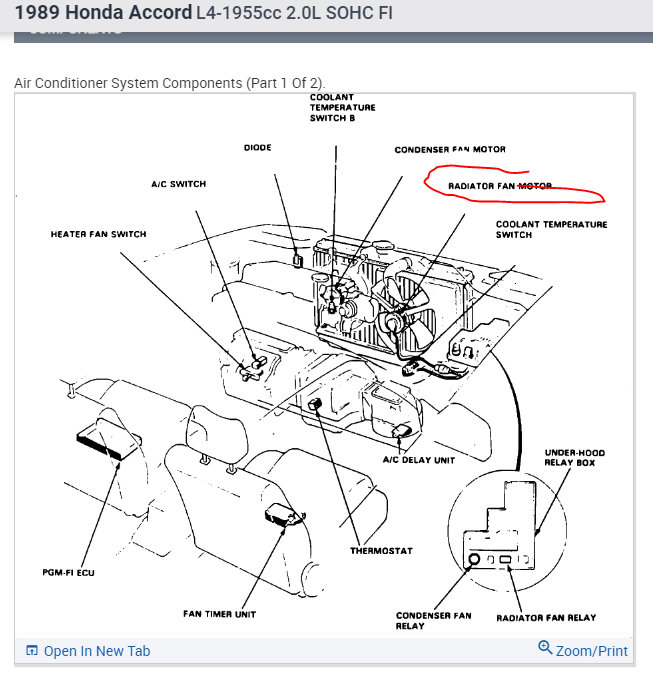

If you still have the overheating issue after the leak fix, then from what you are describing it could be an inoperative cooling fan. If the fan is not working then there is no air flow thru the radiator, while the vehicle is stationary. This makes the engine overheat. But cools back down as you drive and have air flow through the radiator.
https://www.2carpros.com/articles/how-an-electric-cooling-fan-works
