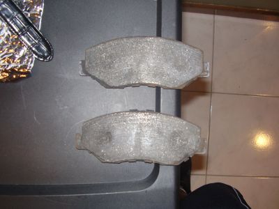

I took apart the front driver side brakes and found one of my pads had a crack in the middle and they are missing material on the sides.
Would this be indicative of a sticking caliper? I cleaned and lubricated the slide pins and the pin holes but haven't driven it but I doubt that would fix it.
What should I do?
https://www.2carpros.com/forum/automotive_pictures/491237_P6050116_1.jpg
Thursday, February 21st, 2019 AT 1:08 PM
CARADIODOC
  • 33,916 POSTS
I listed a whole bunch of stuff. Took an hour to type that goodness. Did you try any of the suggestions?
Cracks can develop in the linings from heat. That alone is not cause for replacement. Compare the lining thickness to the pads on the other side. Sometimes calipers tend to stick when the linings near the end of their life. Before removing the caliper, did you try to pry the piston back into the housing? If you tried but it wouldn't move, did you open the bleeder screw to allow it move easier? What was the result there?
See those 3/4" wide tabs on the ends of the pads' metal backing plates? Those should also be lubricated to reduce sticking.

I don't think you found too much unusual there. The pistons should move in fairly easily with a screwdriver. Bigger is ok too, but you should never HAVE to resort to a c-clamp. I know a lot of books show doing it that way, but only because most people already have the caliper removed when they start looking for a way to retract it. If the piston can not be forced in any other way than with a c-clamp, there's no way its going to release after normal braking either. That is cause for replacement. We used to rebuild calipers all the time during regular brake jobs, but store-bought rebuilt calipers used to cost over 90 bucks. Pistons needed to be replaced if there was any sign of rust pitting, but they were only 20 bucks. Today the piston is still 20 bucks, the rebuild kits are still around ten bucks, but a lot of good quality rebuilt calipers cost less than 30 bucks.
Since there was no change when opening the bleeder screw, that implies blockage of the hydraulic system is not a problem. When opening the bleeder and master cylinder cap helped, it was likely just because you were trying to move so much fluid and the cap was sealing so well, the air couldn't escape.
Moving the piston 1 cm is quite a bit. It only should go in far enough to make sufficient room for new, thicker pads. Most professionals retract pistons this way, (screwdriver), before they remove calipers during routine brake service.
As for the wheels spinning, it's hard to draw definite conclusions although it does kind of sound like the left caliper is sticking. One front wheel will always have less resistance to rolling when run jacked up like this, but it isn't a good indication of how it will act on the road. The next step is to put it in neutral to stop the right wheel, then block it from spinning. If you have vented rotors, just stick a screwdriver through the caliper into one of the vent holes. When you put it in "drive", the left wheel will be forced to spin. If it really resists spinning, or stops quickly after letting off the gas, that caliper is still tight.
One word of warning I often fail to mention; never push the brake pedal all the way to the floor to move the pistons out to the pads and rotor. It's good you understand it's necessary to get the pistons out there before driving, but most people are not aware that corrosion and debris build up in the bottom halves of the two bores in the master cylinder where the seals don't normally travel. By pushing the pedal all the way down, the seals can easily get cut on that junk. That results in a slowly sinking pedal and failure of at least one of the hydraulic circuits. The only fix is a rebuilt master cylinder.
Ok, as for the mounting pin with the collapsing boot, the vacuum just suggests it is making a seal that will be effective at keeping water, dirt, and salt out. Under normal operation, the caliper will only move the thickness of the inner pad lining, over the life of the pad. Of more importance though is after the brakes are released, the caliper will try to slide away from the center of the car just a little to release pressure on the outer pad. Failure to do that will result in the outer pad wearing much faster than the inner pad. (Sticking of the piston will result in rapid wear of BOTH pads compared to the other side of the car). Those mounting pins must be free of rust, pits, corrosion, and impacted dirt. In other words, they must be clean and shiny, then have a light film of high temperature brake grease applied. As long as you can move the caliper by hand, the mounting pin should be fiine. If you need a hammer to move the caliper, you've found a problem!
From everything I've read, my suggestion is to replace the left caliper, but to insure even braking forces, it's always best to replace both at the same time.
