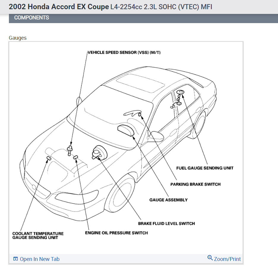

can the car car still be driven with a bad oil pressure switch how can I replace it?
Mar 21, 2010 at 1:57 PM
KHLOW2008
  • 41,814 POSTS
here is the location of the oil pressure sensor. Check out the diagrams (Below). Please let us know if you need anything else to get the problem fixed.

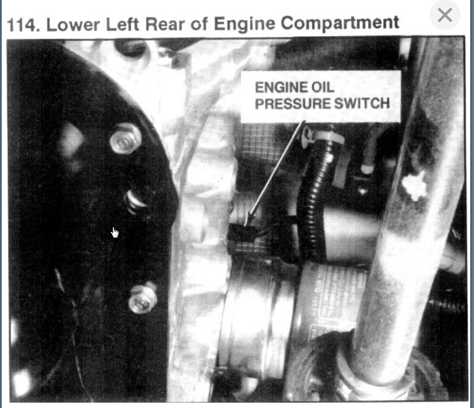

I have a 1992 Honda Accord EX 2.2L with 305650 miles on it and as of Friday the low oil pressure light flashes on and off. It only comes on after driving the car for a while. Sometimes it flashes dim like there might be something wrong with the wire. Well I went to the auto parts store and bought a new filter and oil pressure sensor and I can't find where the sensor is. I think it is right above where the oil filter is, but I am not sure. I was told that the only 3 things that would make that light turn on were the filter caving in on itself, the sensor or the oil pump. This car was owned by a honda dealership employee up until about 6 months ago when I bought it from them. This person always got all the routine maintenance done. Any input on where the oil pressure sensor is and what you think might be causing the problem would be greatly appreciated. Thank You
Jan 22, 2021 at 4:04 AM (Merged)
BMRFIXIT
  • 19,053 POSTS
[quote:9532ddaee9="jpd1844"]I have a 1992 Honda Accord EX 2.2L with 305650 miles on it and as of Friday the low oil pressure light flashes on and off. It only comes on after driving the car for a while. Sometimes it flashes dim like there might be something wrong with the wire. Well I went to the auto parts store and bought a new filter and oil pressure sensor and I can't find where the sensor is. I think it is right above where the oil filter is, but I am not sure. I was told that the only 3 things that would make that light turn on were the filter caving in on itself, the sensor or the oil pump. This car was owned by a honda dealership employee up until about 6 months ago when I bought it from them. This person always got all the routine maintenance done. Any input on where the oil pressure sensor is and what you think might be causing the problem would be greatly appreciated. Thank You[/quote:9532ddaee9]
oil pressure switch is located on center rear of engine above oil filter
good luck
JPD1844
Thanks!! I got it changed out.

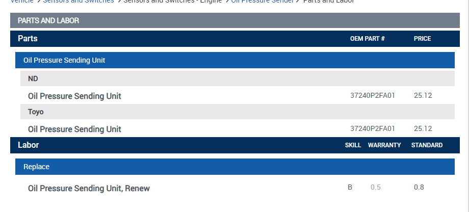

Just in case others need it in the future. Here is the location and part information for the oil pressure switch. Plus here is a guide that will help with low oil pressure issues:
https://www.2carpros.com/articles/high-or-low-engine-oil-pressure
Run through this material and let us know what questions you have and we can go from there. Thanks
