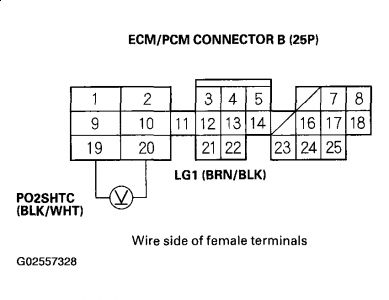

The Diagnostic codes from Autozone were P1166 and P1167. If it is the oxygen sensor, how do they know which one it is? Or do they just replace both?
May 10, 2009 at 11:16 PM
ZACKMAN
  • 4,202 POSTS
It may not be the sensor. It indicates the heater circuit, which is electrical problem, not the sensor. This is the upstream sensor (Sensor 1) , the one on the exhaust manifold. DTC P1166: A/F SENSOR (SENSOR 1) HEATER CIRCUIT MALFUNCTION 1.Reset the ECM/PCM (***Don't worry about this***). 2.Start the engine. Is DTC P1166 indicated? YES - Go to step 3. NO - Intermittent failure, system is OK at this time. Check for poor connections or loose wires at C102 (located under the under-hood fuse/relay box), the A/F Sensor relay, the A/F Sensor (Sensor 1) and the ECM/PCM. ***Still, you want to check the connection*** 3.Check the following fuses: POWER SEAT (20A) fuse in the under-hood fuse/relay box. No. 4 ECU (ECM/PCM) CRUISE CONTROL (15A) fuse in the driver's under-dash fuse/relay box. No. 6 LAF HEATER (20A) in the passenger's under-dash fuse/relay box. 4.Measure voltage between ECM/PCM connector terminals B19 and B20, 30 seconds after the ignition switch is turned ON (II).
https://images.2carpros.com/forum/automotive_pictures/55316_00accordp1166_1_1.jpg

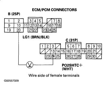

Is there battery voltage? YES - Substitute a known-good ECM/PCM and recheck. If the symptom/indication goes away, replace the original ECM/PCM. NO - Go to step 5 5.Measure voltage between ECM/PCM connector terminals C13 and B20.
https://images.2carpros.com/forum/automotive_pictures/55316_00accordp1166_2_1.jpg

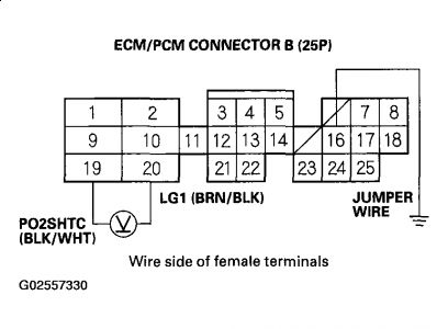

6.Turn the ignition switch OFF. 7.Disconnect ECM/PCM connector B (25P). 8.Turn the ignition switch ON (II). 9.Connect ECM/PCM connector terminal B16 to body ground with a jumper wire, then measure voltage between ECM/PCM connector terminals B19 and B20.
https://images.2carpros.com/forum/automotive_pictures/55316_00accordp1166_3_1.jpg

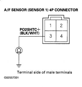

Is there battery voltage? YES - Substitute a known-good ECM/PCM and recheck. If the symptom/indication goes away, replace the original ECM/PCM. NO - Repair open or short in the wire between A/F Sensor (Sensor 1) and ECM/PCM (B19). 10.Turn the ignition switch OFF. 11.Disconnect ECM/PCM connector B (25P) and the A/F Sensor (Sensor 1) 4P connector. 12.Check for continuity between A/F Sensor (Sensor 1) 4P connector terminal No. 3 and body ground.
https://images.2carpros.com/forum/automotive_pictures/55316_00accordp1166_4_1.jpg

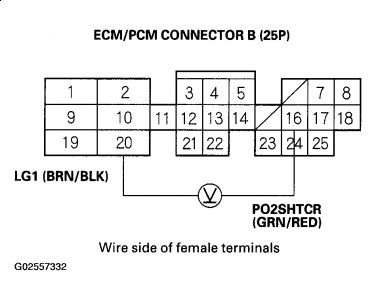

Is there continuity? YES - Repair short in the wire between the A/F Sensor (Sensor 1) and ECM/PCM (B19). NO - Go to step 13. 13.Turn the ignition switch ON (II). 14.Measure voltage between ECM/PCM connector terminals B16 and B20
https://images.2carpros.com/forum/automotive_pictures/55316_00accordp1166_5_1.jpg
Is there battery voltage? YES - Repair open in the wire between the ECM/PCM (C13) and the A/F Sensor (Sensor 1) or Secondary HO2S (Sensor 2). NO - Go to step 15. 15.Check for continuity in the wires between A/F Sensor and the fuses. Is there continuity? YES - The wires are OK. Replace the A/F Sensor relay. NO - Repair open in the wire between the A/F Sensor relay and the fuses. I'll email you the diagnostic for P01167.
