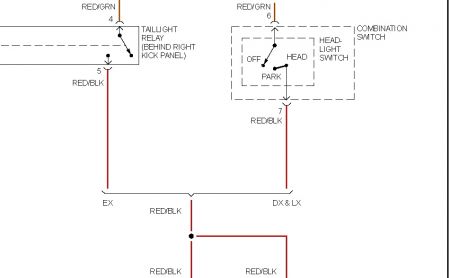

will a blown tail light bulb cause the dash lights to go off

I'm not sure which Accord you have? With the DX and LX, the instrument lamps get voltage from the headlamp switch. With the EX, voltage comes from the tail lamp relay. All I can do is track the circuit.
https://www.2carpros.com/forum/automotive_pictures/170934_accord_instrument_lamps_1.jpg
