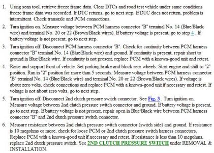

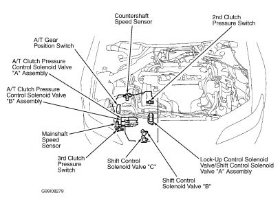

My 2000 Accord EX is throwing two codes, one is P0505 and the other is P1738. When I looked those up I saw that the first is probably related to the IAC and I plan to try cleaning the throttle body to see if that remedies that. The second I saw is related to the 2nd clutch pressure switch and this concerns me more since I had to replace the transmission once already in this car back around 130k miles and put in a used transmission at that time. Where is the 2nd clutch pressure switch located? Is it something I can easily get to to check the connection and/or replace the switch itself?

Hi Snipe656, Check diagram for location.
https://images.2carpros.com/forum/automotive_pictures/192750_Accord00TransSolenoid_1.jpg
https://images.2carpros.com/forum/automotive_pictures/192750_P1738Testing_1.jpg

Thank you for the diagram and quick response.
