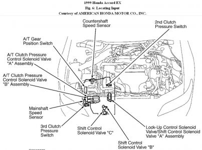

I have contacted the technician and made him to drive the car for2-3 miles and he agreed there is problem and assumes the root cause as an issue with Tran valve and Solenoids. There are currently NO CEL on my car. Previously it was 700 and 702.
The problem of hard shift is mostly during the mornings or whenever the car is taken out first time in a day.

P0700 is set when there are other trouble codes. P0702 is not found in the list. Are you sure the code is correct?
https://images.2carpros.com/forum/automotive_pictures/192750_TransComp99Accord4cylFig06_1.jpg

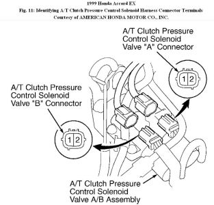

Problem is most likely caused by the A/T clutch Pressure Control Solenoid Valve "A " and " B" Assy. Get them checked.

I remember the code description, which is related to Transmission Control Electrical system...
Please advice on how do I ensure or verify with the mechanic has really done the testing of A/T clutch Pressure Control Solenoid Valve "A " and " B"?
Sep 30, 2010 at 12:10 PM
KHLOW2008
  • 41,812 POSTS
It is not possible to know if he performed tests on the solenoids and here are the testing procedures. A/T CLUTCH PRESSURE CONTROL SOLENOID VALVE "A" & "B" ASSEMBLY 1. A/T clutch pressure control solenoid valve "A" and "B" assembly is located on transaxle. See Fig. 6 . Disconnect harness connector at A/T clutch pressure control solenoid valves "A" and "B". 2. Using DVOM, measure resistance between solenoid terminals. Resistance should be about 5 ohms. Replace A/T clutch pressure control solenoid valve "A" and "B" assembly if resistance is not as specified. 3. Check A/T clutch pressure control solenoid operation. Apply battery voltage to terminal No. 1, and ground terminal No. 2. See Fig. 11 . A clicking sound should be heard from each solenoid, indicating solenoid operation. Replace A/T clutch pressure control solenoid valve "A" and "B" assembly if solenoid fails to operate.
https://images.2carpros.com/forum/automotive_pictures/192750_TransComp99Accord4cylFig06_2.jpg
https://images.2carpros.com/forum/automotive_pictures/192750_ATClutchPressureSolenoid99AccordFig11_1.jpg
