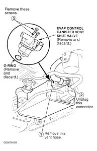

SRINUPRAKASH
My 99 Honda Accord has a Malfunction Indicator Light ( Engine) On and I went to the Mechanic and he has done the diagnostics and gave me the code
Po1457.
And told me to get the evaporation valves to be replaced.
How much could be the total repair costs be?
Please answer.
Srinu Prakash

***This is a common problem with Accords, especially ones that is driven around the snow-belt area. The EVAP system can often corrode causing the check engine light to go on. As your vehicle has out of warranty for a long time, I highly doubt that the warranty appies to you, but hey, it doesn't hurt to ask. It is a well-known defect/malfunction. You have to order the parts from Honda anyway (no aftermarket parts store carries the part). I included a partial description of the Technical Service Bulletin provided by Honda.***

PROCEDURE B
1998-99 ACCORD (MODELS NORMALLY DRIVEN IN ANY OF THE STATES LISTEN IN "APPLIES TO" HEADING)
1. Raise the vehicle on a lift.
2. Remove and discard the EVAP control canister vent shut valve and O-ring. See Fig. 2 .
3. Install the new vent shut valve and O-ring.
4. Lower the vehicle.
Fig. 2: Removing EVAP Control Canister Vent Shut Valve
https://www.2carpros.com/forum/automotive_pictures/55316_P1457_1.jpg
