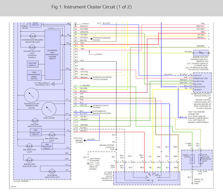

I have a 98 accord lx as soon as I turn the car on even when its cold the gauge goes right to hot I have the repair manual it say's the wire from the sending unit to the dash is grounded somewere so I had a new wire ran and its still doing the same thing I even replaced the sending unit I also replace the cluster. Is there anything else it could be?

Hi bulldog87,
Check the ground circuit for the meter cluster.

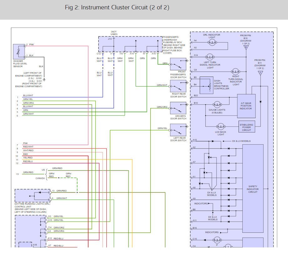

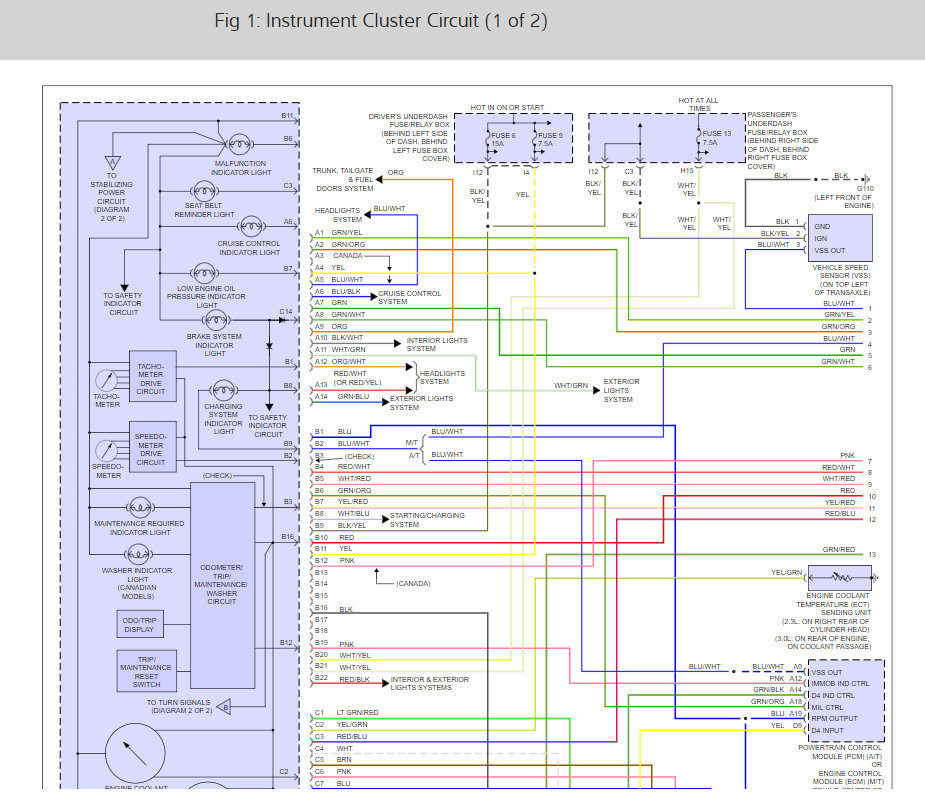

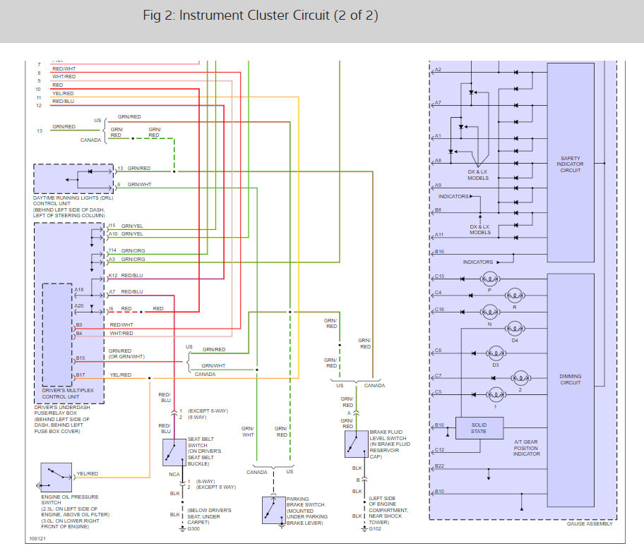

Here is the wiring diagrams so you can see how the system works and a guide to help you test the ground. Test the black wire.
