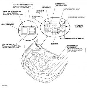

Hello folks, my Accord is acting weird these past couple of months. Whenever I am on a stop and go traffic ( I really mean stop and go) the needle on my dashboard's temp gauge is going up the roof. I had to stop and take a 15 minute rest just to have the engine cool off a little bit. Then, whenever I do a continous driving, the temp goes back to normal. I also tried one time when it overheated to just drive it back home, and voila! What do you know, the temp went back to it's normal state. I had the cooling system flushed. I had it serviced also. One thing that I noticed was the cooling fans won't turn on whenever ngine is getting hotter, the same whenever I am waiting for example in a parking lot and my engine is running. I usually noticed that the cooling fans will turn on intermittently. I also checked the fuse for the cooling fans and it is okay. Please help, I don't have a fortune to spend on car repairs. Your input is very much appreciated. Thanks a lot!

Check/replace the radiator fan relay in underhood fuse/relay box
https://www.2carpros.com/forum/automotive_pictures/266999_rad_1.jpg

Hi Dave H! Thanks so much for your help. I just have one thing to ask, do you have a much bigger picture? I am having a hard time figuring out the info on the pictures. Thanks in advance and Happy Holidays!

Try saving the picture onto your comuter. You should then be able to make it bigger or zoom into it.

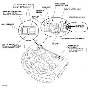

I tried saving it already before I asked you but it is still unreadable. I tried zooming it in but the words and the image became blurred, I even tried to print it out but no luck, couldn't read anything off of it.

Check or replace this rela ... middle on right hand side of underhood fuse/relay box .. i can't make it any bigger ..sorry hope you can see this ?
https://www.2carpros.com/forum/automotive_pictures/266999_rad_2.jpg
