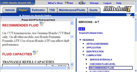

Where do I add transmission fluid? Any idea of what kind type to buy? I don't have a manual. 97 honda accord 4cyl.

https://images.2carpros.com/forum/automotive_pictures/12900_tranny_dipstick_and_fluid_1.jpg
Dipstick its gonna be at the front bottom part of the engine its a yellow handle
