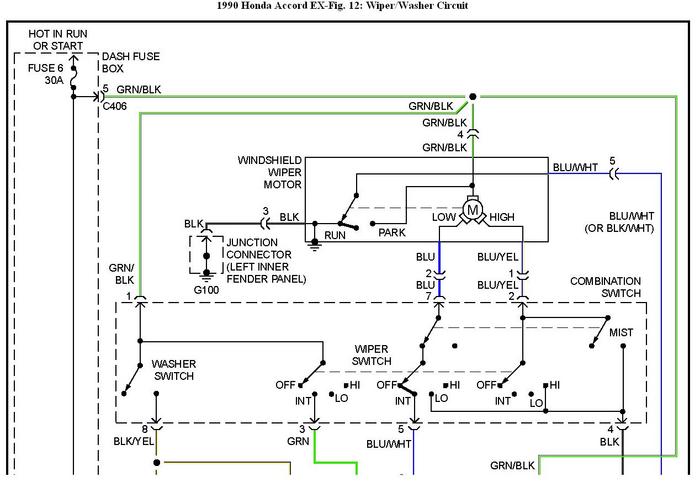

wipers will not work
BERNARDIA
The windshield wipers only work if i hold the lever down (lever goes up or down for manual wiper movement and gets turned forward and backwards for intermittent setting). The intermittent setting does not work anymore. How do i fix it? please help driving in the rain gets extremely annoying. thanks

If you have to hold the lever in a particular position to make it work, Im thinking the multi-function switch (wiper/turn signal) needs replacing.

windshield wipers do not work. i have changed the motor already and still does not work.

Have you checked the fuses and tested the wiper switch?

okay, so i have replaced the switch and the wire from the steering console and the second harness. it still does not work. I have also tested to see if there are any power from the motor harness and it is giving power. i am stumped.

Replacing components without testing and confirming them to be bad is a costly and time wasting job. You should perform test first to locate the source of the problem.
WIPERS DO NOT OPERATE IN ANY POSITION
Blown fuse No. 6 (30 A) in dash fuse block.
Faulty wiper motor assembly.
Disconnected wiper linkage.
Faulty wiper switch.
Poor ground.
Check for open circuit in Green/Black wire.
Check for loose or disconnected terminals.
© 2008 Mitchell Repair Information Co., LLC.
From the schematic, ground the Blu wire to test if the motor works in the low speed position.
Grounding the Blue wire should get the wiper running in high speed mode.
Perform above with wires connected and back probing the connectors concerned.
System is linked to Integrated Control Unit plugged into fuse panel at left kick panel.

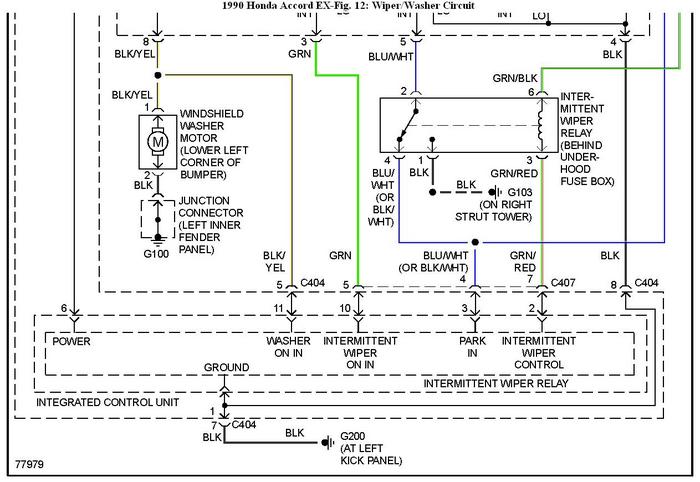

only performed tests on the motor and the switch, but does the wiper have a relay that is under the fuse box on a 1990 Accord model? i was on a Honda forum and someone told me to replaced a relay under the fuse box and it fixed his wiper problems.

There is an intermittent relay under the fuse box. If the relay is faulty, the wiper would not park itself.
To access the relay, remove the bolts holding the underhood fuse box and lift it up. You would see the relay bolted onto the lower part of the fuse box.

The relay is only for intermittent operations. If low and high speed mode is not functioning, the likely cause would be the integrated control unit, plugged into the underdash fuse box. At wiper switch, ground the blue wire (low speed) and blue/yellow high).
Ground the black wire and turn wiper switch on to test if wiper works according to the speeds. If yes, either the integrated control unit is bad or there is an open in black wire between switch and integrated control unit.

The wiper intermittent relay seems faulty or disconnected. Check the relay located under the main fusebox underhood near the firewall.

All those circuits may share a common grounding point. it may be loose or dirty. Many Hondas have a sort of "intermediate control module" which in many cases consolidates multiple functions. I can recall one Honda where the headlight warning chime and the seat belt warning chime failed not long after one another. The fix was this particular module being replaced. I would have to see a wiring diagram to see if the connection to the intermittent wipers is possible. my gut feeling says it may be. Generally, it is found behind the plastic kick panel on either passenger or driver side.

Extech is correct, there is an integrated control unit plugged into the the main fuse box at driver side under dash.
But check the intermittent wiper relay first, it is located under the fuse box under hood. Check the wire sockets under the fuse box, sometimes they tend to have corroded or contaminated connections.
