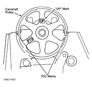

I bought a 1992 honda but I changed the motor to a 1995. When I first drove the car it drove like a baby. Three weeks after the swap the car starts loosing it good performance. It started to pull back when I drive it. It sound like its idleling on its own. Something like vroom vroom, and its poping from the mufler

Yes I changed the spark plugs the wires and the fuel filter. And I also put fuel injector cleaner in the gas. I check my timing belt and its good, but I don't know if its on the right timing. Theres no mark that shows if it is. It only has the word up on it, and its not up. How can I put it on time if it isn't

If the car had been running well, it should not be a timing belt problem. Get a timing light to check the ignition timing and if it is not far off and adjustable, no problem with timing belt.
https://www.2carpros.com/forum/automotive_pictures/192750_61395_Graphic2_3OdysseyTiming_1.jpg
