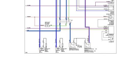

1995 Honda Accord 4 cyl Automatic 110,00 miles
My 95 honda accord ex is having AC problems. The compressor clutch wouldn't engage. Checked fuses and relays all are ok. I had the engine idling for a while and the AC switch on and the condenser fan (driver side fan) was not running and all of a sudden it kicked on the the comp. clutch engaged. The fan ran for about 15 seconds and shut off and clutch disengaged. This repeated 4 or five times with four or five minutes between intervals. From what I have read the fan is suppoed to come on when the AC is turned on thus engaging the comp. clutch. Is my Radiator Fan Control Module the problem?
Jun 5, 2010 at 10:02 PM
  • CAR REPAIR CONTRIBUTOR
  • 75,992 POSTS

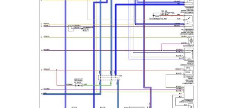

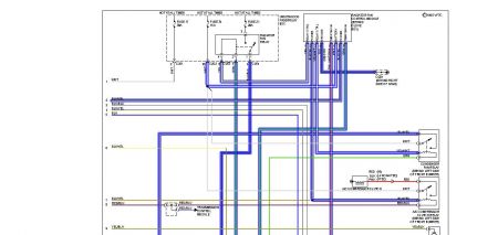

Hi jbrughelli, Welcome to 2carpros and TY or the donation. Check fuse no.34 15amp in the underhood fuse/relay box and test the condenser fan relay behind left side of front bumper. If both okay -the problem is coming from the radiator fan control module behind glove box
https://images.2carpros.com/forum/automotive_pictures/12900_ac1_4.jpg
https://images.2carpros.com/forum/automotive_pictures/12900_ac2_3.jpg
https://images.2carpros.com/forum/automotive_pictures/12900_ac3_2.jpg
Jun 5, 2010 at 10:24 PM
JBRUGHELLI
I changed the module and no change in problem
