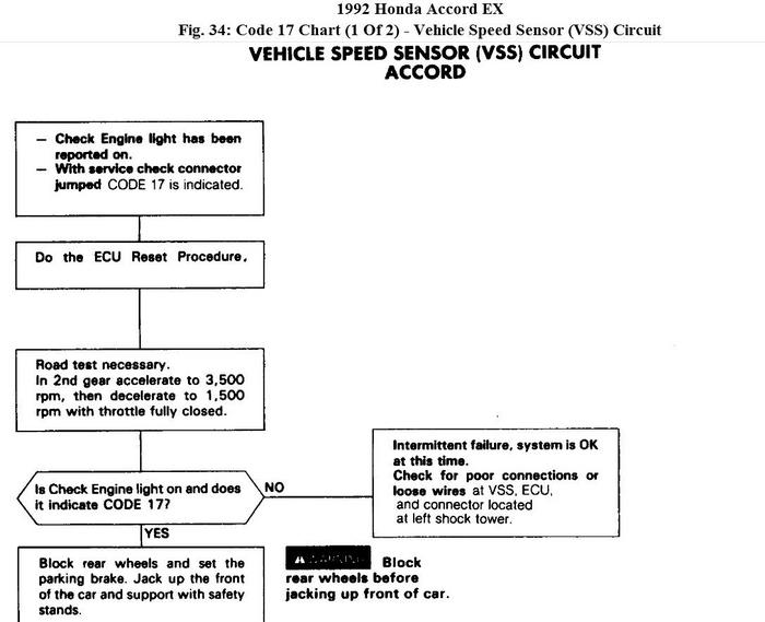

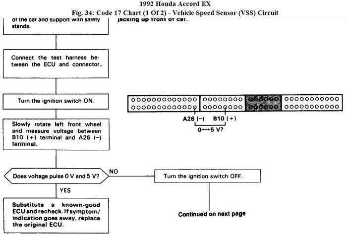

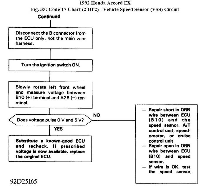

You will need to use these steps to diagnose the faulty speedometer.
https://images.2carpros.com/forum/automotive_pictures/261618_Noname_648.jpg

it's on the transaxle and it hs to pulse between 0-5 volts when turning. it could be a wiring issue as well unless there is a speedo cable if there is lube it
