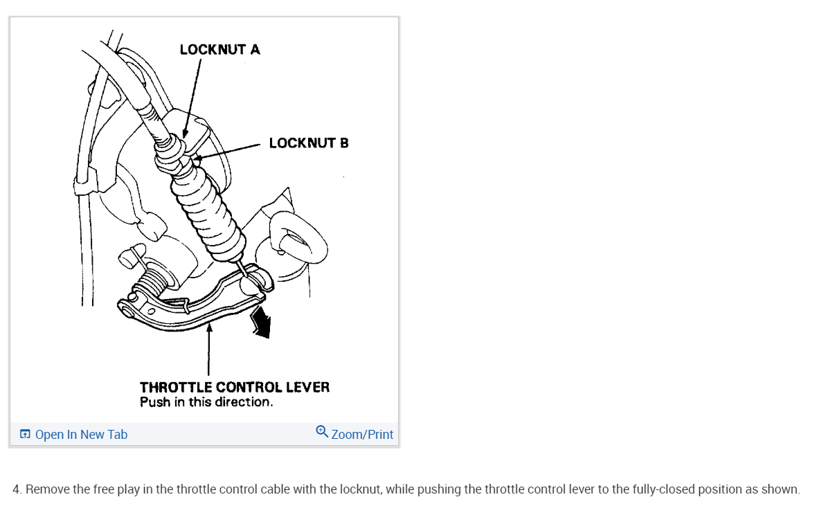

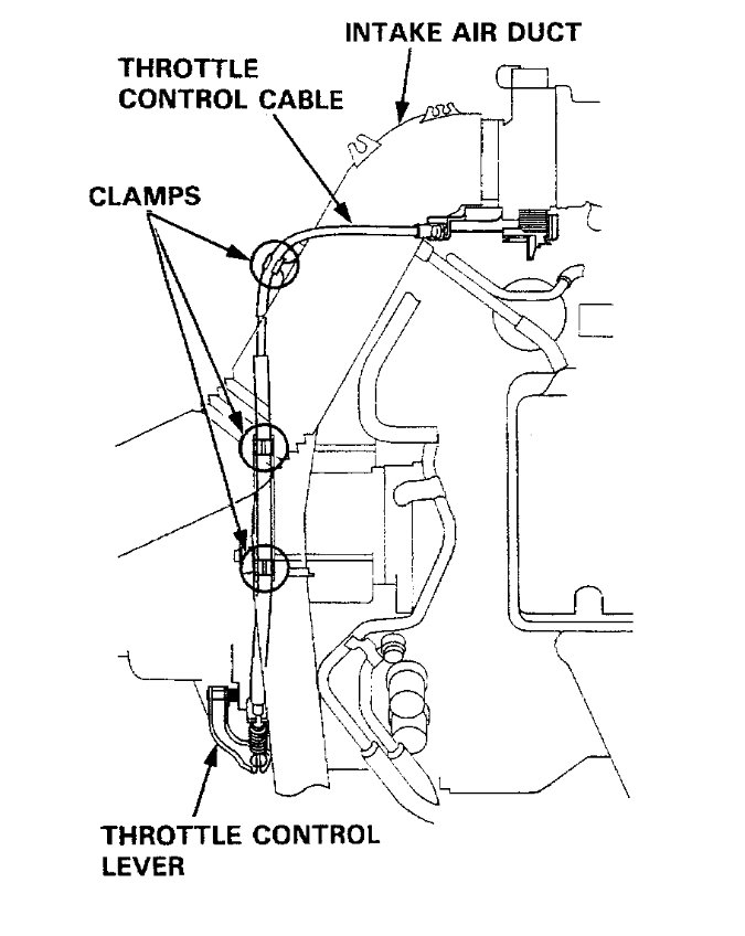

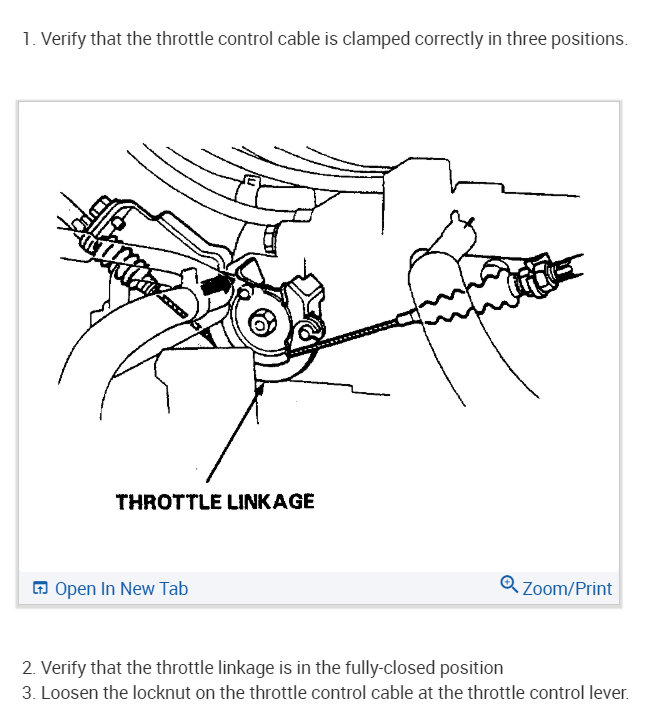

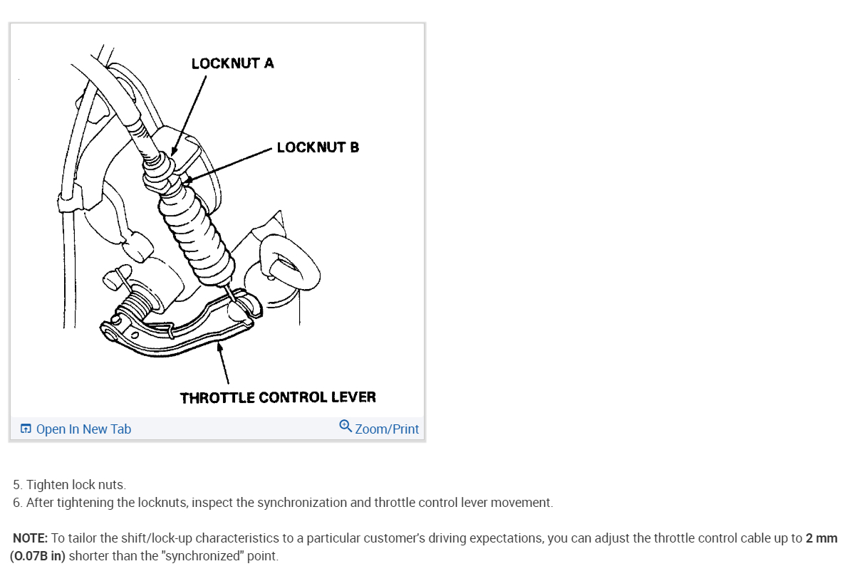

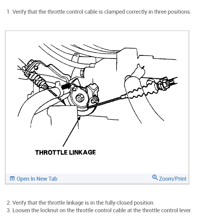

How do you check the throttle cable adjustment? I can’t find any information on adjusting it. Where? How?
Dec 13, 2019 at 1:44 AM
DIYMECH7
94 Honda Accord 2.2 Automatic
Dec 13, 2019 at 1:46 AM
  • 55,512 POSTS
Here is how to adjust the throttle pressure cable which tells the transmission how much throttle you are giving it. Check out the diagrams (below). Please let us know if you need anything else to get the problem fixed.
