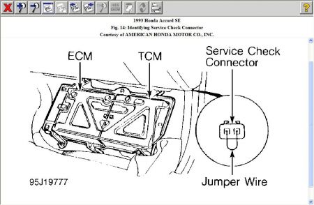

Hi Bcammy918, Retrieve the trouble code and let me know what it is. Bridge the SCS and turn ignition switch ON, count the blinking of the D4 light.
https://images.2carpros.com/forum/automotive_pictures/192750_SCS93Accord_15.jpg
If the TCM is equipped with a LED window, you can count the blinks from there with ignition switch turned ON.
