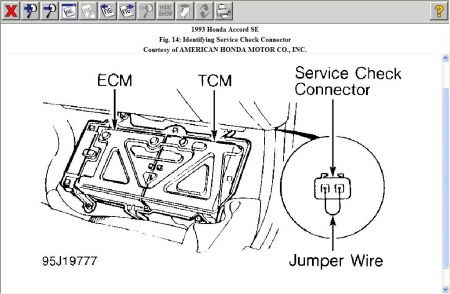

https://www.2carpros.com/forum/automotive_pictures/192750_SCS93Accord_1.jpg
Bridge the connector, turn ignition on and count the number of long and short blinks for all 3 indicator lights and come back with the error codes. Long blink = 10, short = 1.
