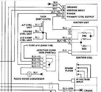

It has a new coil, does not mean it is good, but I was moving to the relay next. There is a wire I could not follow running from the distributor igniter. I could not follow to where it goes, looks like it runs inside. Also, when I engage the ignition there is a semi loud click coming form underneath the passenger side floor.

Hi Steven,
Hope the diagram is enlightening. The two white wires goes to the ECM.
https://www.2carpros.com/forum/automotive_pictures/192750_IgnitorSchematicHonda01_1.jpg
