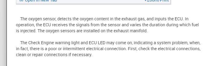

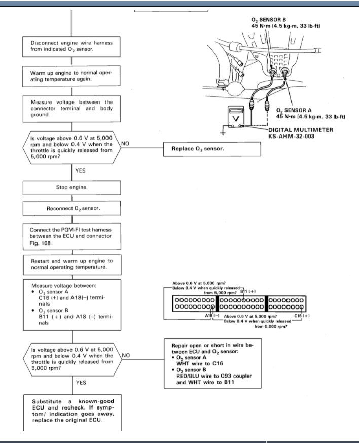

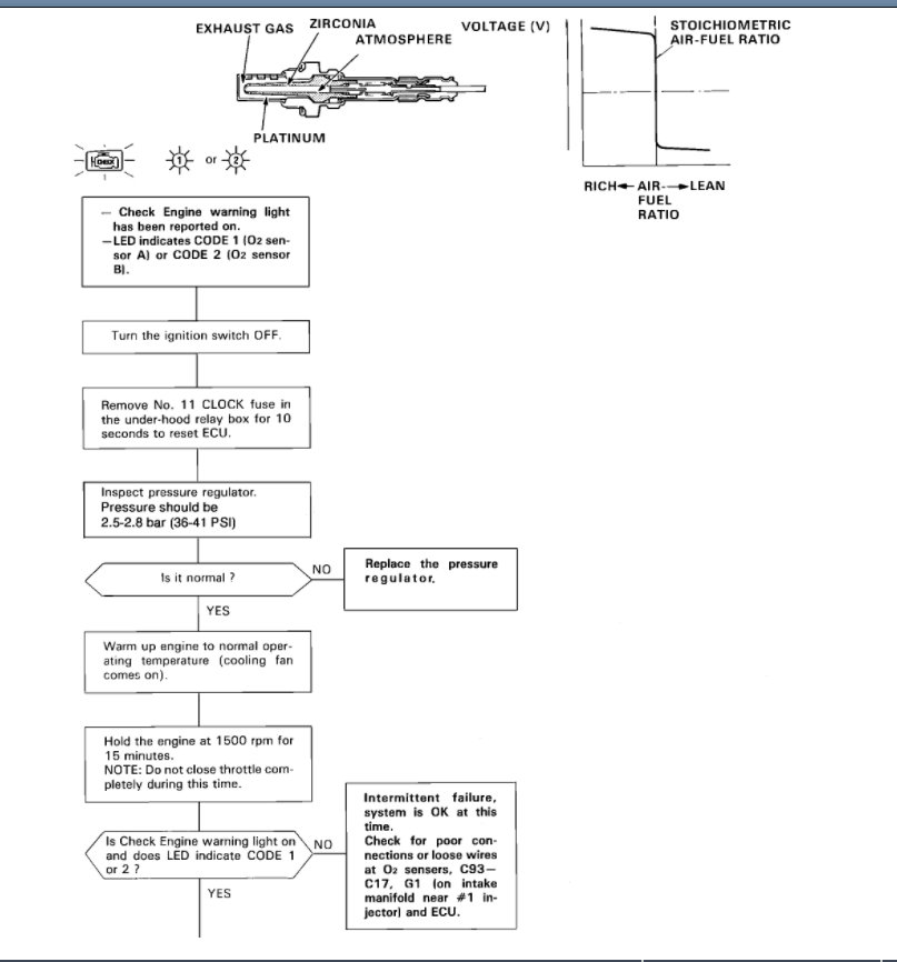

I am attaching the info on this DTC which is for an o2 sensor but basically it is telling you that it is getting a signal that it does not expect so it assumes the sensor is it the issue.
However, if you have a vacuum leak on this older vehicle then that will cause the ECM to think the o2 sensor is the issue. So, we need to start with making sure there is no vacuum leak.
Then we need to run through the actual testing for the code and see what comes up.
Please run through this and let me know what you find. Thanks
