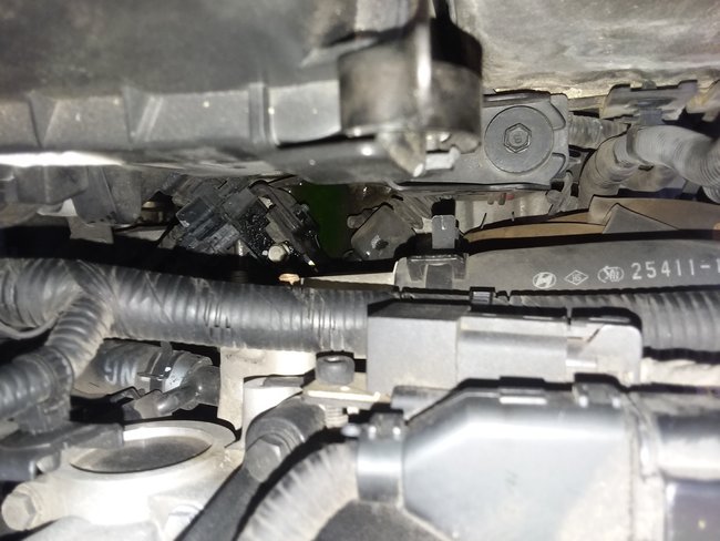

Also, should I be concerned with this? I think it's coolant not sure if it's leaking though. I recently just got an open thermostat repair so the mechanic drained and refilled new coolant. Maybe it's just spilled coolant? Not sure

It looks like spilled coolant, easy way to tell would be to rinse it away and see if it comes back. I would try replacing the fluid as a first step in the transmission however I'm leaning more toward a brake issue. After you drive it do you notice any hot brake smells or feel heat at any of the wheels? That would be a big clue and why I suggest checking the temperature of the brakes. You could have a bad master cylinder or line that is blocking fluid return and as the vehicle is driven the fluid heats up and applies the brakes enough to slow you down.

New update: I took it to the same shop that repaired the thermostat today in case it wasn't spilled coolant. It was indeed a "faulty gasket". However, a new issue has come up today. It's taking longer to turn over and now the car is revving itself up to 2.5k RPM when it does turn over and sits there until it slowly drops down to normal idle range. Is this a vacuum leak? Or possibly sensor issue? I checked the brakes after I drove but there wasn't any heat resonating off them, just a bit warm to the touch. I did smell a bitter sweet burnt odor coming from the hood and have been told by others that it "smells hot". You could be right about something heating up and negatively affecting other components because it seems to drive well enough for a minute or two until it starts the sluggish process all over again.
