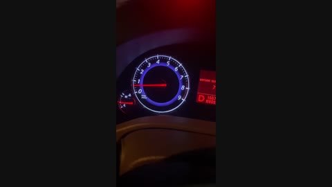

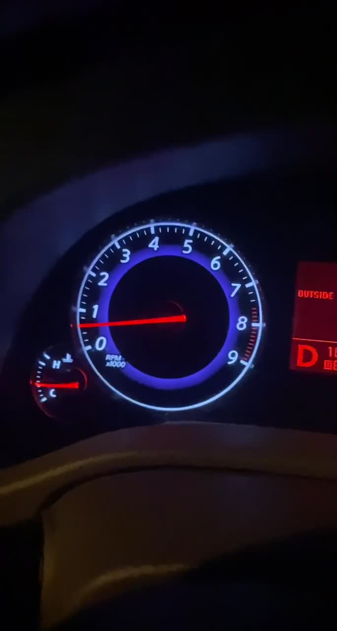

When I start the car, the RPMs goes up like I’m giving it gas. It also has a vibration that is felt where your feet go.

Yes, so the car idles fine but sometimes the RPMs fluctuate, and the interior and headlights start to flicker when at a red light and I do hear a faint whistling sound. Only work done was replaced bank 1 catalytic converter.

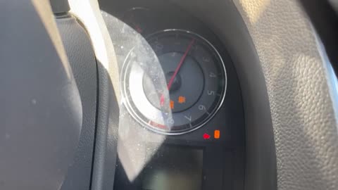

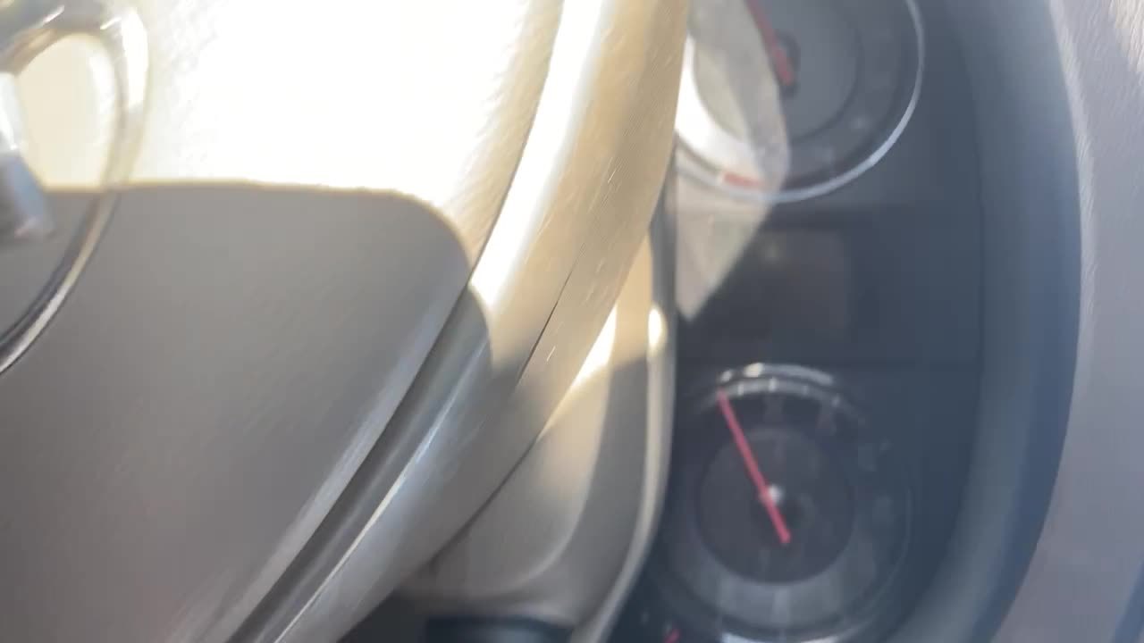

I also attached 2 videos, one with the whistling sound and the other of the RPMs fluctuation.

If the RPMs get low enough, it could cause a lighting issue. The whistling sound has my attention. Can you tell me approximately where the sound is coming from? I'm questioning it because an engine vacuum leak can cause the RPM issue. A leak can cause a whistling sound.
Let me know where you are hearing it from.
