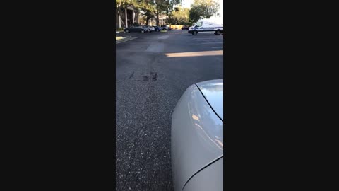

Here's the video. When the screeching goes to a higher pitch, I'm stepping on the brakes.
Thanks for the help!

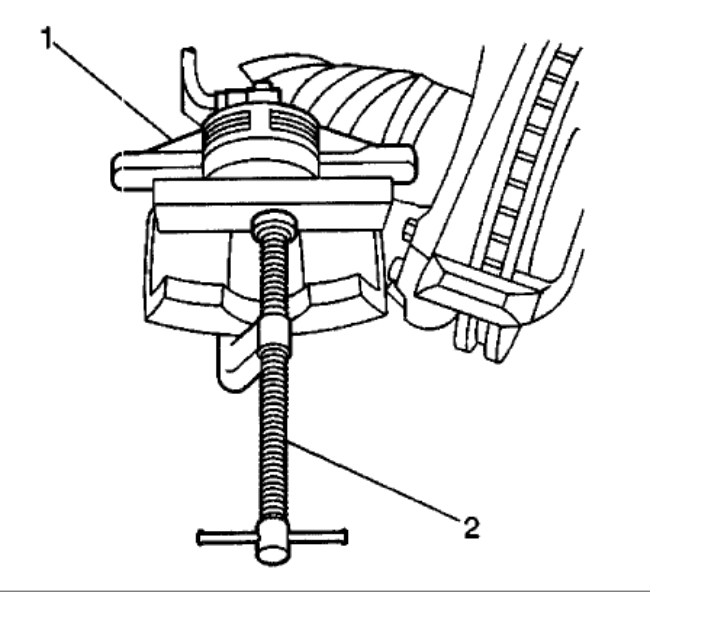

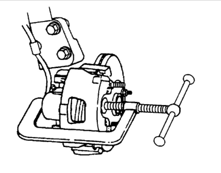

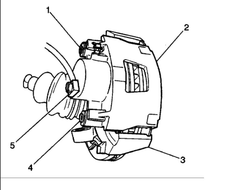

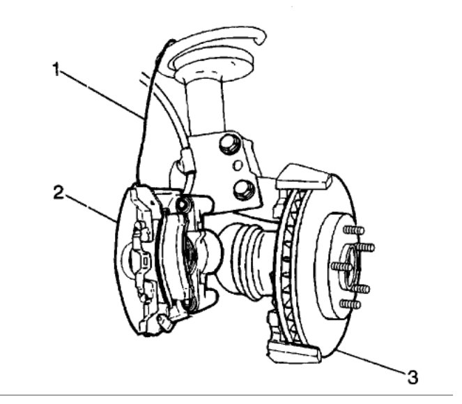

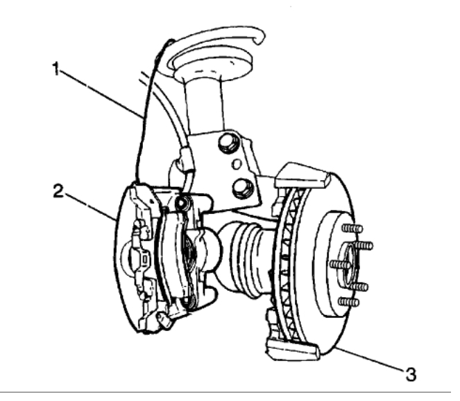

Thank you so much for the video! you need front brake pads and rotors. Here is a guide to give you an idea of what you are in for along with some diagrams to help you get the job done. The noise you are hearing is the screamer which is on the pad hitting the rotor. Read these guide before you begin you can save about $200.00 doing the job yourself with parts from Amazon.
You will need to jack the car up safely as well.
Check out the diagrams below
