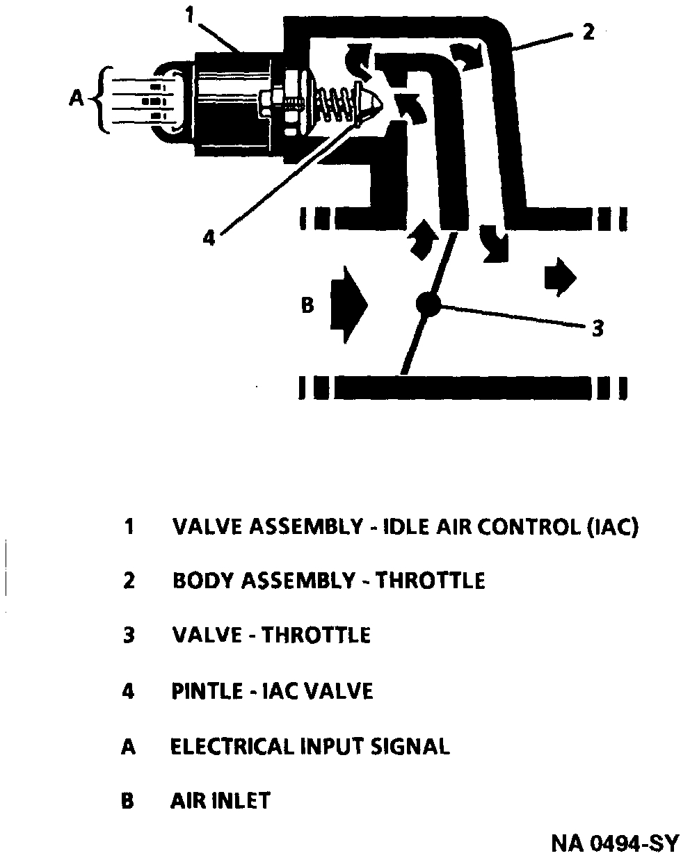

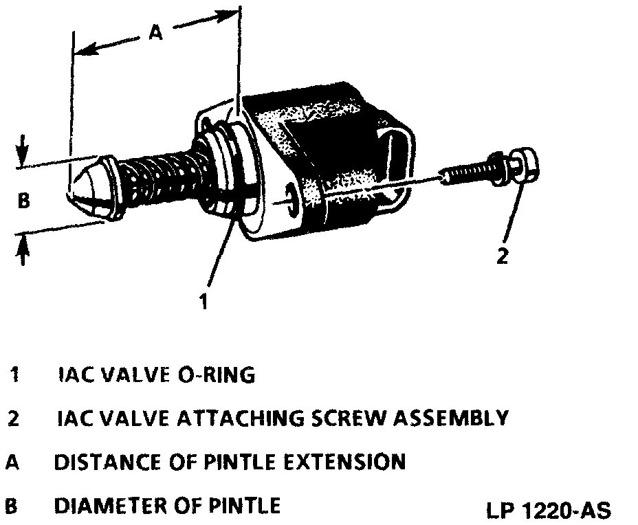

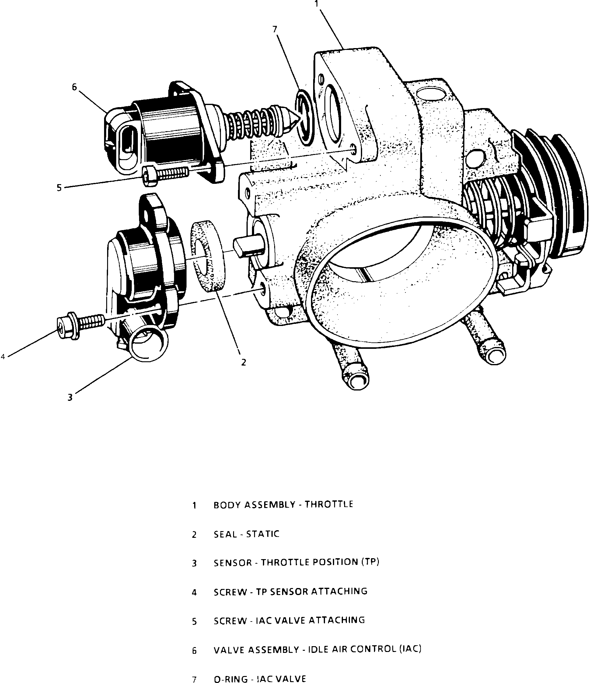

When I start the car it does not idle high because the car is cold as it should but when it warms up it idles high. Then I will cut it off and try to start it up it will not turn back on until it cools down.
Oct 7, 2018 at 4:13 PM
  • 110,240 POSTS
This could be the result of a few things. However, I first recommend checking the idle air control (IAC) valve. This component is responsible for maintaining engine idle speed.
Here is a link that shows in general how one is checked and replaced:
https://www.2carpros.com/articles/how-to-replace-an-idle-speed-control-motor-iac
Here is a link that discusses high idle issues, how to diagnose them, and how to repair:
https://www.2carpros.com/articles/engine-idles-too-high
Please keep in mind, there are other things which can cause this type of issue. A bad crank sensor can prevent starting when hot, an engine vacuum leak can play havoc on the idle speed, the engine coolant temperature sensor (ect) can also cause starting and idle issues. However, the first plan of attach should be the IAC.
Picture 1 is of the component. Picture 2 is how it functions. Picture 3 shows its location on the throttle body.
Here are the directions specific to your vehicle for replacement if you find it is bad. Also, when you remove it to check its function, make sure there isn't a carbon build up on the valve as well as in the throttle body where it mounts.

CAUTION: If installing a NEW IAC valve, be sure to replace with an identical part. IAC valve pintle shape and diameter are designed for the specific application.
Measure (only if Installing a New IAC Valve)
Distance between tip of IAC valve pintle and mounting flange (see image).
- If greater than 28 mm, use finger pressure to slowly retract the pintle. The force required to retract the pintle of a new valve will not cause damage to the valve.

As I mentioned, check this first. Also, if the check engine light remains on with the engine, have the computer scanned to determine what diagnostic trouble codes are stored. Most parts stores will scan it for free.
