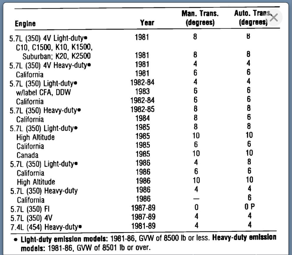

Hey all, question about my truck idling high. Stock Rochester 4BBL carburetor, which has been rebuilt. Truck starts right up and runs great. However, it seems to idle at a high RPM, and stays there. I don't have a tachometer in the gauges, so I'm not sure what number it runs at, but it does seem high to me. After startup I can hear when the engine warms up and 'levels out', but the RPMs do not slow down. Any thoughts on this?
Nov 21, 2021 at 6:36 AM

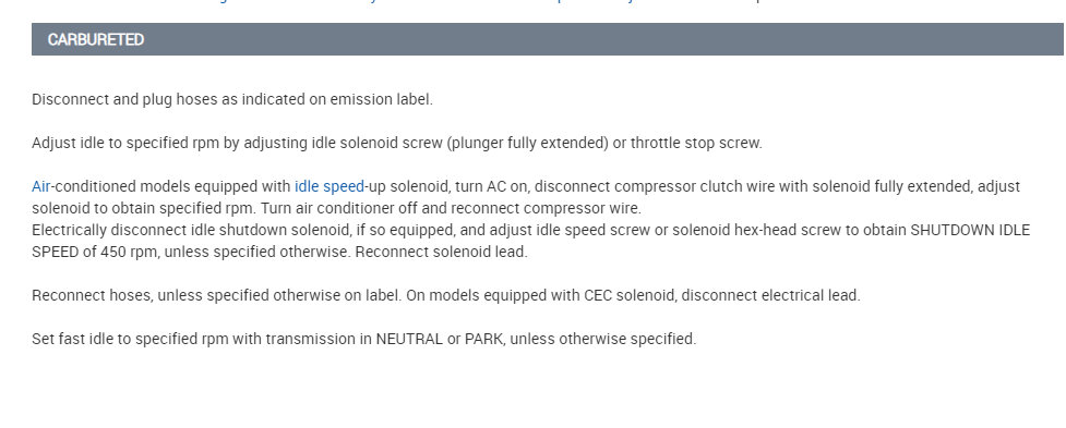

The most likely cause of this on a carburetor vehicle is the carburetor itself.
When this was rebuilt did you have it tuned or did you tune it so that you can set the idle and fuel mixture?
However, if it was then we can simply adjust it a little more the drop the idle until it is running slower and smooth.
First and foremost, you need to check and set the timing.
Based on the chart attached, you need to be around 4 degrees before TDC. If not, let's start with setting the timing correctly and then use the info attached below for adjusting the carb to see if you can lower the idle.
Please let us know what questions you have on this, and we can go from there.

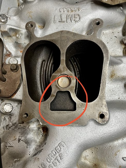

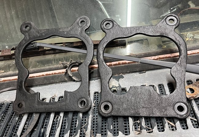

Thank you! I will try re-timing it this weekend and let you know how it goes. Can you tell me the purpose of this depression in the intake manifold, as it relates to the carb? I have 2 gaskets that came with my rebuild kit, one covers that depression, one does not. Which one is needed?
Nov 24, 2021 at 3:32 AM
The Quadrajet was used for many years. I think that cut out was started in the early 1970s.
It is to cut down heat-soaked components that will cause fuel boiling.
Plus, I am not positive, but it also helps with airflow balance between the bores.

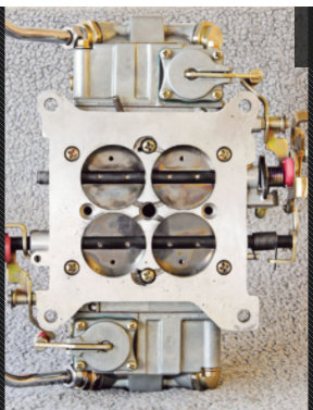

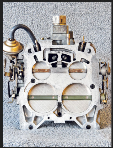

Your carb should look like the first picture below and use the one with the cut out in the mounting gasket. They provide both just in case you have the older style carburetors.
Nov 24, 2021 at 5:50 AM
TWEBB101
  • 183 POSTS
Okay, thanks. Are those gaskets re-usable? Everything I find online shows me the gasket that has the tab in place (right-hand gasket in my picture).
Nov 24, 2021 at 6:01 AM
They look like they are composite gaskets, meaning they are not paper or cork, so they are reusable as long as there is no damage on the mating surfaces.

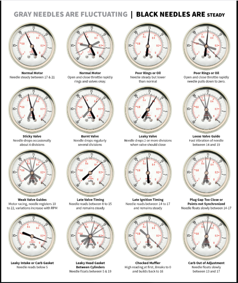

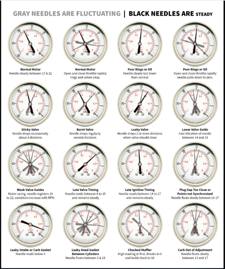

Yes, when the line is reinstalled, the RPM will adjust slightly based on engine vacuum. If it is unstable then we need "t" in a vacuum gauge to the line so that we can monitor the engine vacuum.
However, if it is running properly and smooth then I would not worry about it. If you want to check your vacuum, then hook in the gauge and look at the page attached.
You should have a steady needle when the engine is idling and then when you spike the throttle, it will drop and then start to level back out when it comes back to idle.

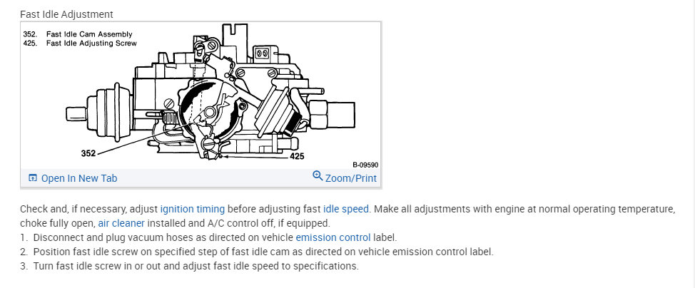

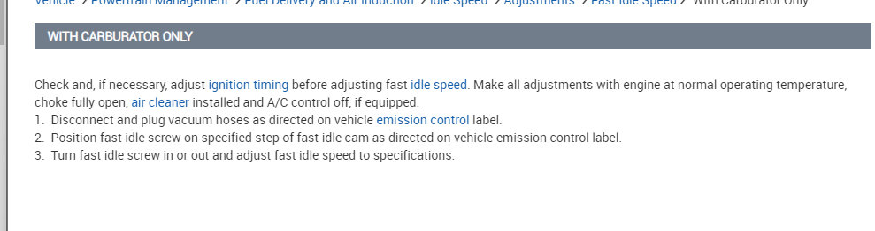

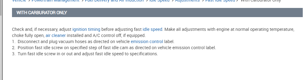

I think I’ve got the timing set right now, question on the function of the high idle cam. I understand the steps, and that it idles down as the choke warms up and opens. My question is: is the fast idle cam supposed to drop all the way down to low/curb idle on its own, or as the truck is driven? Right now, as the choke warms up, I have to tap the fuel just a bit and the cam will drop. Is that factory design/operation? Or is something not right?
Dec 26, 2021 at 4:17 AM
Yes. That is by design. When the engine completely cools down that cam will reset.
Then when you tap the throttle, it will drop the idle speed, but it holds it higher like this because we want to warm the engine as fast as possible. We need to warm the engine ASAP so that everything runs efficiently, and the metal components turn better when they are at the higher temperature. There is more damage done to the engine before it is warmed up than any other time.
So, keeping the idle higher until it warms up gets the engine hotter quicker. So that cam will keep the engine at a higher idle until you get in it and start driving it.
