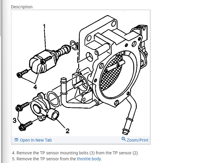

It is interesting that after you replace something that it works properly.
That tells me that we may have a PCM issue. Basically, after you replace the part, the PCM needs to "learn" the part and that may take some time. However, this is not 4 days so let's test this to see if this is a software issue or not.
Can you do a battery disconnect and touch the cables together to see if afterwards the idle is operating normally?
Also, here is a guide that will help with high idle issues, but I am not sure this will address yours due to its operating normally for a short time.
https://www.2carpros.com/articles/engine-idles-too-high
This shows that the parts are able to function normally but clearly the PCM is most likely causing the idle to go high due to adding more fuel.
Also, when you say you replaced TP, was this the throttle body assembly or did you replace just the sensor?
Let's start with this info and go from there.
Thanks
Image (Click to make bigger)
