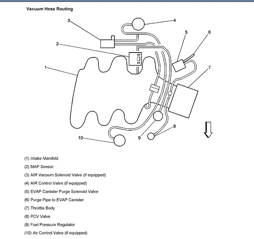

I start it drive 25 minutes to work and it's fine. After it sits all day it's fine.
If I go out and restart it before the engine completely cools down, it will idle way too high. Seems to be heat related. I replaced much of the cooling system last year (head and lower gaskets, radiator, water pump) as it ran hot... that problem solved now this high rpm. perhaps it's a vacuum leak? I might have put the hoses back on wrong after disassembly. Any ideas? hose diagram or photo of another 3.4 might help? thanks!

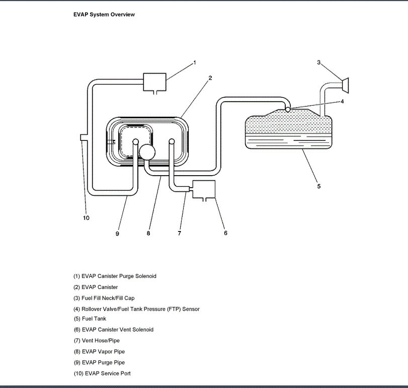

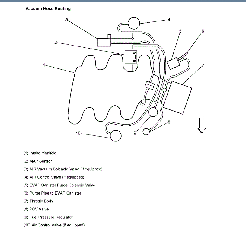

I attached two pics for you to review. They are the vacuum routing schematics. Let me know if they help. Also, here is a link that explains how to check for a vacuum leak:
Let me know what you find.
