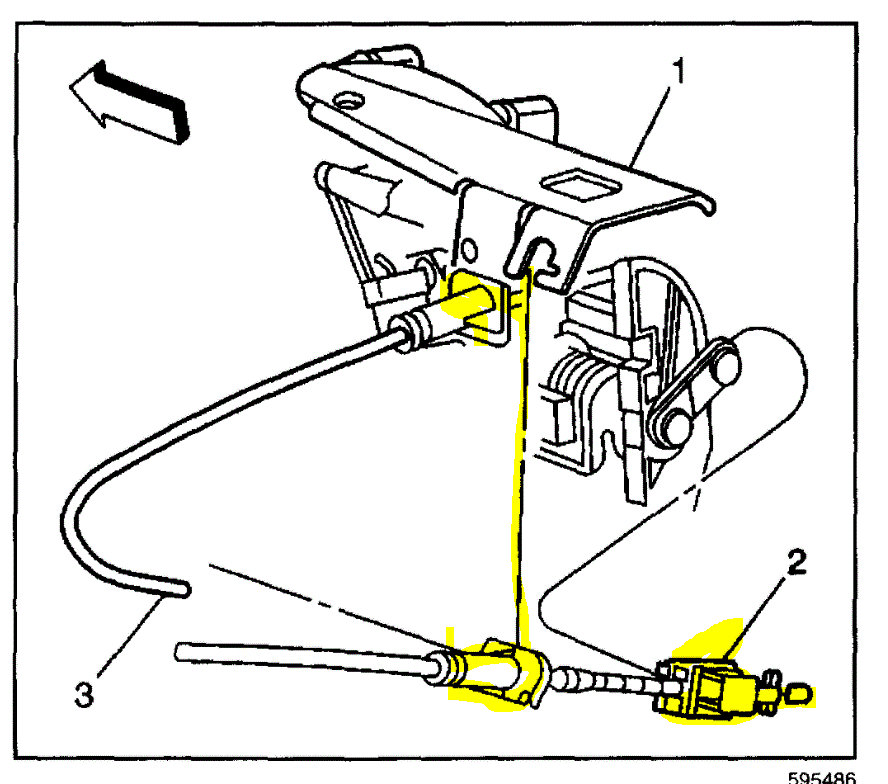

Since the vehicle has a throttle cable, check to make sure it isn't frayed at any point, confirm it is properly attached at the pedal and throttle body, and make sure none of the mounts are loose.
Let me know what you find.
