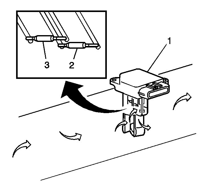

Mass Air Flow (MAF) Sensor
1 - Mass Air Flow (MAF) Sensor
2 - Platinum Hot-Wire Element
3 - Intake Air Temperature (IAT) Sensor Thermistor
The mass air flow (MAF) sensor (1) measures the changes in the intake air volume that result from the changes in throttle opening and the air density. The airflow measurements are used by the PCM in order to determine the engine fueling requirements.
The MAF sensor is a hot-wire design. A platinum hot-wire (2) and a thermistor (3) are located in the intake air bypass passage of the MAF sensor housing. The temperature of the platinum hot-wire is affected by exposure to air flow and by exposure to air temperature. The platinum hot-wire is maintained at a set temperature by controlling the current flow through the wire. The MAF sensor converts the changes in current flow to a voltage signal. The voltage signal from the MAF sensor enables the PCM to detect changes in the air density and changes in air volume.
The MAF sensor also contains the IAT sensor. The IAT sensor cannot be serviced separately from the MAF sensor.

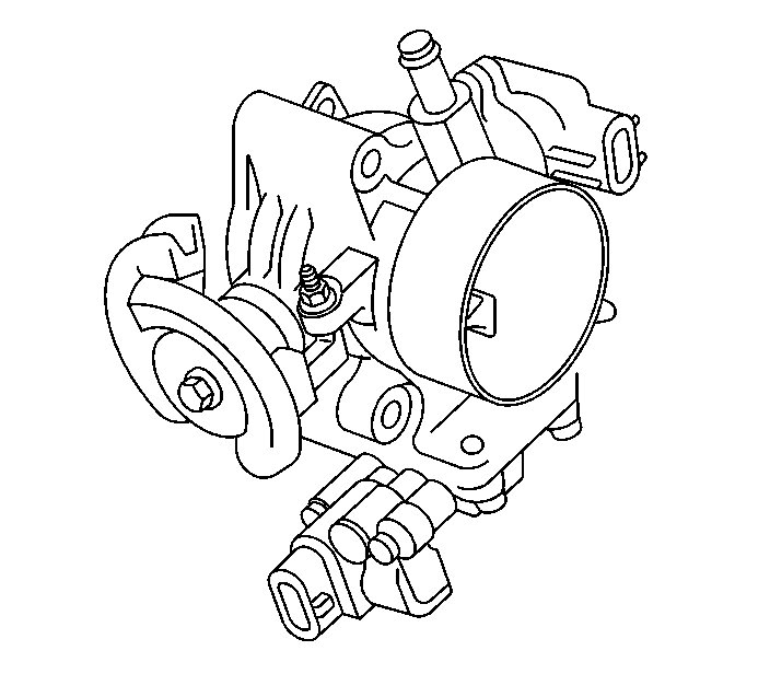

Throttle Body Assembly
The throttle body contains a throttle valve that controls the amount of air entering the engine. The throttle position (TP) sensor and the idle air control (IAC) valve are both attached to the throttle body. The throttle body has an engine coolant passage that provides warming of the throttle body housing and prevents icing.
The throttle body contains vacuum ports that are located above and below the throttle valve. These vacuum ports provide the vacuum signals used by various components.

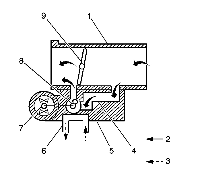

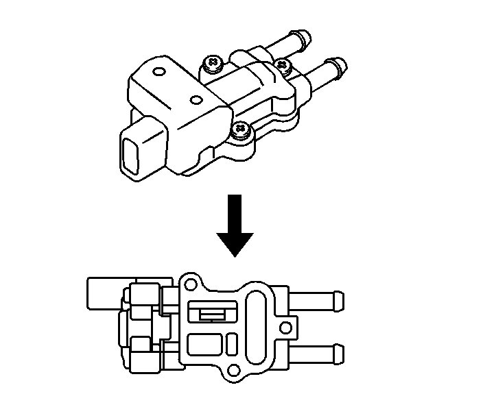

Idle Air Control (IAC) Valve
The idle air control (IAC) valve is attached to the underside of the throttle body with 4 bolts. The IAC valve enables the powertrain control module (PCM) to easily control the engine idle speed by precisely metering the engines air intake at closed throttle. The IAC valve opens and closes the idle air bypass passage according to signals from the PCM. The IAC valve contains an engine coolant passage that enables the IAC valve to operate more efficiently at cold temperatures. The PCM determines the correct engine idle speed by using input from various sensors and switches in order to assess the engine status and requirements.
Operation
imageZoom/Print
1 - Throttle Body
2 - Air
3 - Coolant
4 - Idle Air (Bypass) Passage
5 - IAC Valve
6 - Coolant Passage
7 - Magnet
8 - Rotary Valve
9 - Throttle Valve
The PCM uses the IAC valve in order to control the engine idle speed. The PCM communicates with the IAC valve by varying the ON time of a repeating ON/OFF duty cycle. A magnet inside the IAC valve operates a rotary valve that controls the opening of the idle air bypass passage in the throttle body. The idle air passage allows air to enter the engine without passing over the throttle valve. The strength of the magnet in the IAC valve is related to the current flow in the IAC circuit.
The PCM increases the ON time of the IAC valve command in order to increase the idle air passage opening. A larger idle air passage opening allows more air to enter the intake resulting in an increase in engine speed.
The IAC valve contains an engine coolant passage that enables the IAC valve to operate more efficiently at cold temperatures. The IAC valve enables the PCM to easily control engine idle speed by precisely metering the engine's air intake at closed throttle.

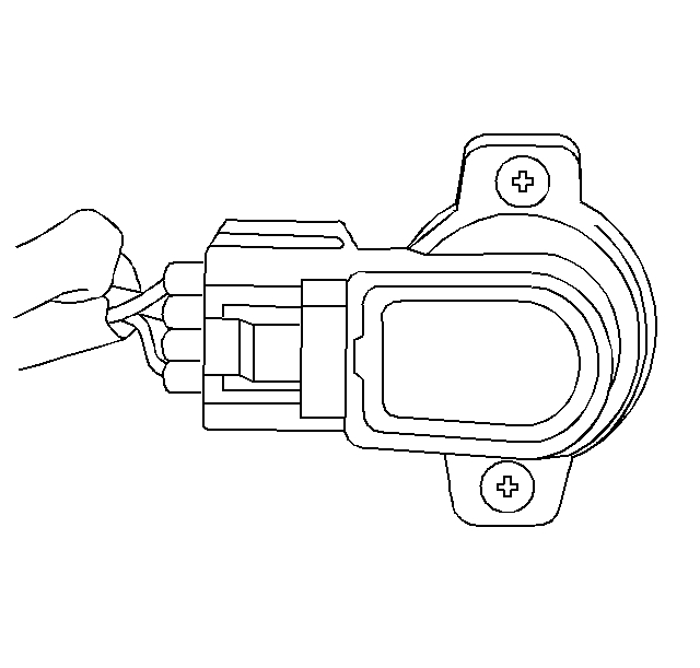

Throttle Position (TP) Sensor
The throttle position (TP) sensor is a potentiometer connected to the throttle shaft on the throttle body. By monitoring the voltage on the signal line, the powertrain control module (PCM) calculates the throttle position. As the throttle valve angle changes when the accelerator pedal is moved, the TP sensor signal also changes. At a closed throttle position, the output of the TP sensor is low. As the throttle valve opens, the output increases so that at wide open throttle, the output voltage should be more than 3.3 volts.
Because the position of the throttle valve controls the air supply to the engine, the PCM can modify the fuel delivery based on the throttle angle. For example, power enrichment occurs when the throttle angle approaches wide-open throttle. The PCM looks primarily for changes in the TP sensor output to control fuel delivery. Acceleration enrichment occurs when the throttle angle increases, similar to the accelerator pump on a carburetor equipped vehicle.
