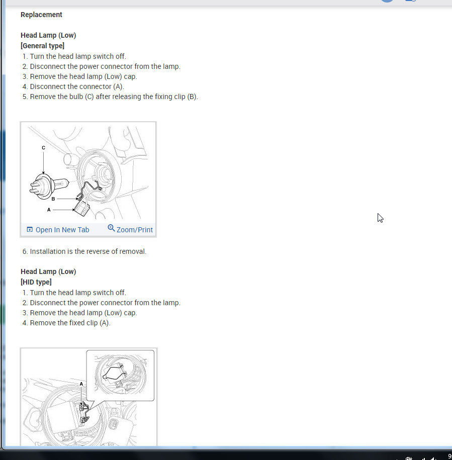

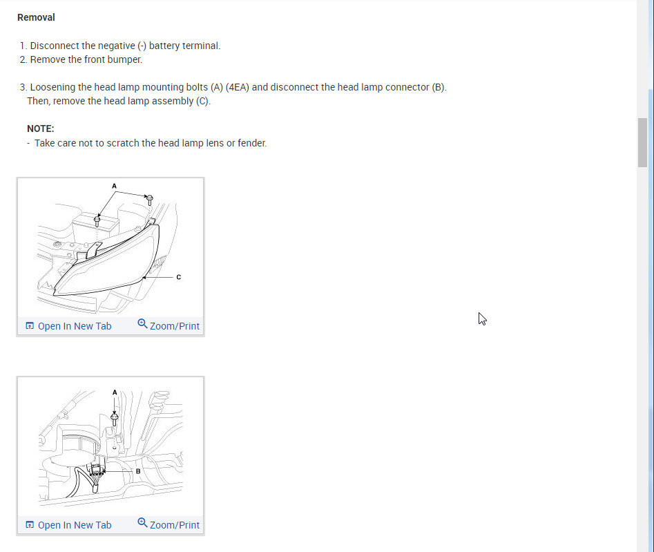

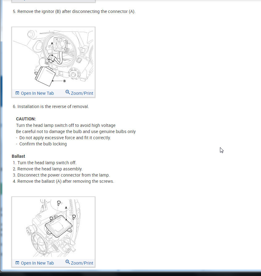

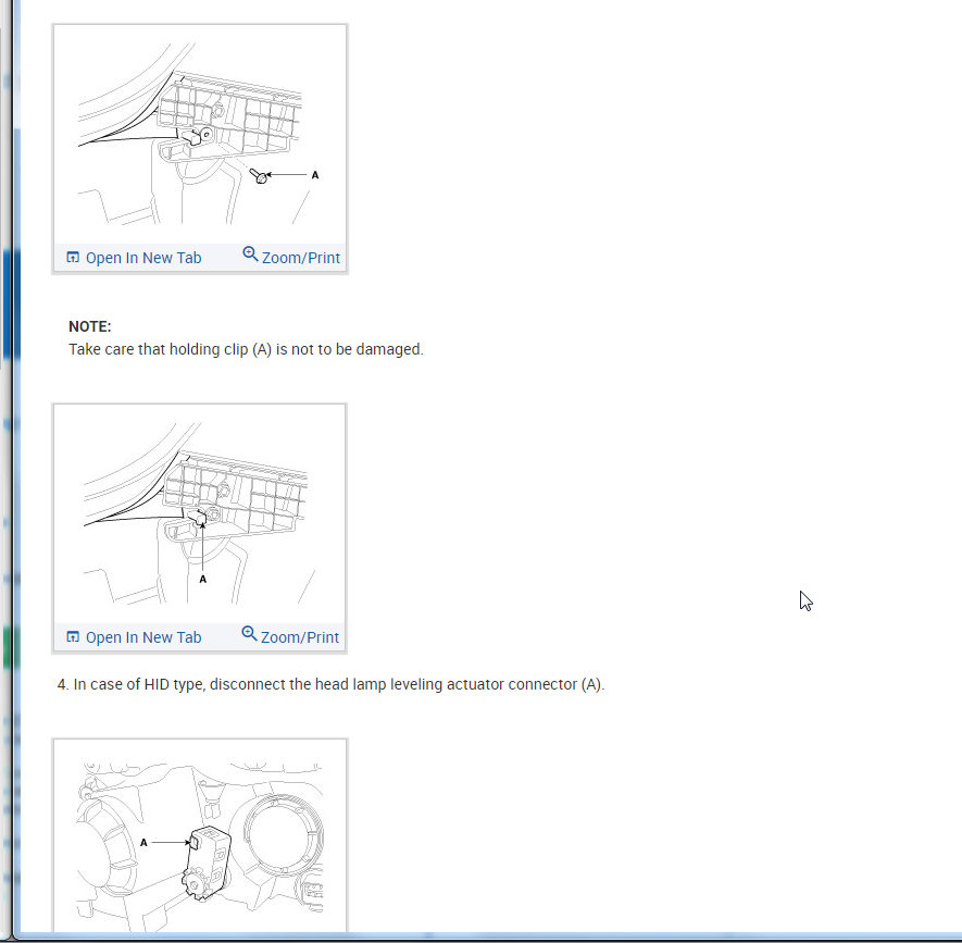

I know about the retaining clip, but I'm wondering how you remove the complete headlight assembly to access the back of the low beam. There are two screws on top and one screw down beneath is that it? I tried to pull the assembly out it seems like it's still locked in there with something holding it. I would have the rest of the information but this is not my vehicle. Any help you could be would be appreciated.
Jan 2, 2021 at 9:20 AM
Are you removing the front bumper? I suspect there is a clip or screw at the bottom that you are missing. Take a look at the directions from the manual and let us know if you have other questions. Thanks
