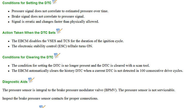

My wife's 2007 Pontiac Torrent 3.4L FWD, started having what felt like brake problems were the pedal would get hard and felt like brakes were being applied. The service Stabilatrac text came on the dash. she took it to a service station and they got the code C0131. Any suggestions on where to start or what to check first.

if the ebrakes were in pieces it was probably left on at some point. the code is a brake pressure sensor in abs unit which is not serviceable. the fix is brake module replacement meaning your abs unit

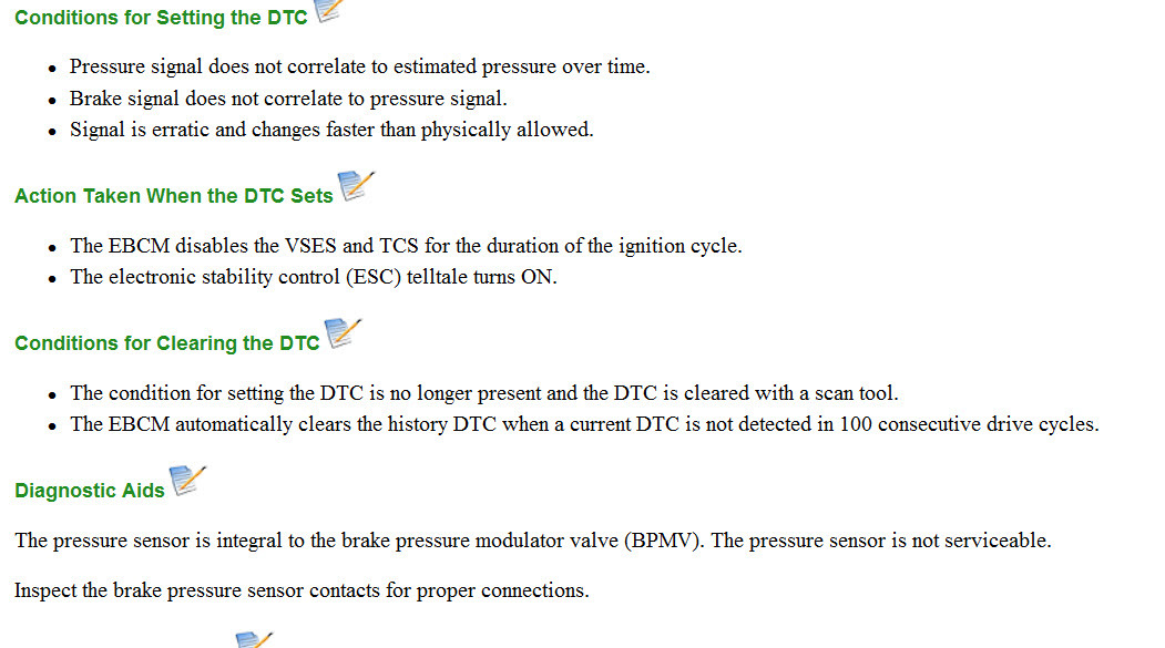

sorry looks like I led you down' the wrong path , I didn't look at the original code that you got. pic show how to service it but it looks like it's gonna have to replace abs unit. the other codes will set due to abs problem.

Ok, but if the caliper and hose were bad, causing an erratic signal to the EBCM could it have caused the DTC to set. If so would it need to be cleared in order to reset the ECBM and the condition to be fixed? I cannot find anything on this I was up most of the night reading about it, but nothing concerning the failure of a caliper or hose possibly causing the DTC to set. My biggest concern is that if I replace the ECBM it not be the cause and that about $350 from Dealer. A family friend who's also a mechanic asked his Brake Guy about it and said it could be the Master Cylinder.

no because it is one oth e main components of the abs unit itself, it is not serviceable so the whole unit needs to be rebuilt. they areavailabe for around $150 I think rebuilt but your unit has to come off.
