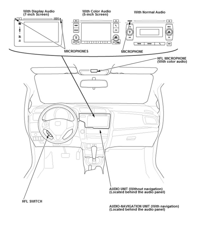

The car listed above is an LX model, 6-speed manual transmission. In the 2015 it was directly behind the glove box. Cannot seem to locate this one and need to unplug it for medical reasons. Honda Service charges $169.00 for this.

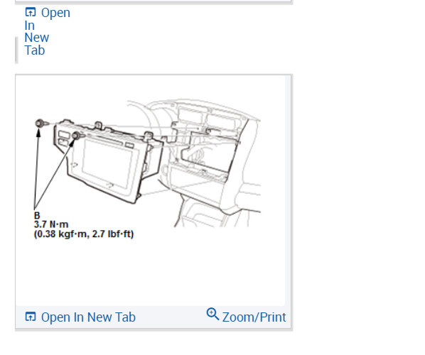

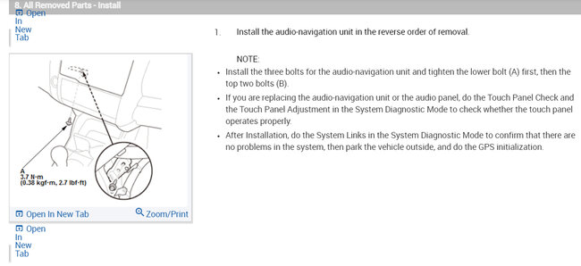

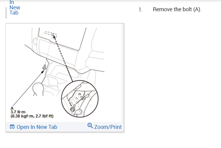

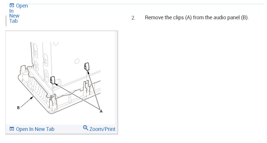

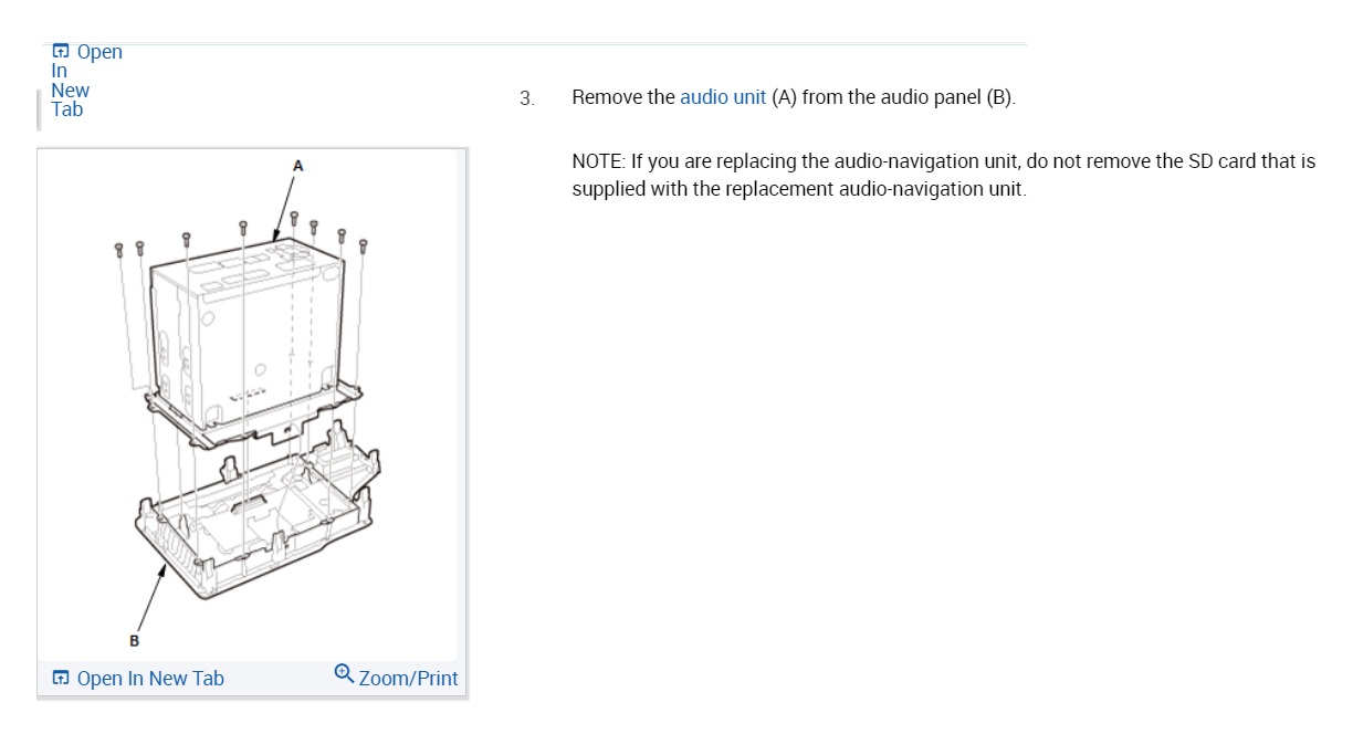

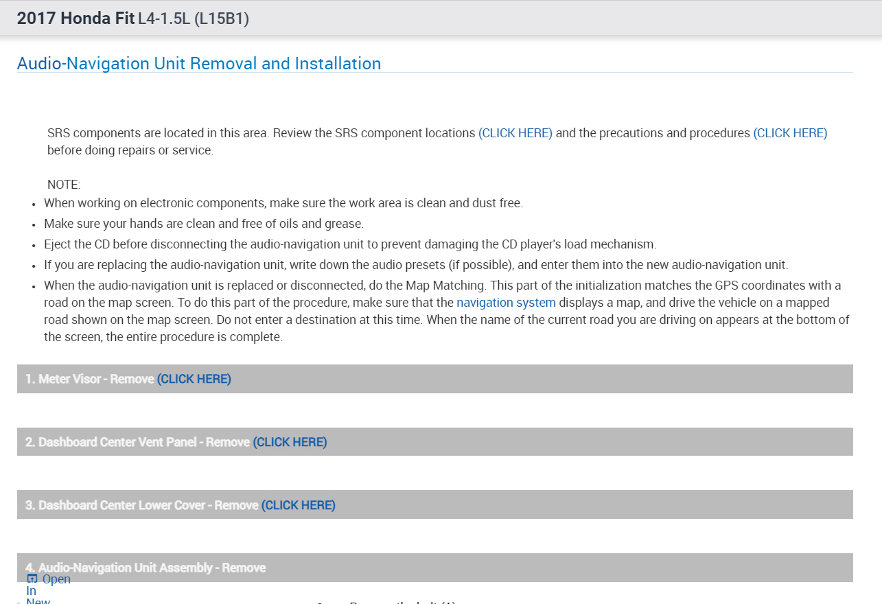

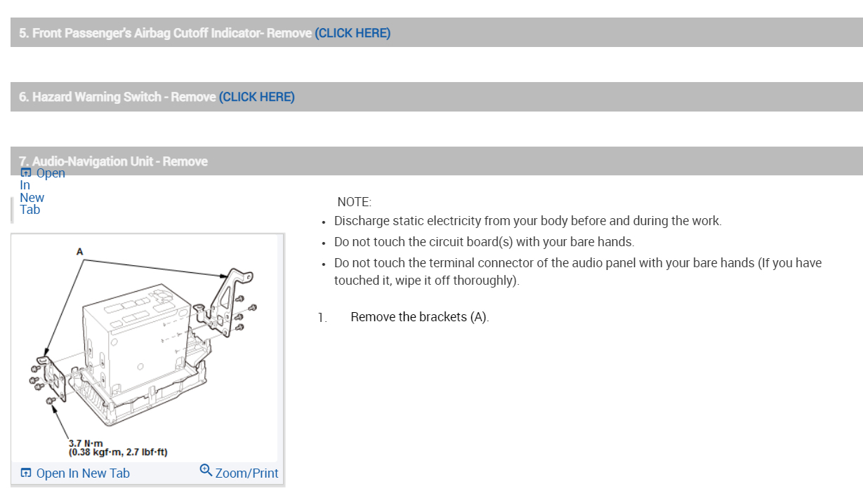

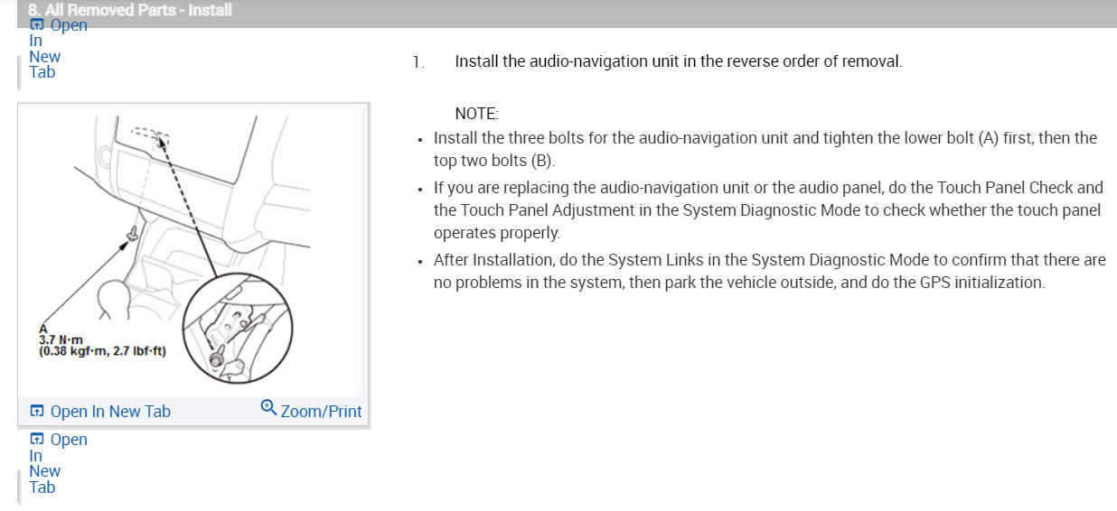

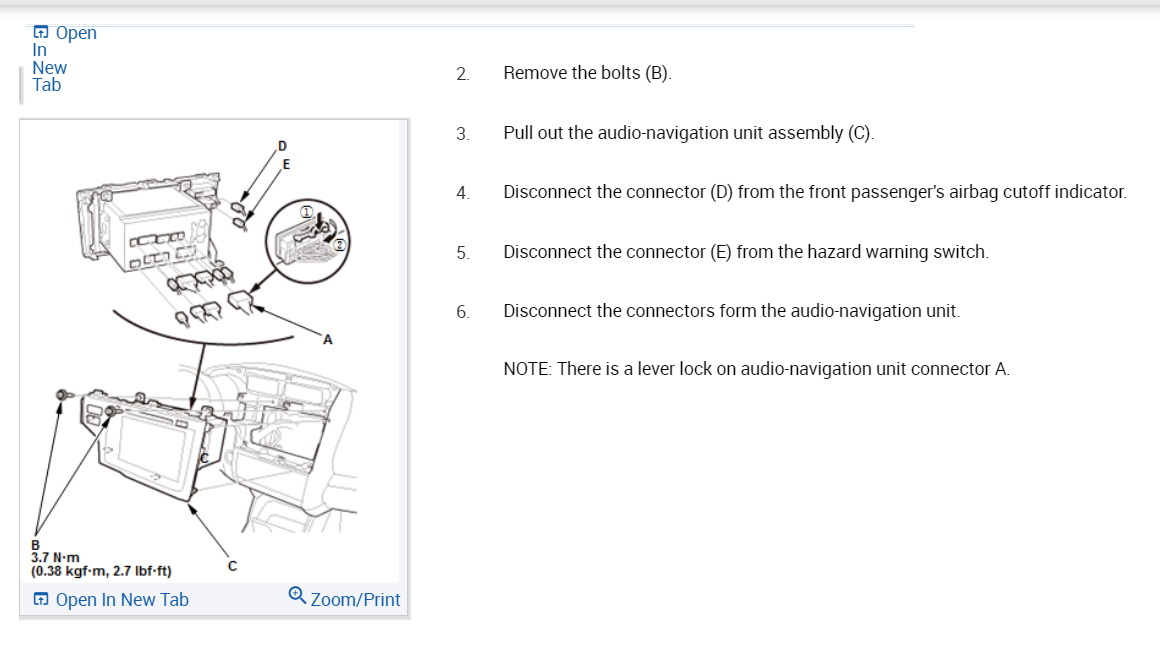

it looks like it is behind the radio head unit or interrogated into it. Check out the images (below). Please let us know what happens.

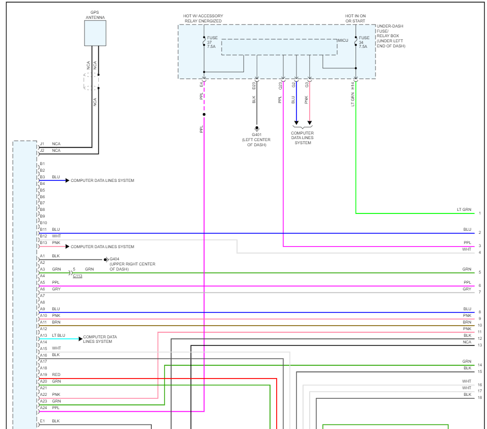

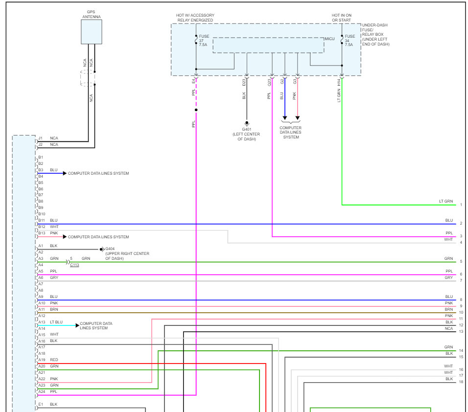

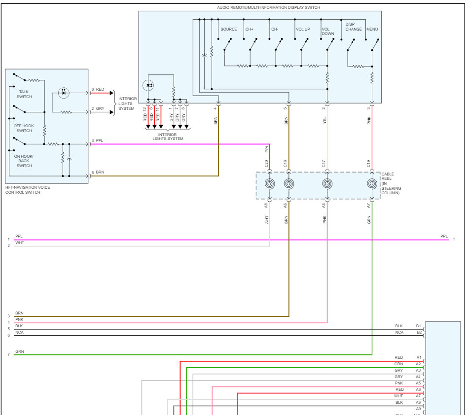

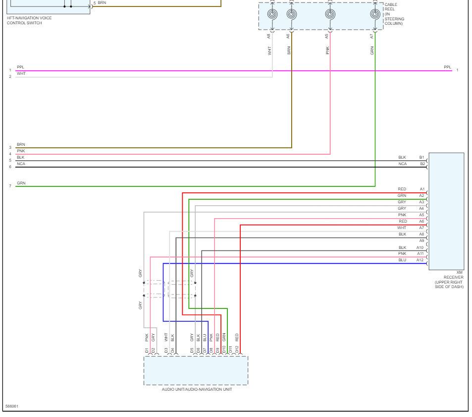

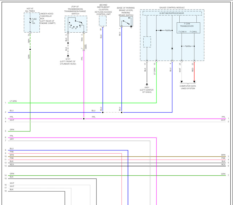

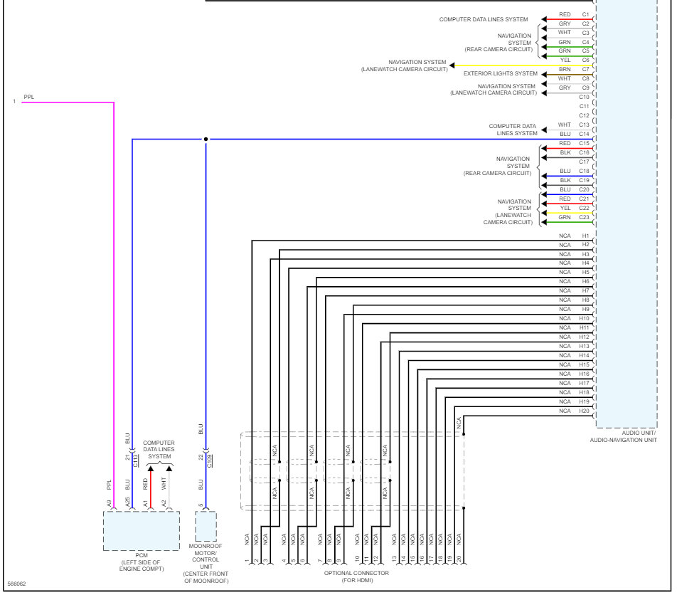

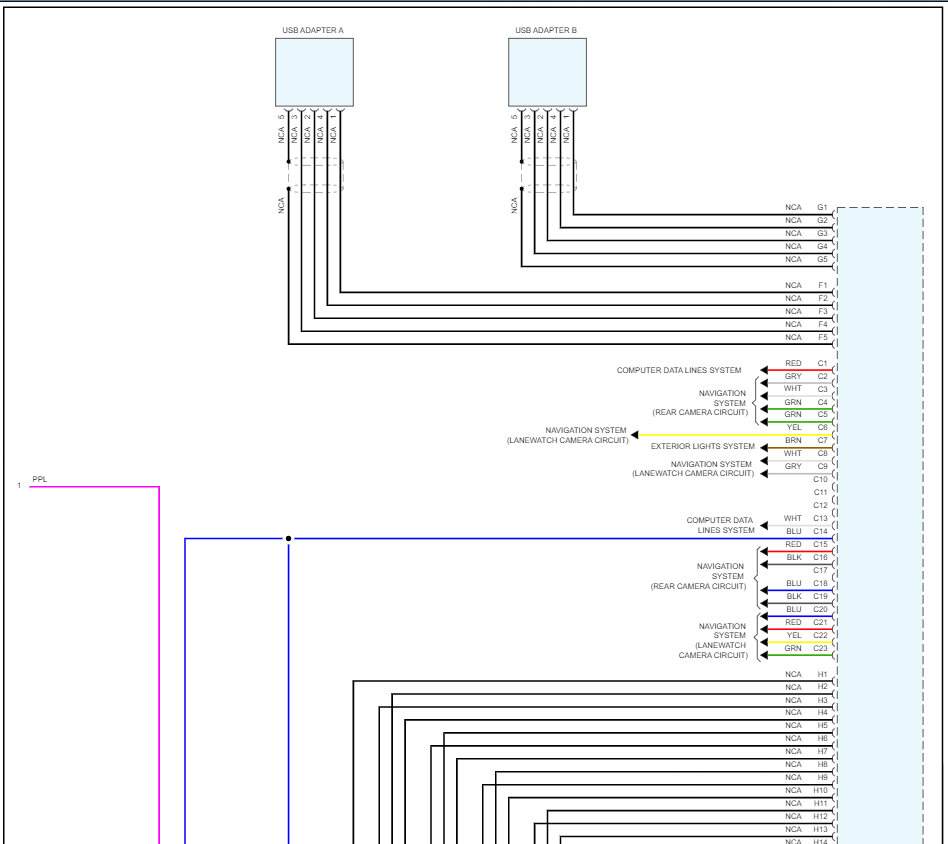

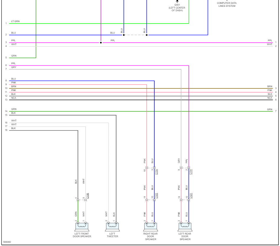

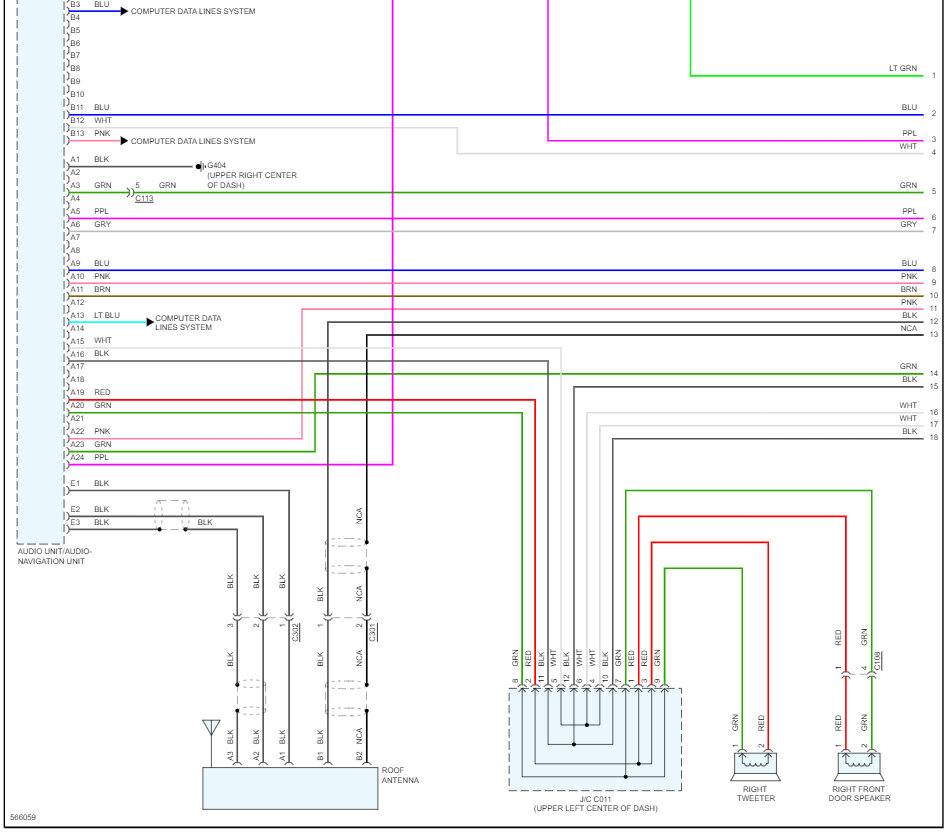

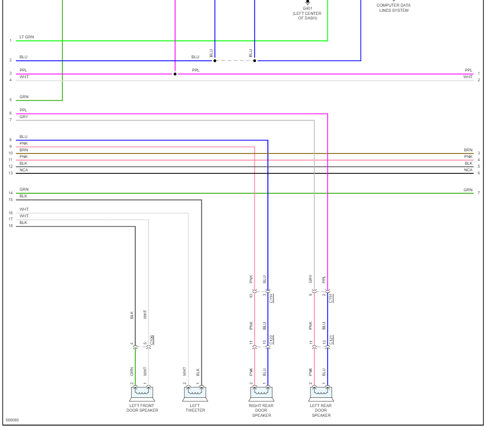

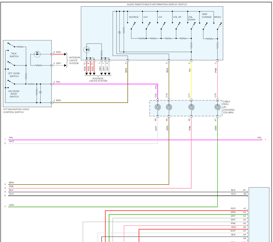

Here is information on the Bluetooth and I have included the radio and HFL wiring diagrams so you can see how the system works.

HandsFreeLink Control Unit
The audio unit or the audio-navigation unit builds in the HFL circuit, HFL microphone *1, and the Bluetooth transceiver. The HFL switch *2 controls the HFL function using the hard wire.
*1: With display audio or normal audio
*2: With display audio or color audio
General Operation
The HFL switch on the steering wheel is used to answer incoming calls, to make outgoing calls, or to end a call. The signal is sent to the audio unit or the audio-navigation unit.
The microphone picks up the driver's voice, and sends the signal to the audio unit or the audio-navigation unit. The signal is then sent from the Bluetooth transceiver to the cell phone.
The caller's voice signal is sent from the cell phone to the Bluetooth transceiver. The audio unit or the audio-navigation unit outputs the voice signal through the front door speakers.

Thank you for the information and your reply. I took the car into the Honda Service for unplugging of the Bluetooth Module which they assured me could be done for $169 before I purchased the car. Turns out it cannot be done by them and is built into the head unit in this model. So, I have been keeping the radio turned off, and without music to avoid cancer pain caused by the wireless.
