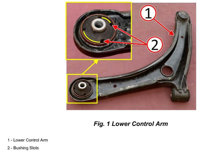

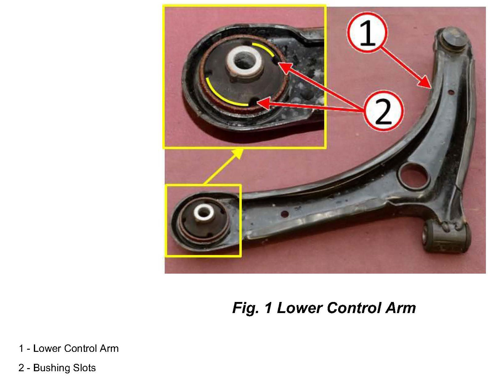

2.Remove both front lower control arms (1) (Fig. 1). Refer to the detailed service procedures available in DealerCONNECT> TechCONNECT under: Service Info> 02 - Front Suspension> Front> ARM, Lower Control> Removal.
3.Area of bushing squeak concern (2) is identified in (Fig. 1).

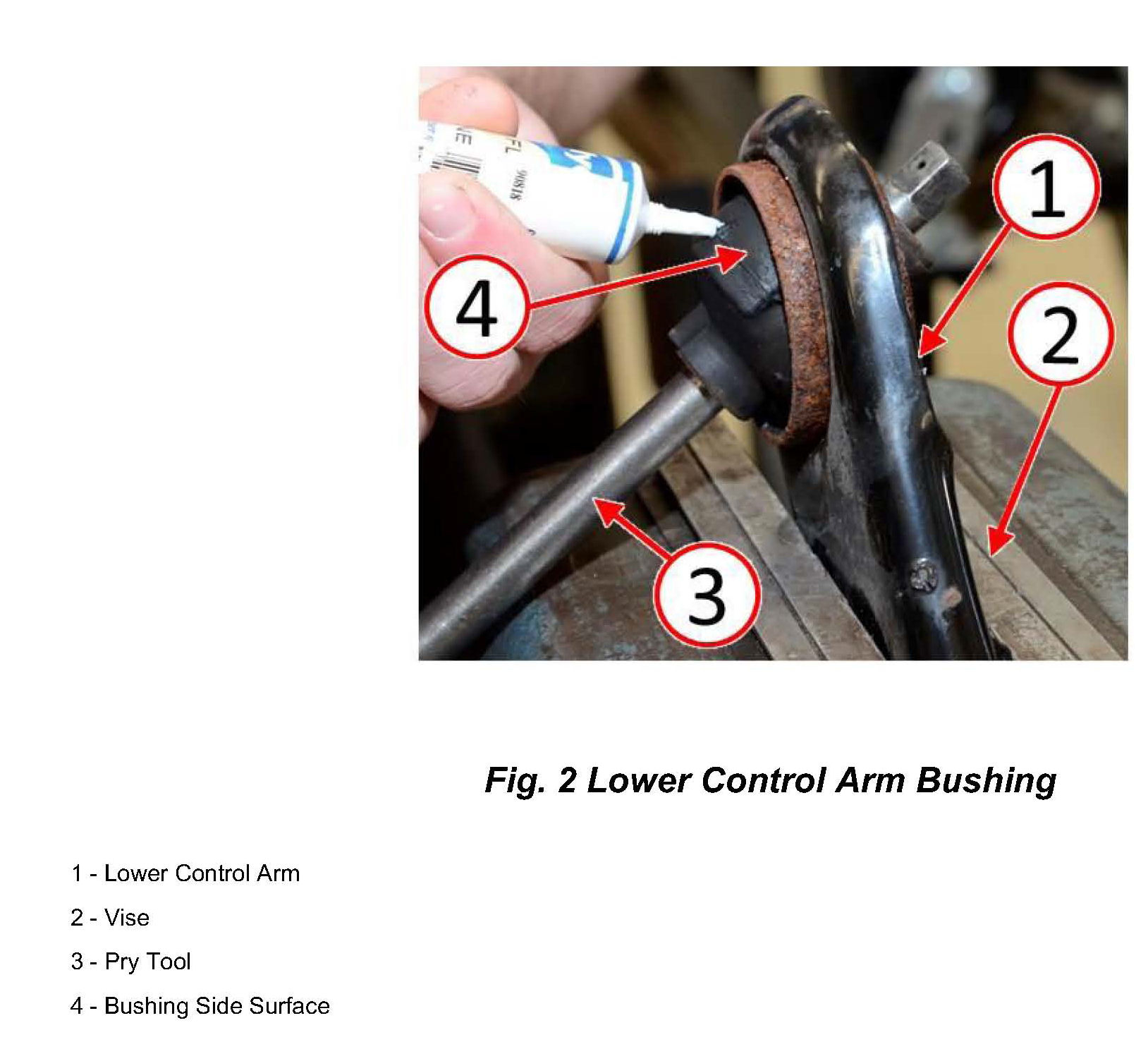

4.Clamp the lower control arm (1) securely in a vise (2) with bushing accessible (Fig. 2).
5.Using an appropriate tool (3), insert tool through the bushing sleeve, then rotate the bushing to expose the sides of the bushing (4) for Nye lubricant application (Fig. 2).

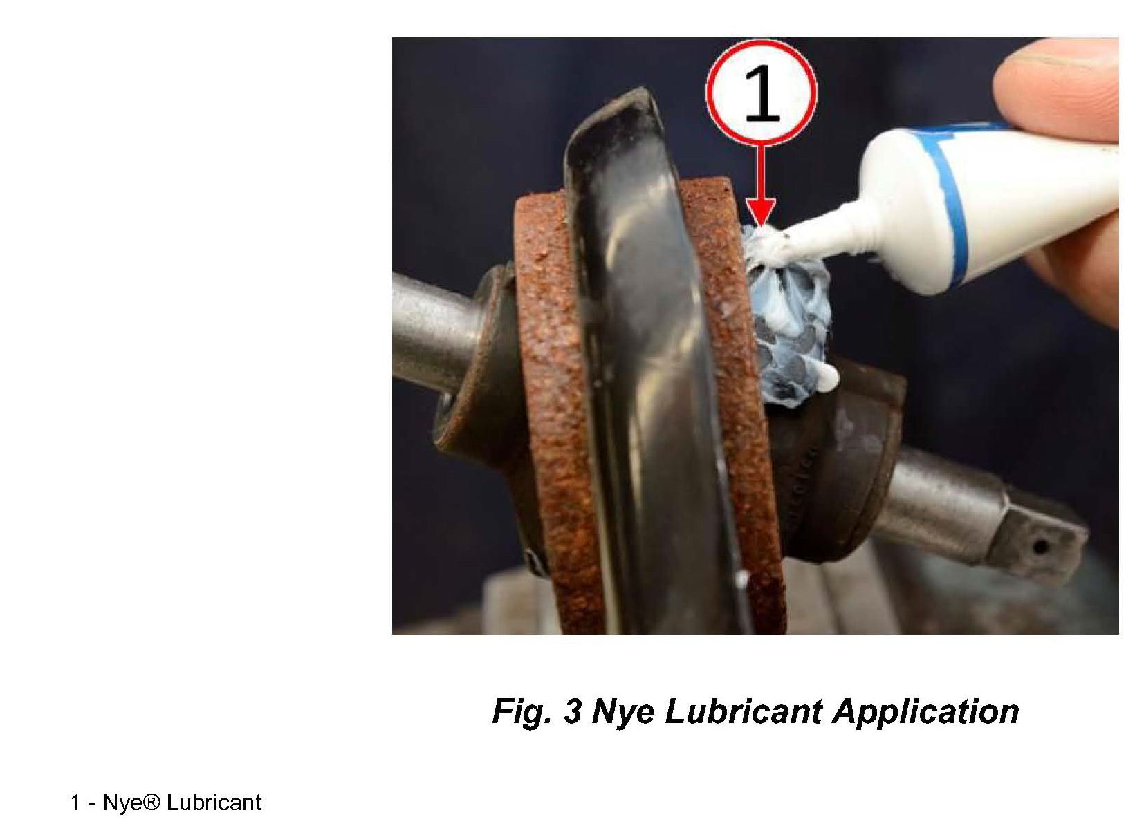

6.Apply Nye lubricant liberally to bushing sides where internal bushing contact is made (Fig. 3).
pic 4

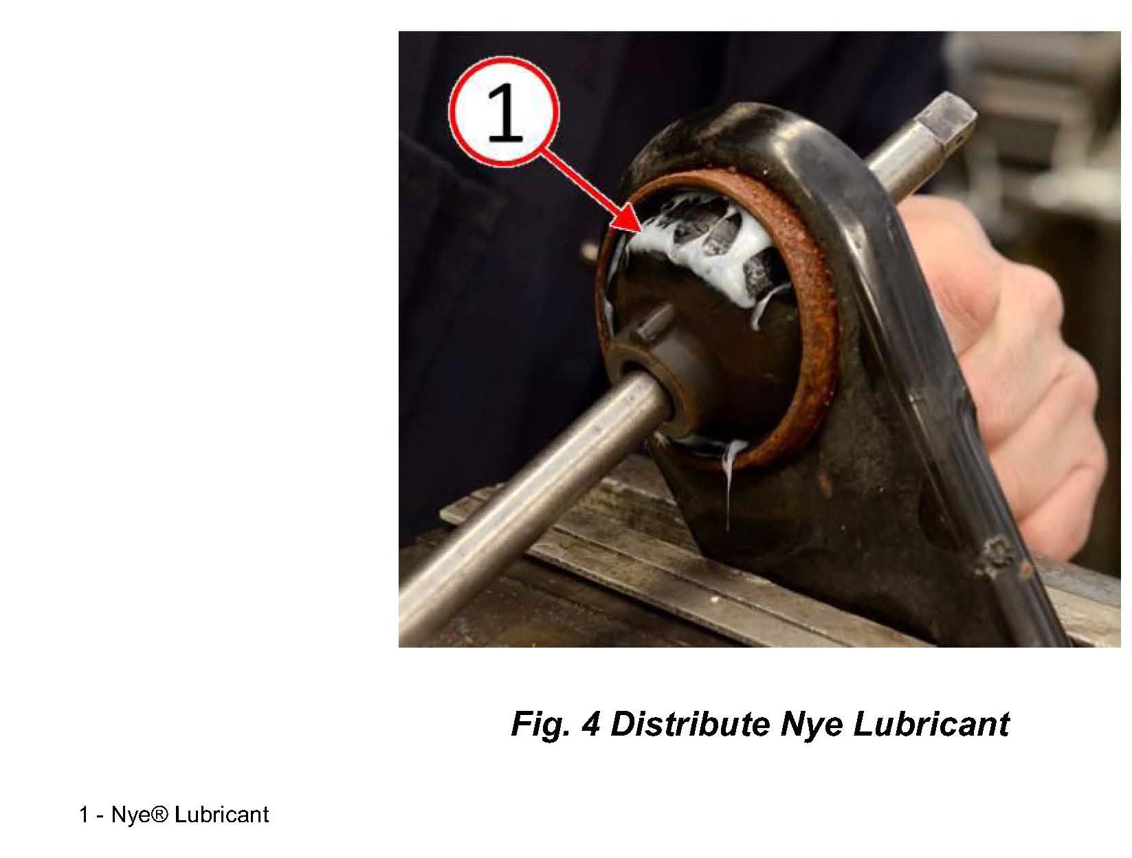

7.Move the bushing through range of motion in order to distribute Nye lubricant (Fig. 4).
pic 5

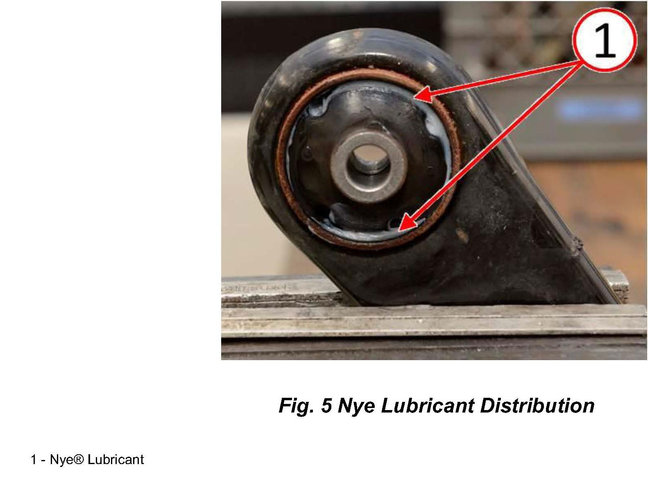

8.Inspect that Nye Lubricant is evenly distributed within the bushing slots (Fig. 5)
