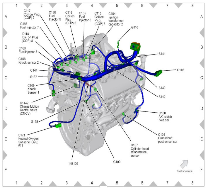

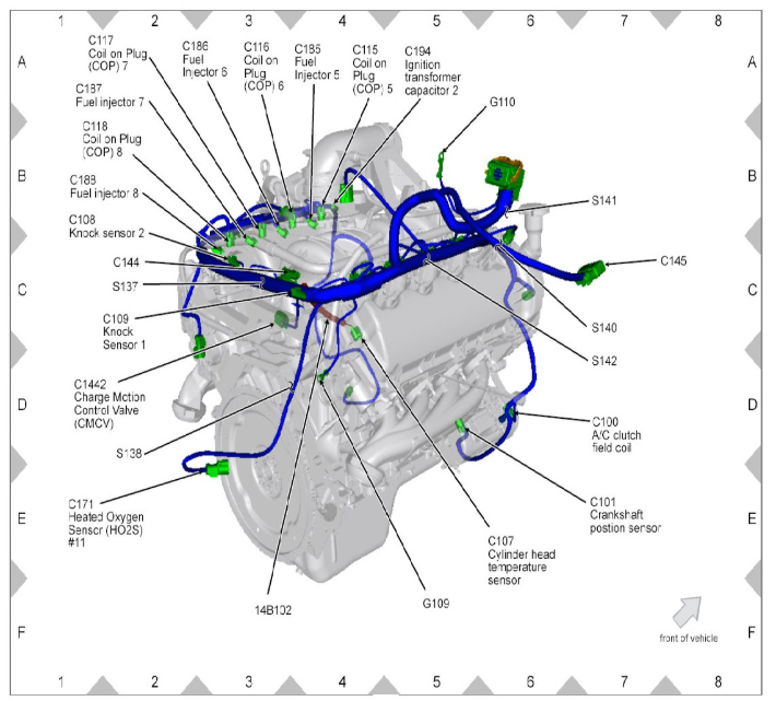

I have seen engine coolant temperature sensors do this they can get super heating and short out then cool slightly and start working again. This issue does not stay long enough to trigger a code but causes engine problems. Here is a guide to help you see what you are in for when changing the sensor out:
https://www.2carpros.com/articles/coolant-temperature-sensor-cts-replacement
