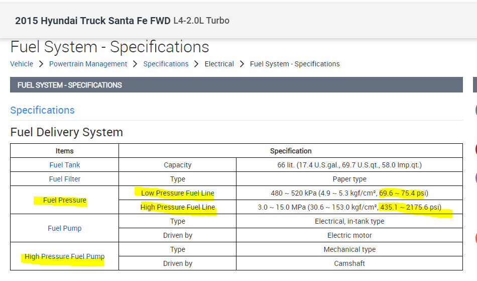

Was that an improvement or not? If it was, we need to do a leak down test on the fuel system. If it did improve, that tells me cycling the ignition on and off has allowed the pressure to build up again.
Take a look through this link. It explains how to test pressure and fuel pressure drop off.
Let me know if that is something you feel comfortable performing. You will need a fuel pressure gauge, but most parts stores will lend one to you. Also, note that this vehicle has two fuel pumps. One is located in the fuel tank and produced a lower pressure. It functions more as a lift pump to get the fuel moving.
Once it makes its way to the engine, it reaches a high-pressure fuel pump. That one will require a special gauge for testing, or it should be done using a scan tool that can communicate with the vehicle.

Yes, it is starting better. Haven't had any hesitation. I might be able to the leak test.
Sep 25, 2024 at 7:17 AM
  • 110,241 POSTS

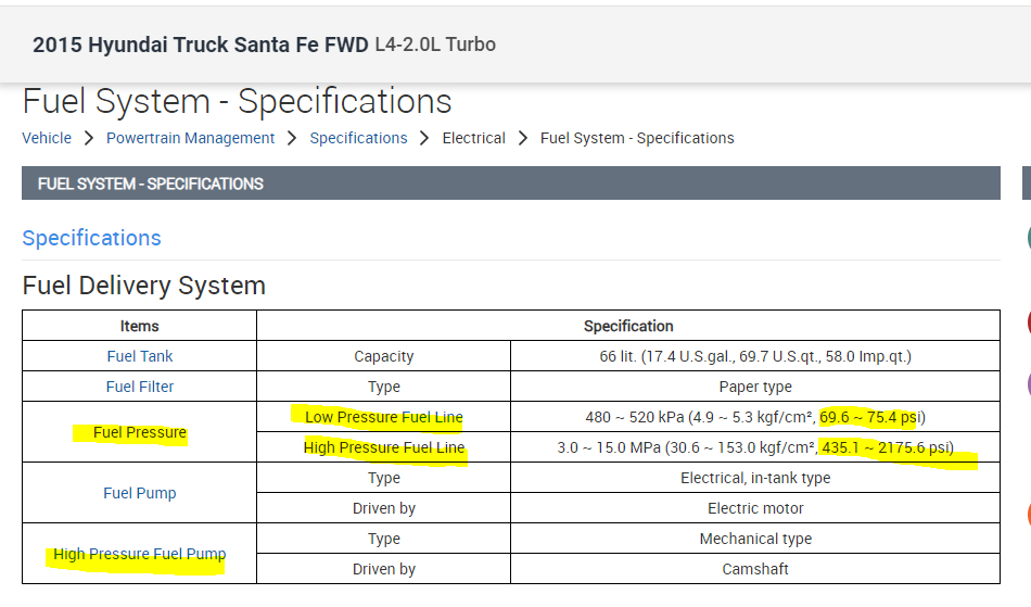

That is what I would recommend doing. See if the fuel pump is within the manufacturer's pressure specifications and if it drops pressure too quickly.
I attached the specifications below for you. Note the extreme pressure from the high-pressure pump. You can't use a traditional fuel pressure gauge with that. It should be done with a scan tool.
