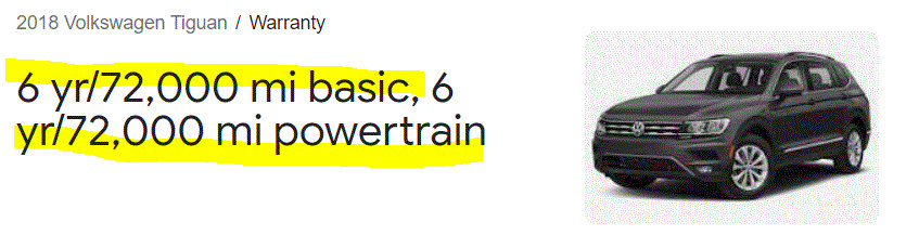

If we don't try to scan for codes, it will become a guessing game. Try to have that done and let me know the results (what codes were found). Also, please keep in mind the manufacturer's warranty. The powertrain is covered, so it may be a good idea to have a dealer inspect it. See attached pic.
