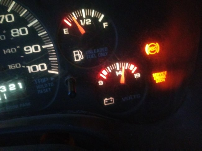

My vehicle listed above is chugging at low rpm and when driving at a constant speed. Also surging when stopped and in gear. Sometimes stalls at stop.
Mar 14, 2019 at 9:25 AM
MYVANISKILLINGME
Also seem to be over charging battery and the key is hot when i take it out of ignition.

If the system is over charging, that is a concern because not only can it cause damage to some components, but it can also cause a fire.
Now, the alternator output is regulated by a voltage regulator. When the engine is running, the voltage at the battery should be right around 14 volts. With that in mind, we really need to check if it is over charging.
Here is a link that describes and shows how to check the alternator on your vehicle. Please do this and let me know the results.

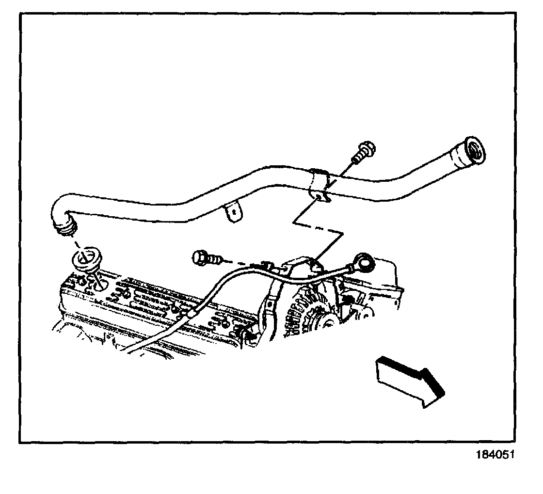

Here are the directions specific to your vehicle for alternator replacement. The attached pictures correlate with these directions. Make sure to disconnect the battery prior to starting this procedure. Always remove the negative terminal first and install it last.
_______________________________________________________________________
REMOVAL PROCEDURE
CAUTION: Refer to Battery Disconnect Caution in Service Precautions.
Pic 1
1. Disconnect the battery negative cable.
2. Remove the coolant reservoir.
3. Remove the air cleaner assembly.
4. Remove the upper fan shroud.
5. Remove the drive belt from the generator.
6. Remove the heater hose pipe from the generator.

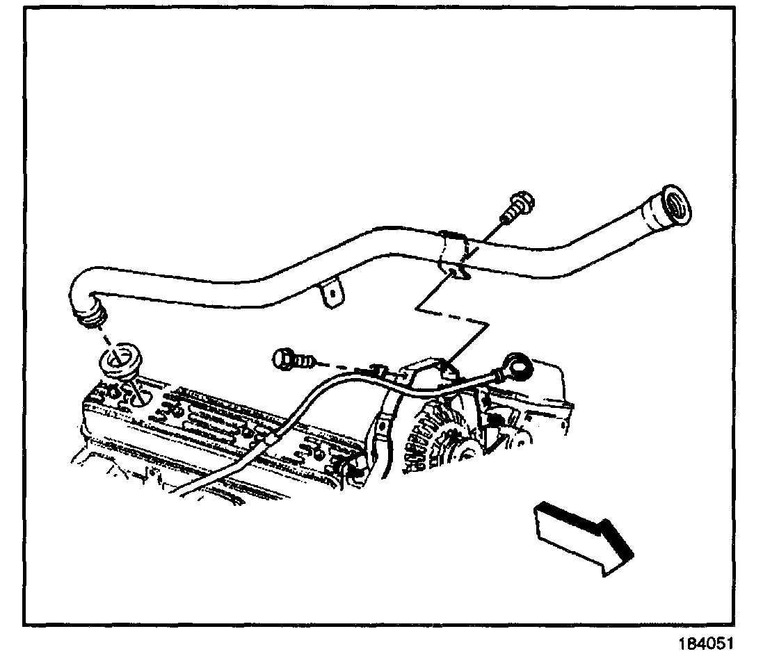

7. Remove the oil fill tubes from the support bracket.
Pic 2
8. Remove the support bracket from the generator bracket.
Pic 3

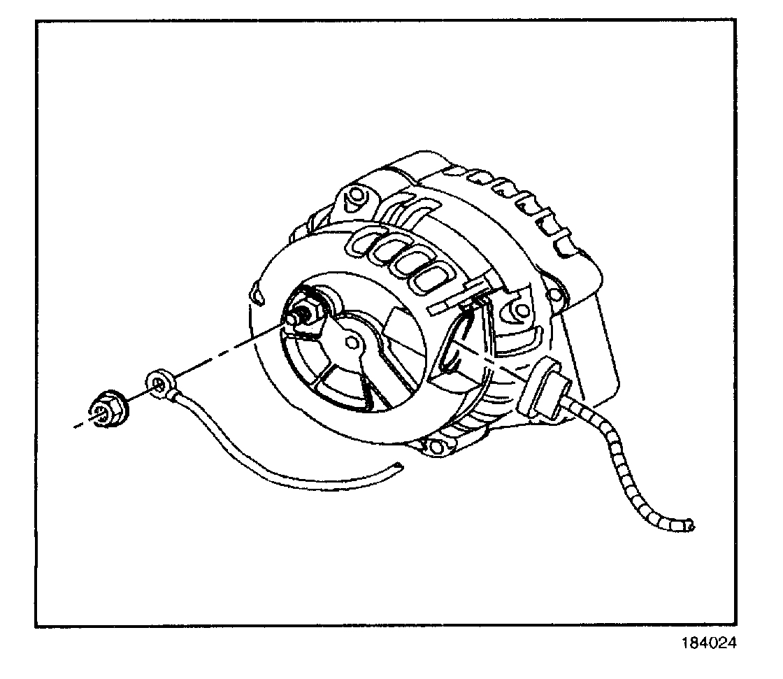

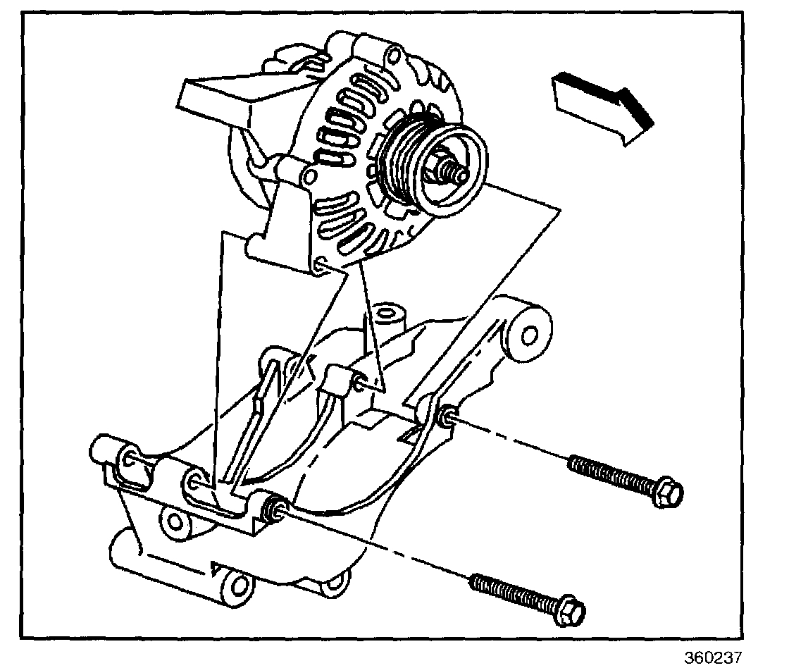

9. Remove the generator mounting bolts.
10. Remove the generator from the engine.
Pic 4
11. Disconnect the electrical connectors.

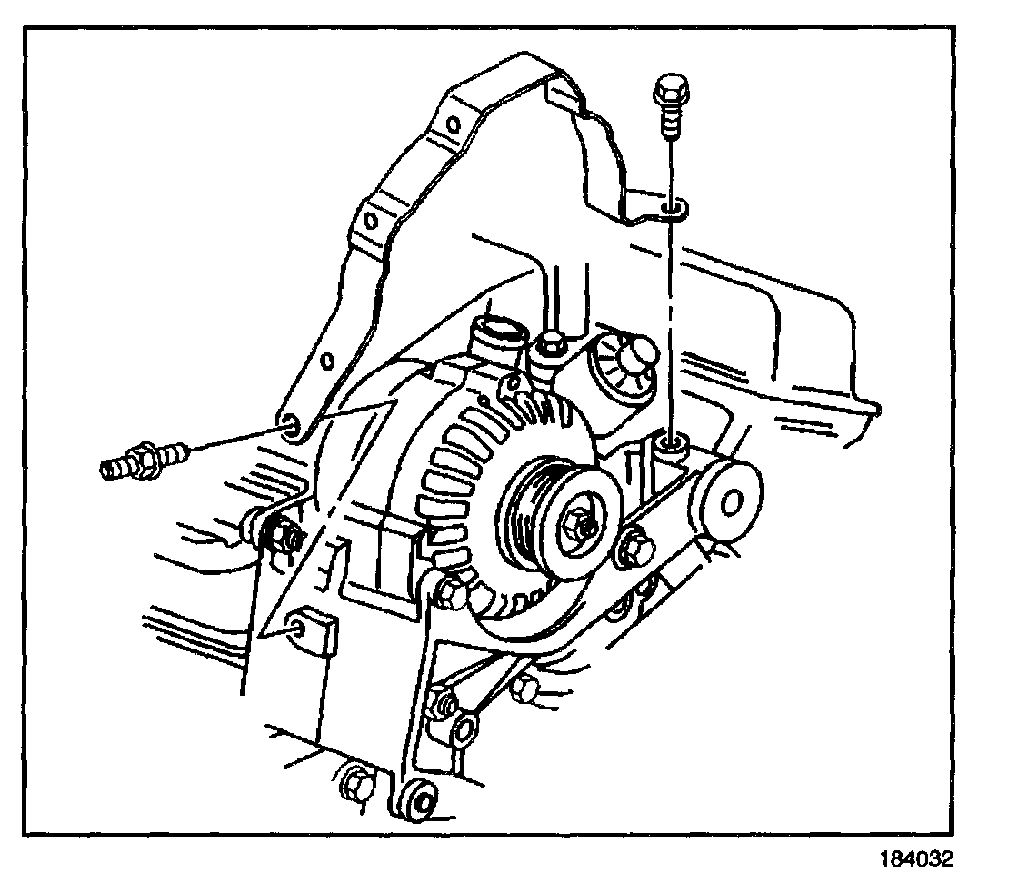

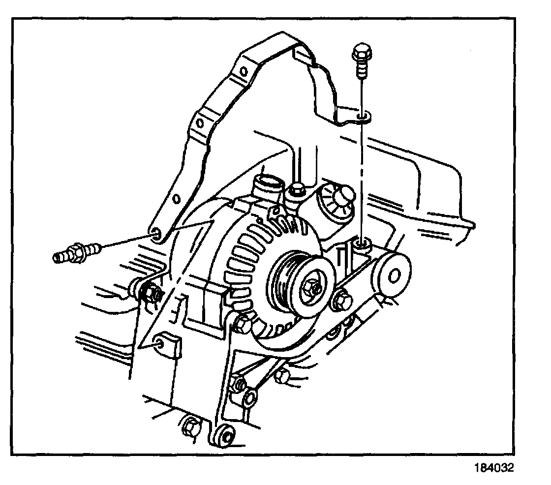

2. Install the generator to the engine.
3. Install the generator mounting bolts.
Tighten
- Tighten the generator front mounting bolts to 50 N.m (37 lb ft).
- Tighten the generator rear mounting bolt to 25 N.m (18 lb ft).
