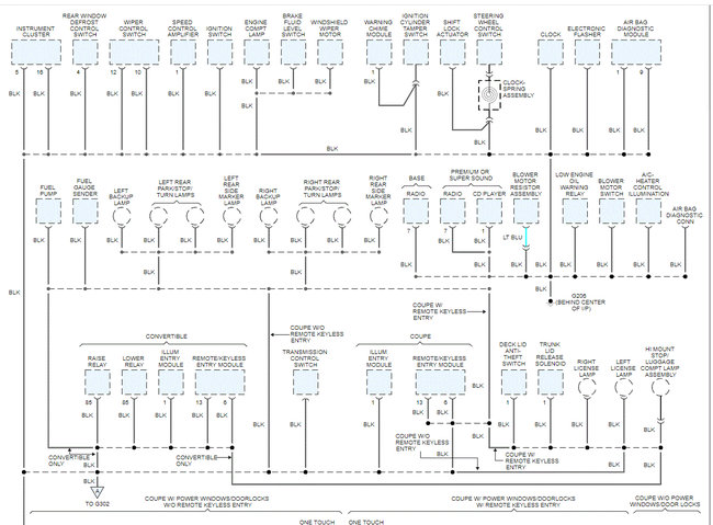

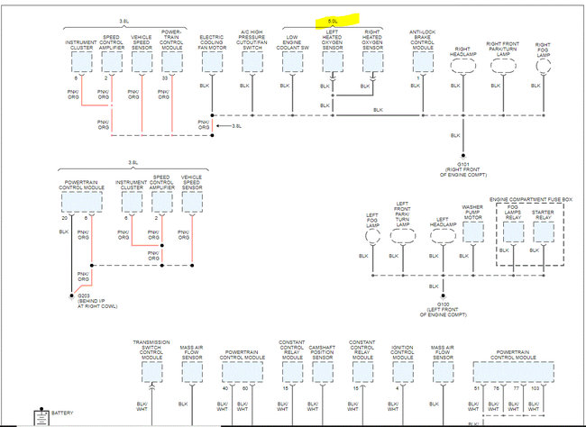

hey guys, I thought of that too. I had to remove one of the O2s but put it in a sandwch baggie to keep iy grom getting poisoned. I also thought I could of screwed up on my template for the catbacks and got the exhaust pipe inserted too far into muffler before welding it causing an exhaust restriction and choking out that bank, but that all checked out. The drivers side O2 simply got unplugged at the connector and re plugged back in. Doubled checked the O2s and they are all good. A thought that I just had is that the fuel pump ground could be loose. All of the grounds in the engine compartment were loose when I started looking at things after I purchased vehicle, the transmission mount nuts were finger tight and the driveline to differentail yoke bolts were about to fall out when I checked the U joints. Could you send me the Ground distribution list with locations if you could for vehicle. I would like to check that and then check/clean throttle/throttle body/TPS next. If all good I will move on to injectors/wiring next. Also where is the CCRM located on this vehicle? Thank you for your time. Alex.

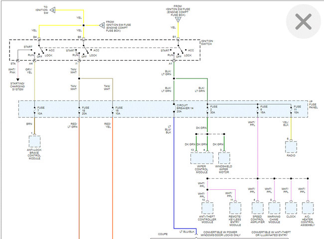

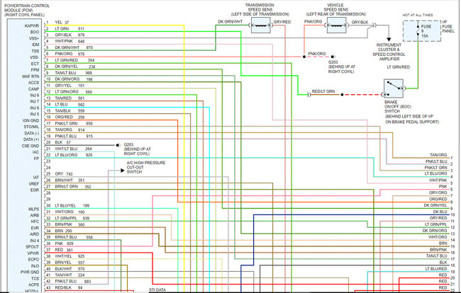

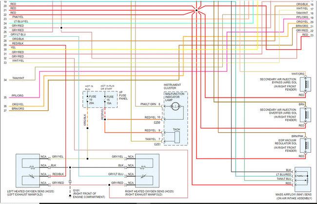

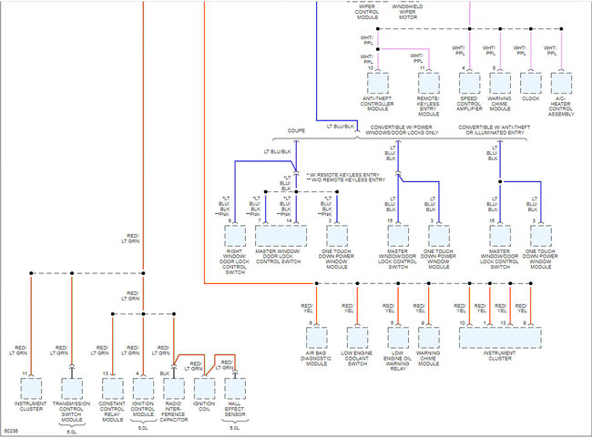

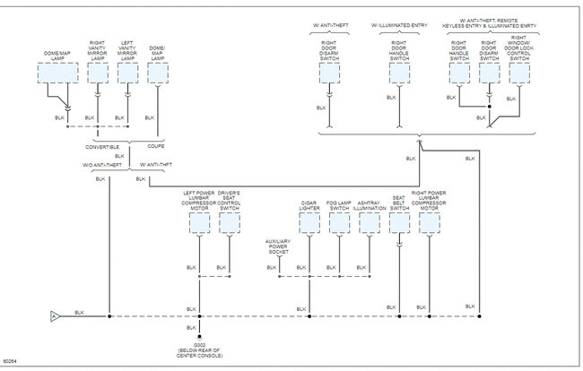

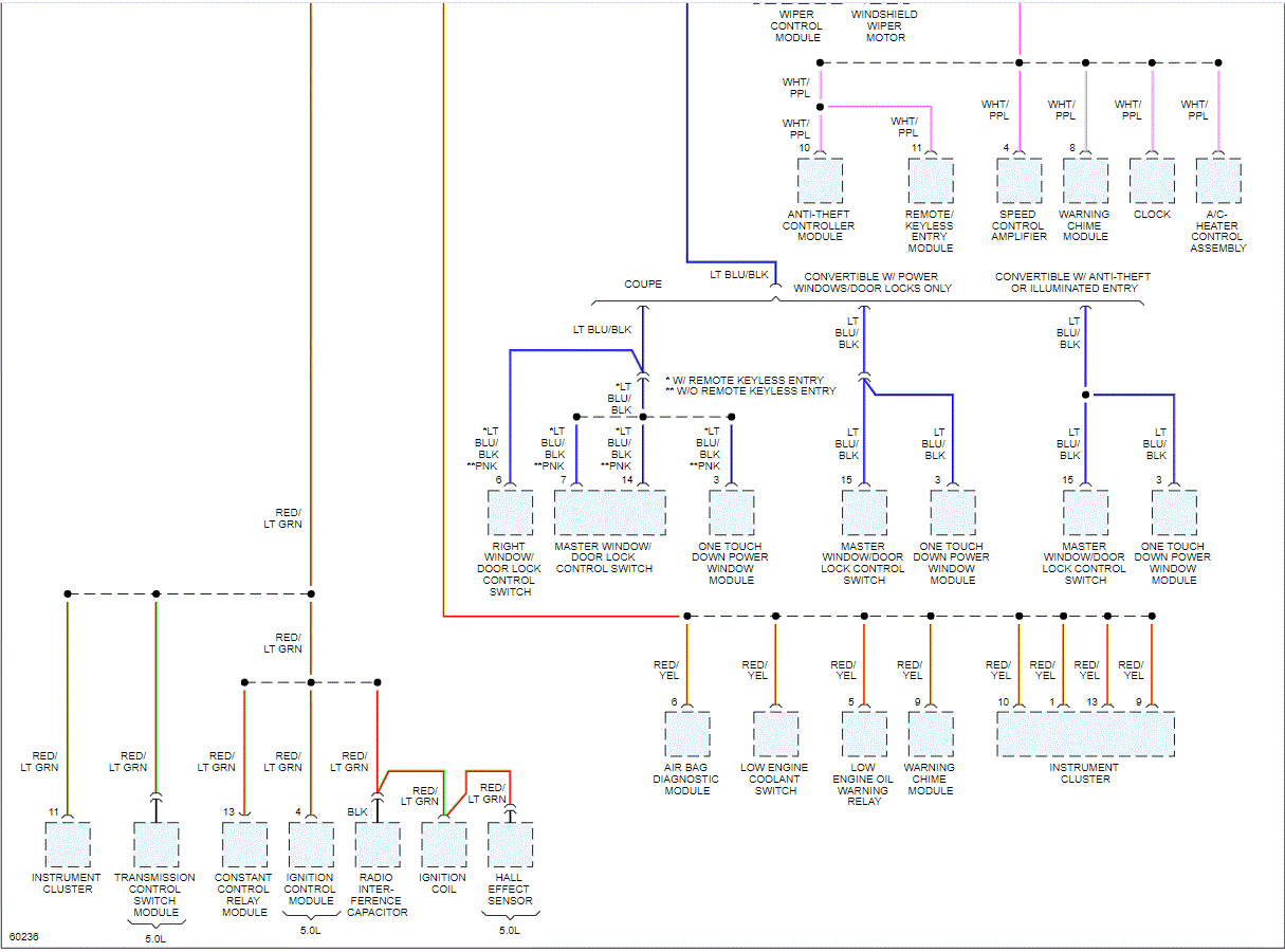

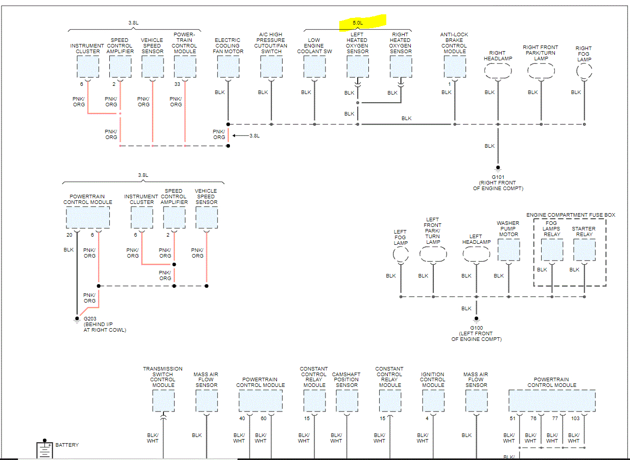

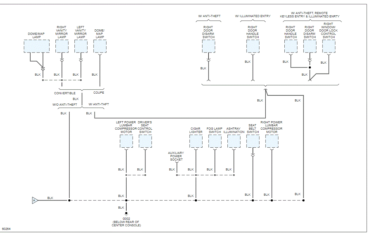

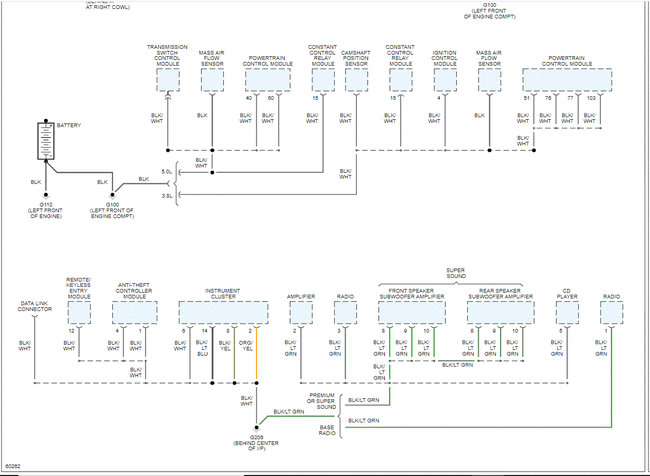

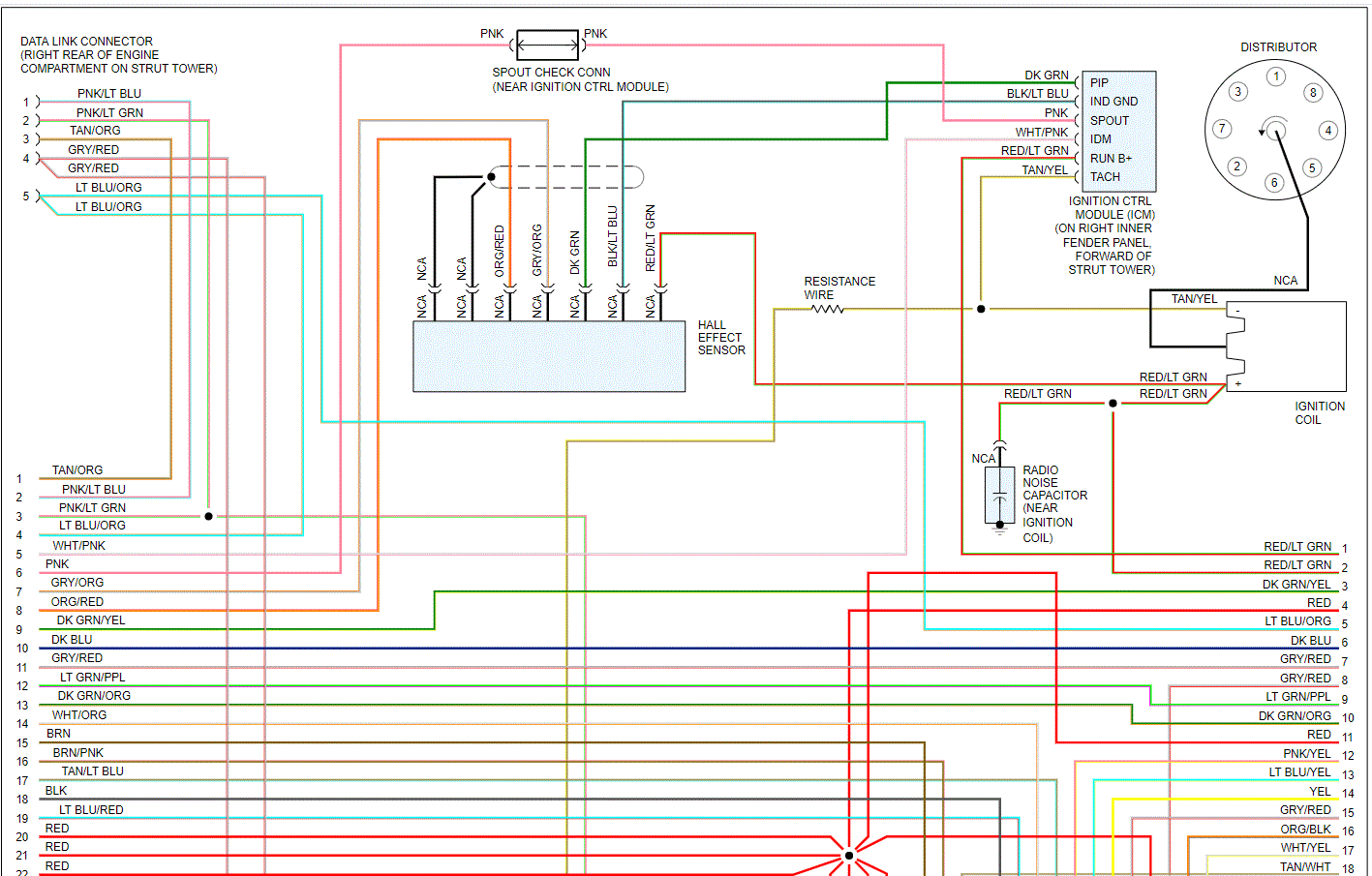

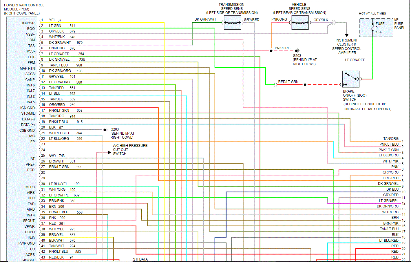

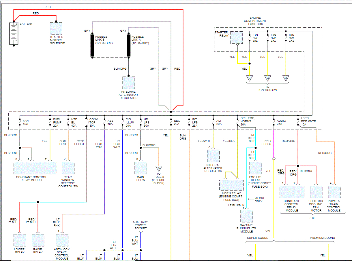

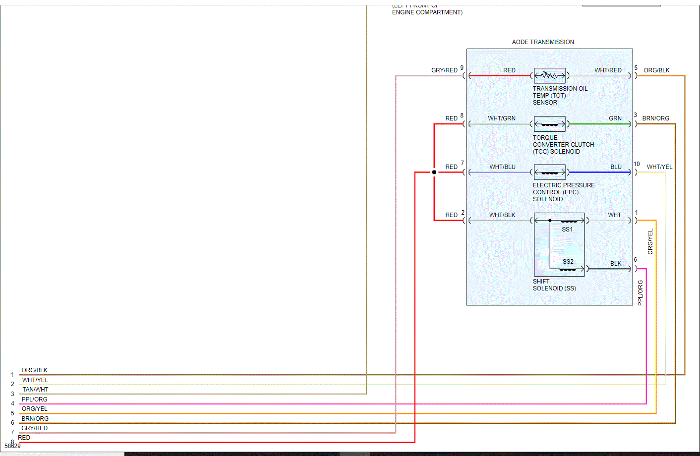

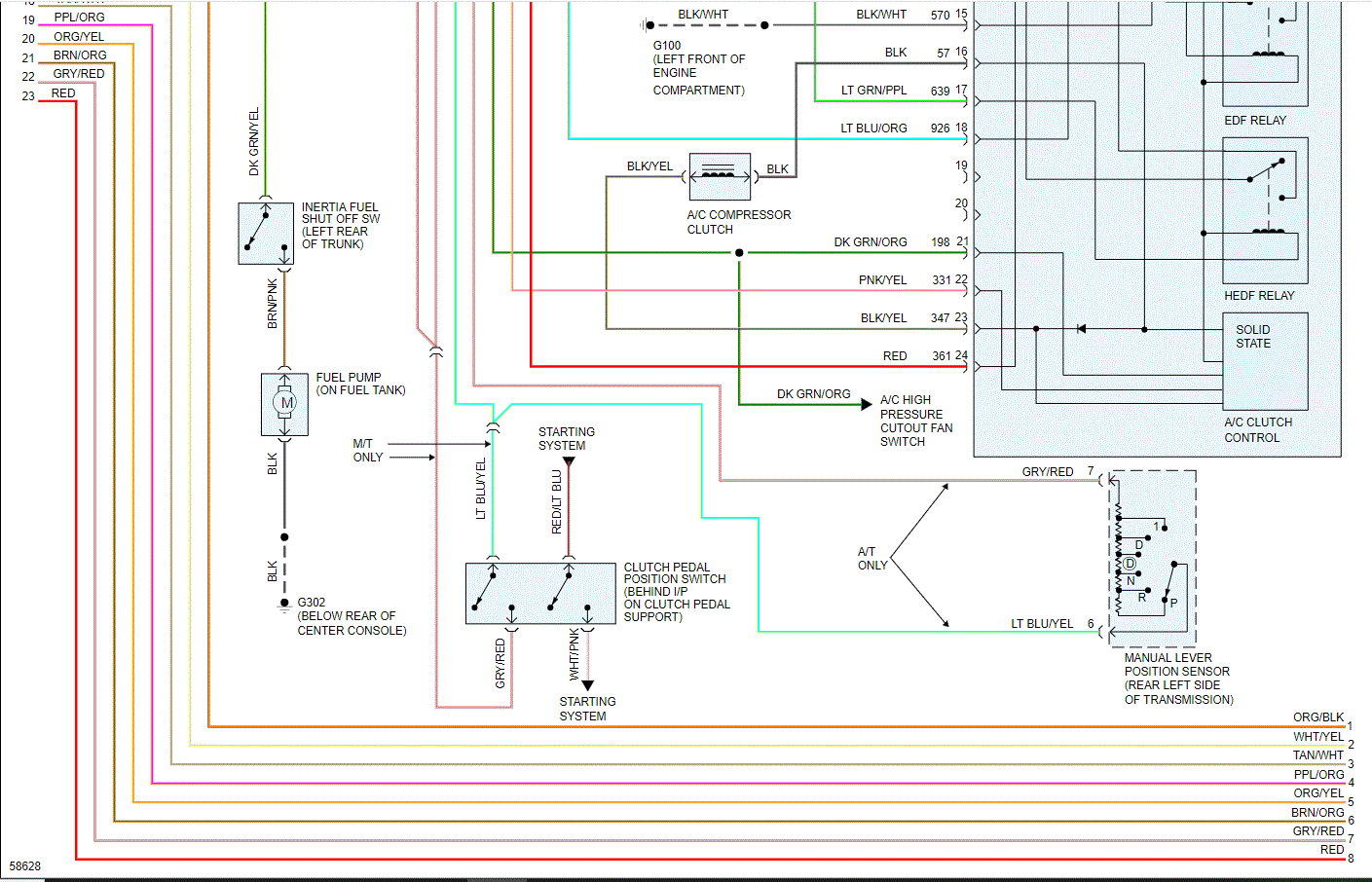

If this is a Cobra, you have to let me know. I looked up the GT 5.0L HO.

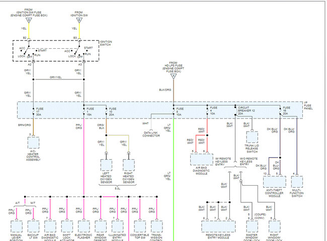

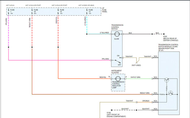

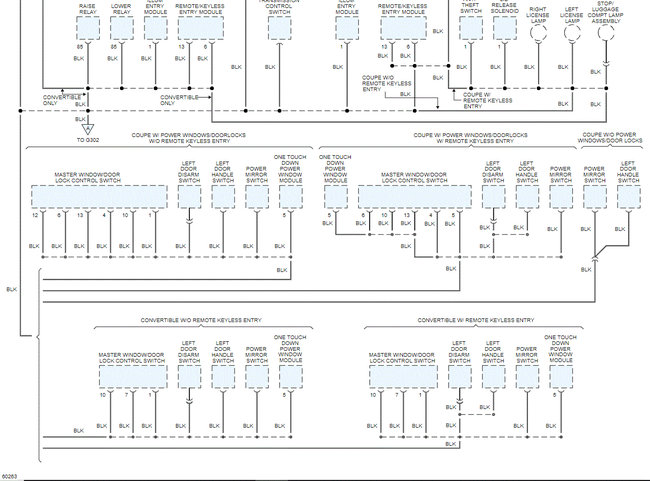

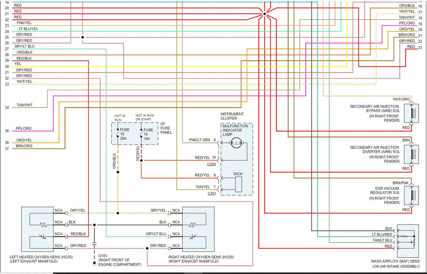

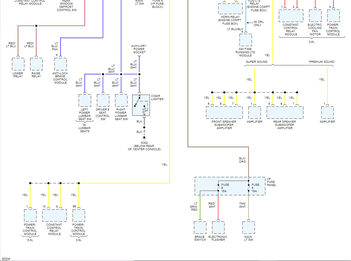

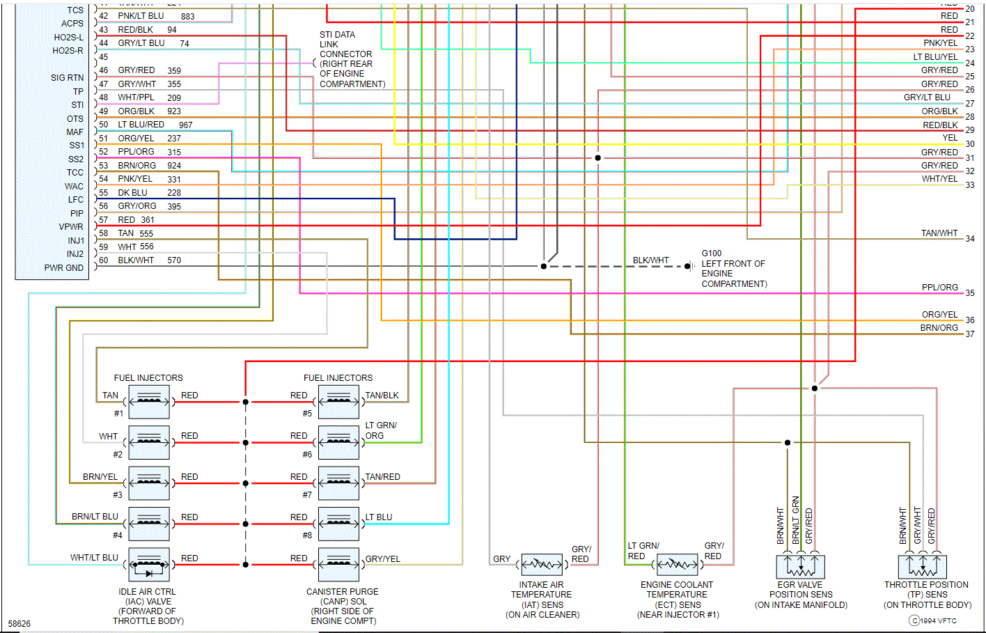

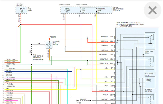

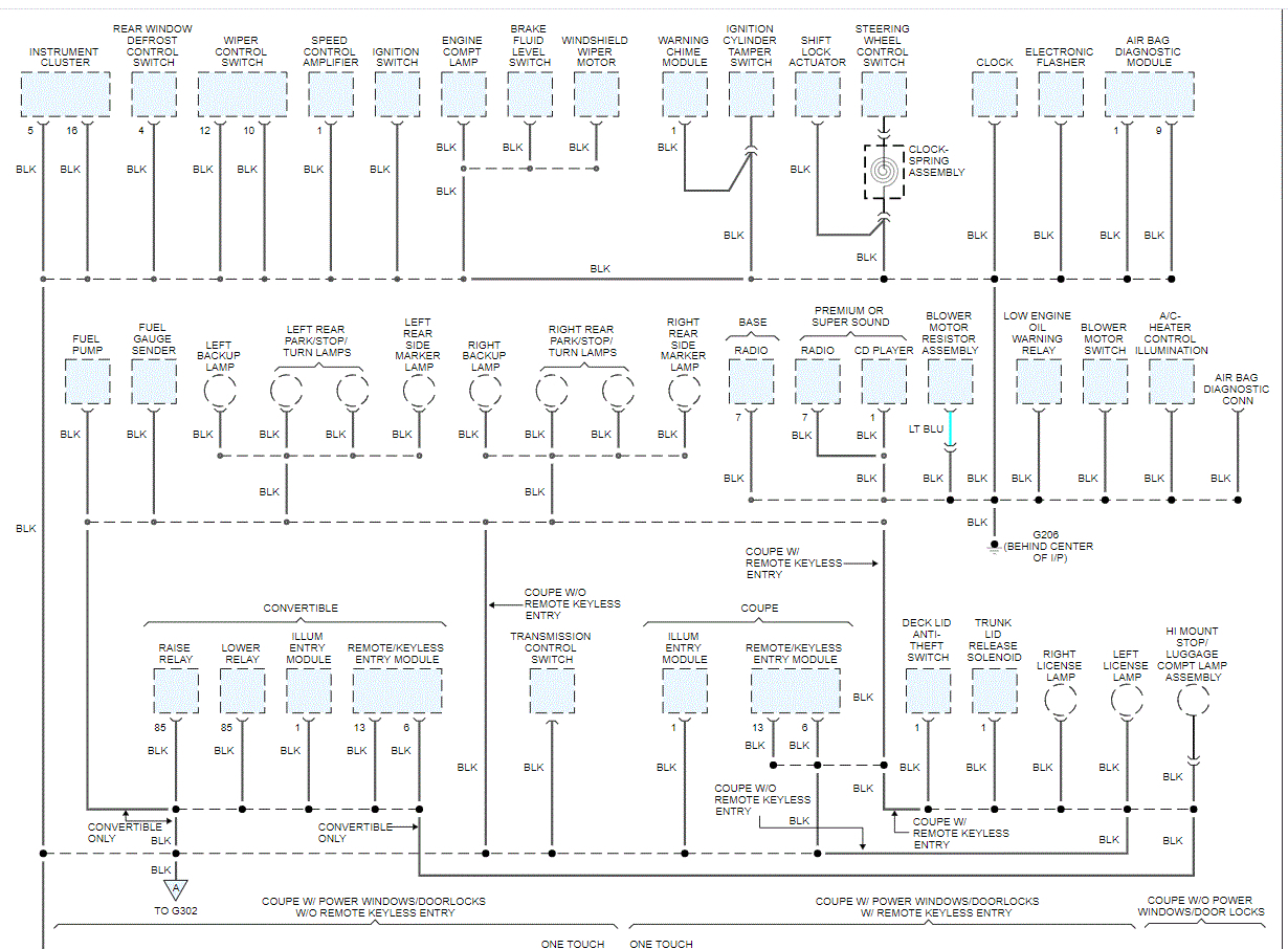

The first 5 pics below are the ground distribution schematics. The remaining pics are the powertrain control schematics. I'm adding them so you have a reference if needed.

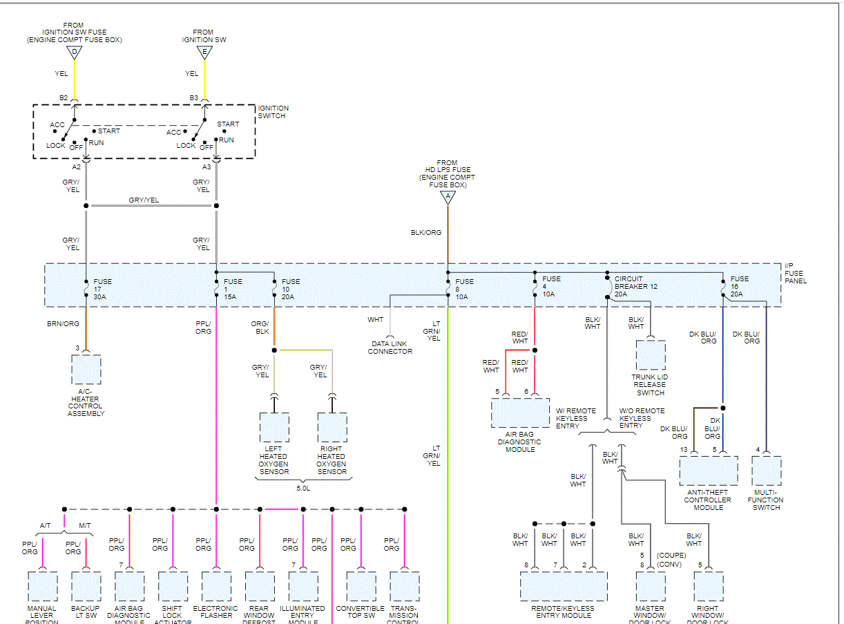

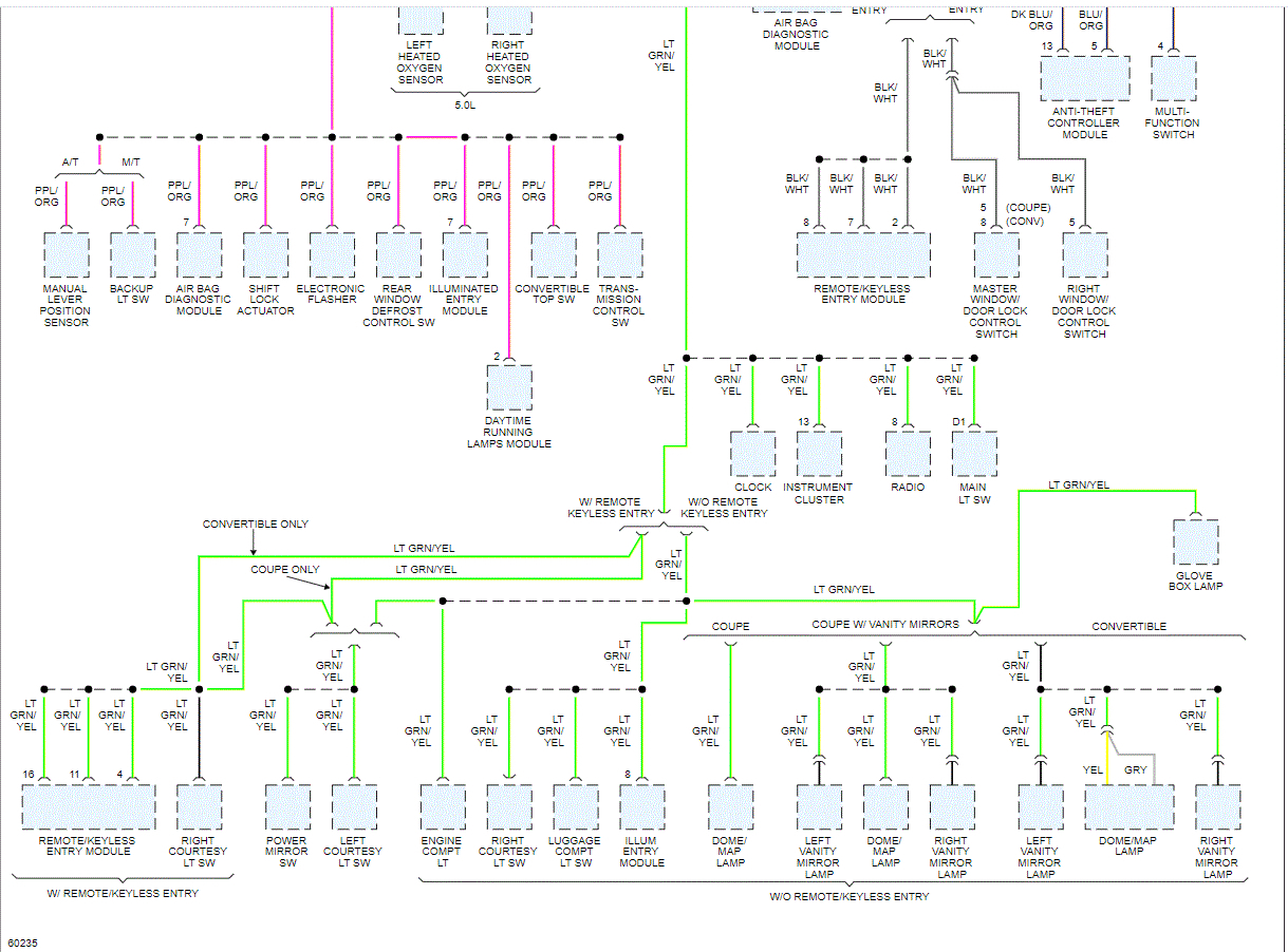

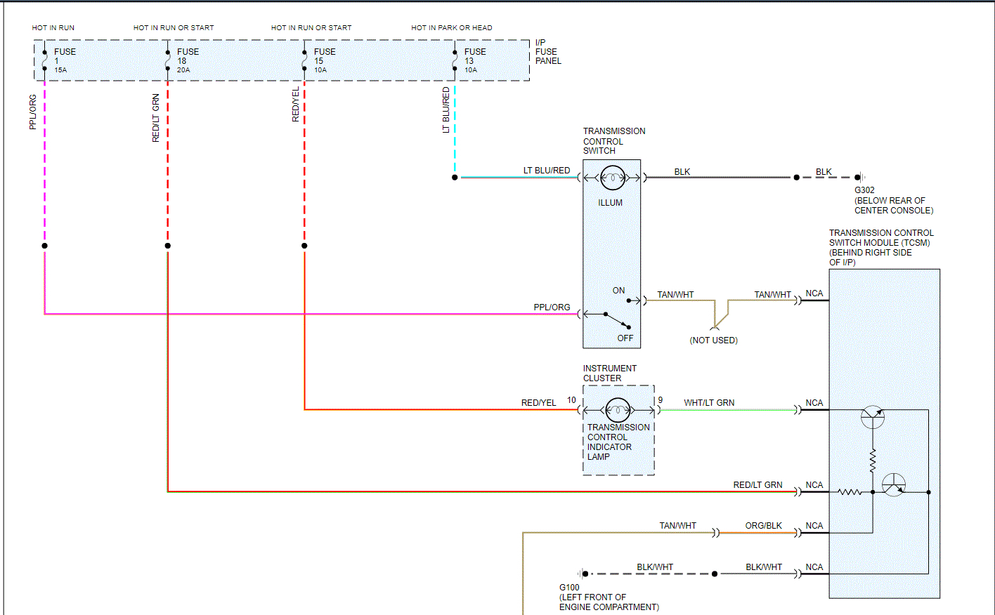

Afterthought: The last 6 pics are of the power distribution. I figured you may need them as well. LOL Also, here is a link you may find helpful:
Take care and if you have a chance, let me know what you find or if you have other questions.
