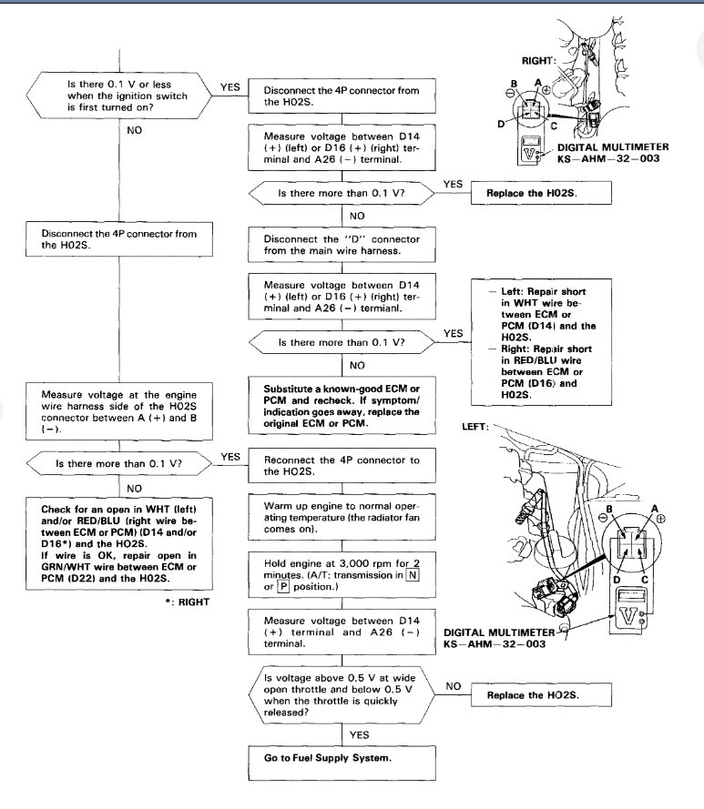

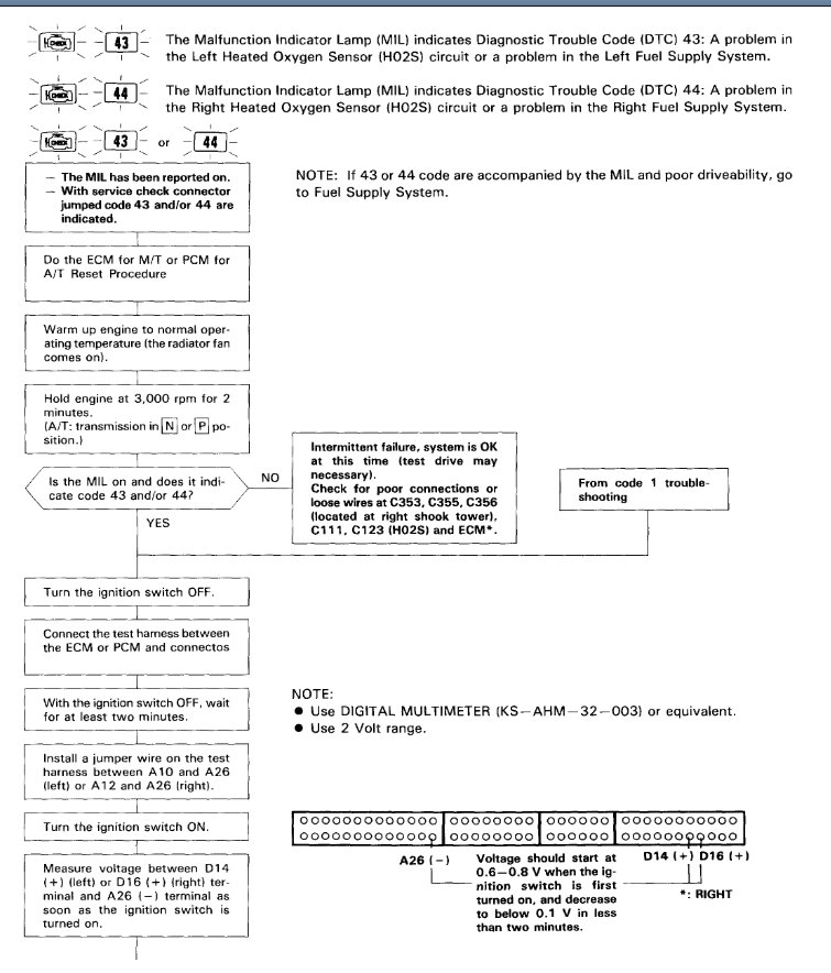

when i'm at a constant speed, and after it has warmed up, my car will give a hesitation when i give it gas. it doesn't seem to do it while it's warming up, and doesn't do it every single time i give it gas.. also, it almost never gives a code, but the couple times that it has, it has been a 44.
i have replaced the O2 sensors and the fuel filter, as well has having run a couple tanks through with sea foam and its still doing it. any ideas?

I attached the diag for this code. We need to run through it but this could be an o2 sensor, ECM, or a wiring issue. Since you already replaced the o2 sensors, we need to limit it down so let me know if you have questions and we can go from there. Thanks
