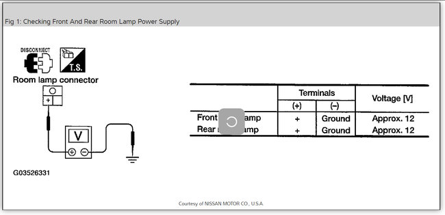

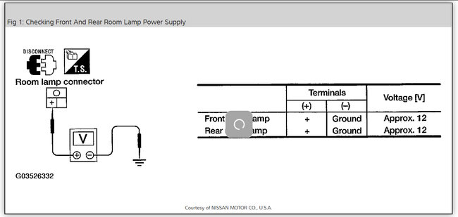

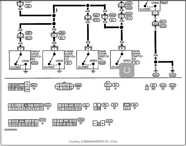

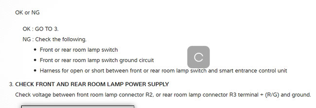

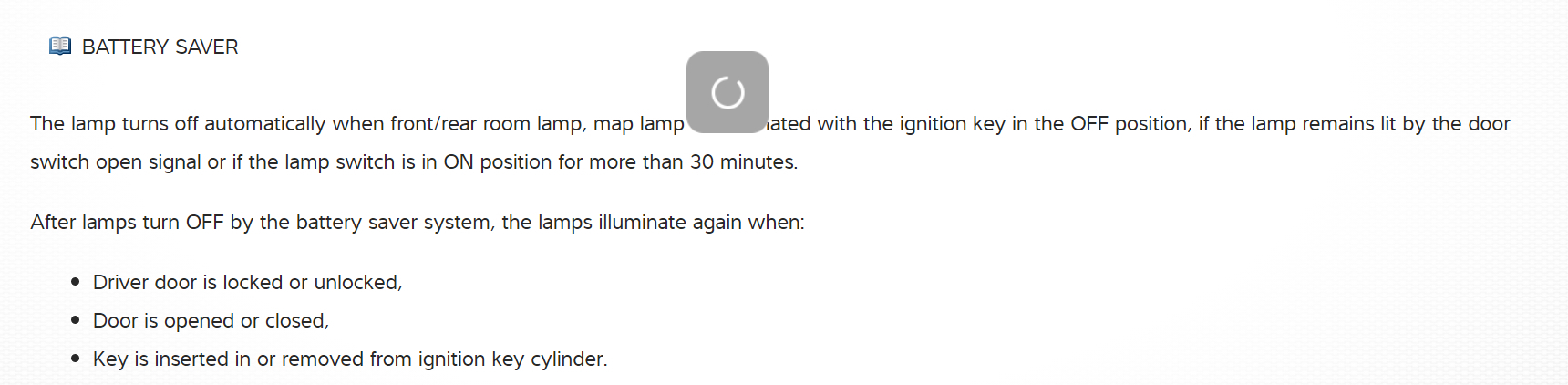

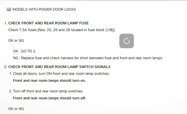

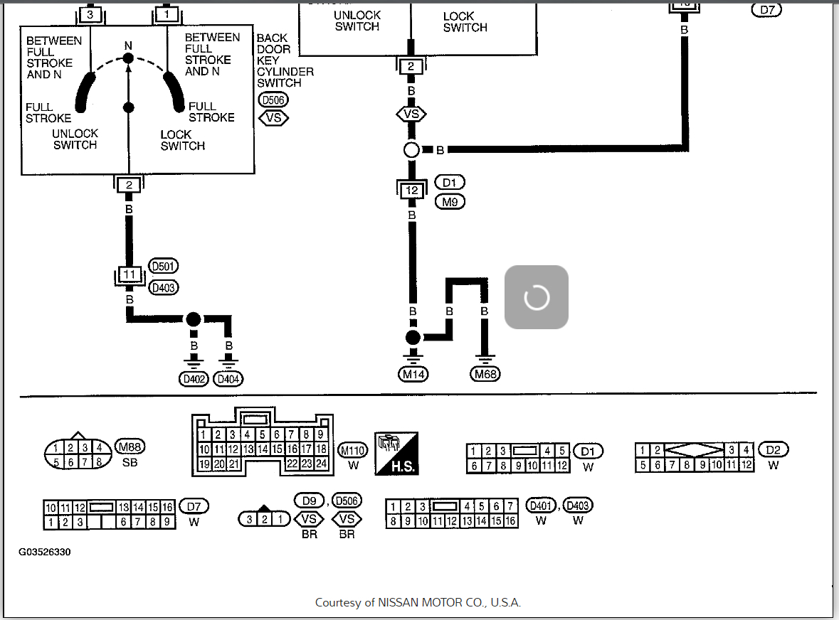

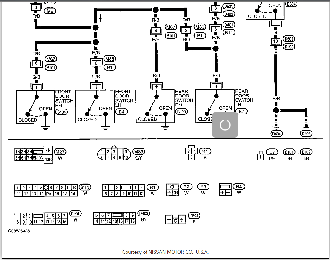

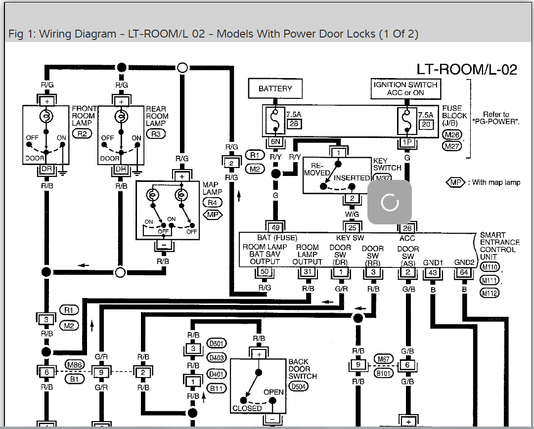

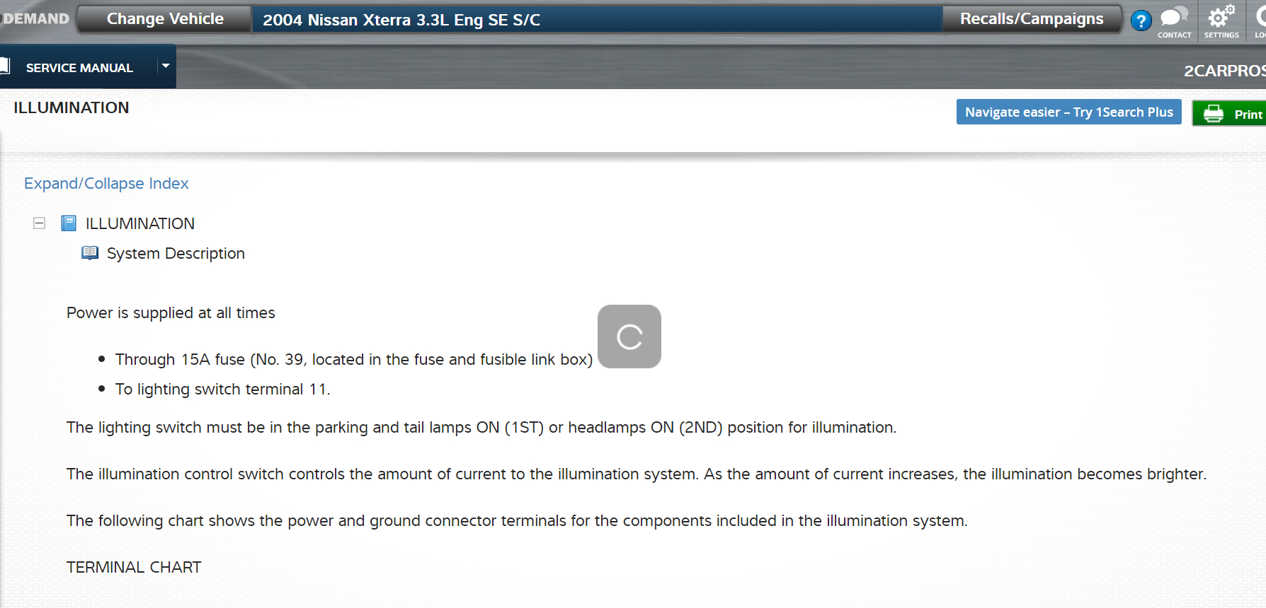

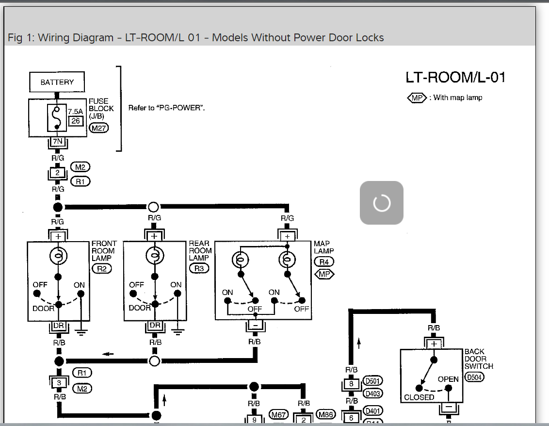

Okay, so I was giving this vehicle for some work I did. It was stolen from previous owner. Well when they got it back the ignition housing to key cylinder was bent to heck. Also the radio was stolen. I do not have original keys or fob. I've replaced from harness clip to the key. I have also replaced starter, and battery. I've replaced all fuses as well. I still can't get power to my interior lights at all done dash nothing. How can I get power to my dash? And is there a way to reset security system with it factory keys, fob, or radio?
Mar 20, 2019 at 10:25 PM
SCGRANTURISMO
  • 4,897 POSTS

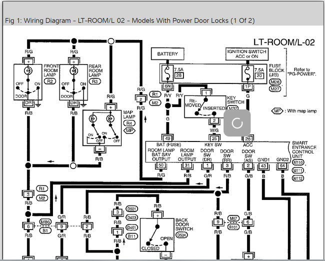

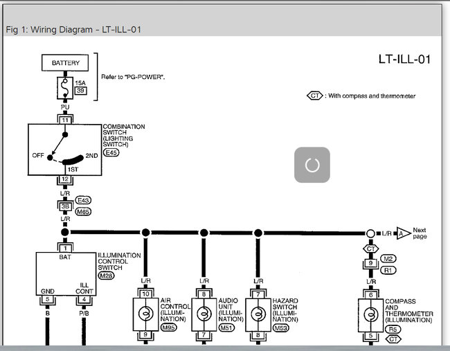

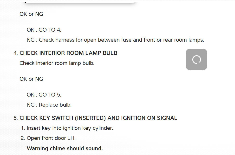

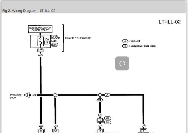

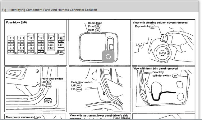

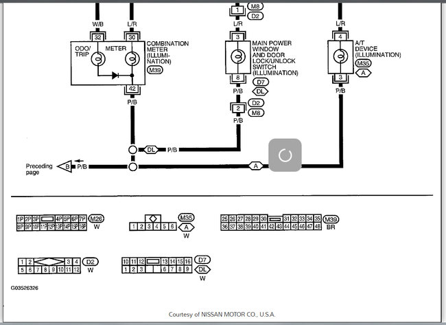

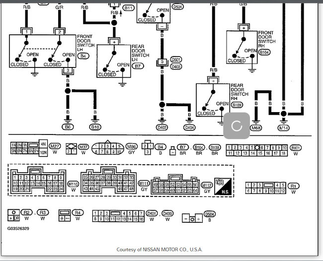

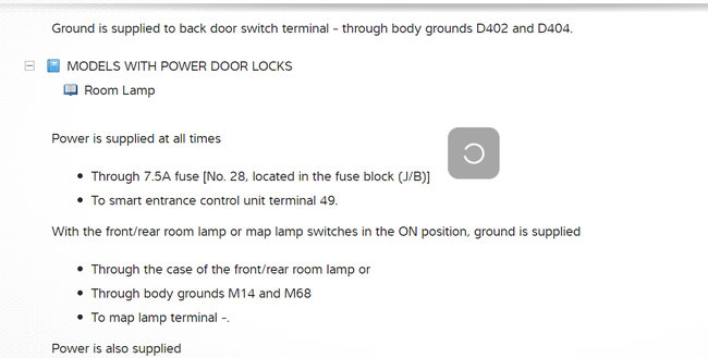

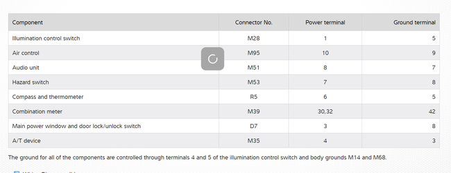

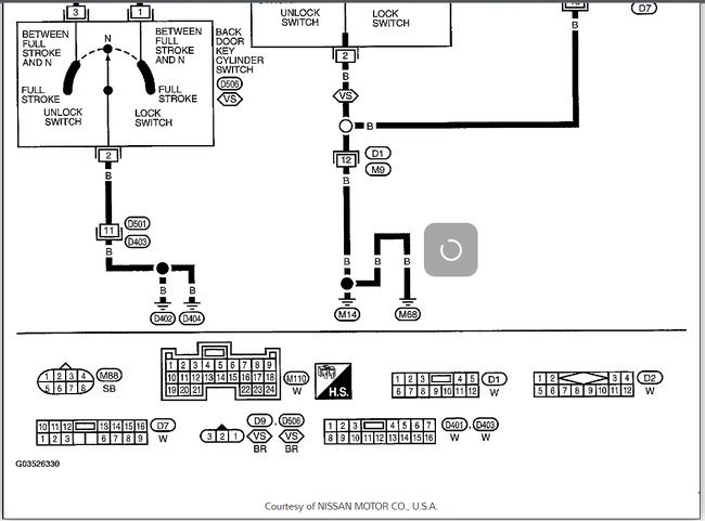

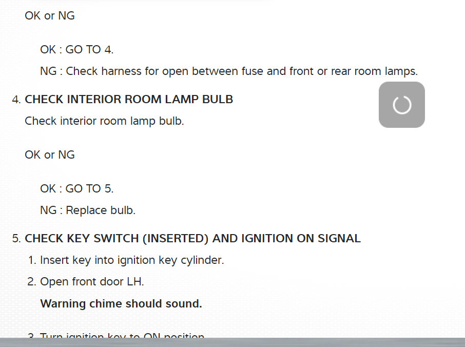

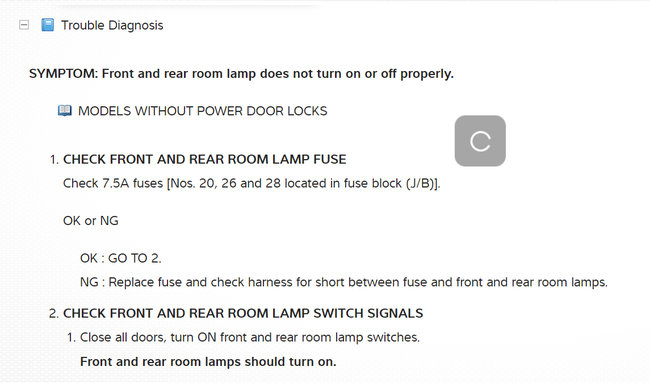

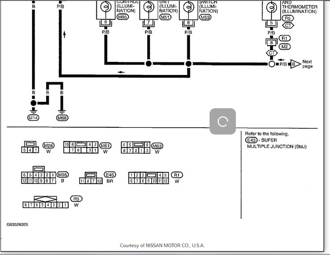

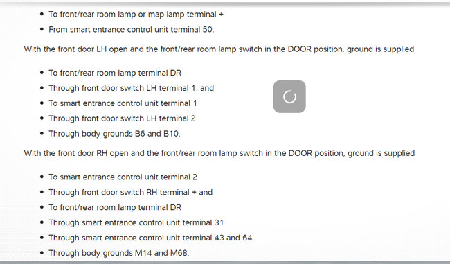

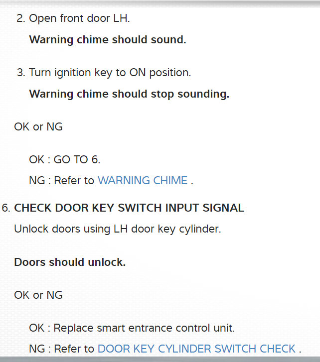

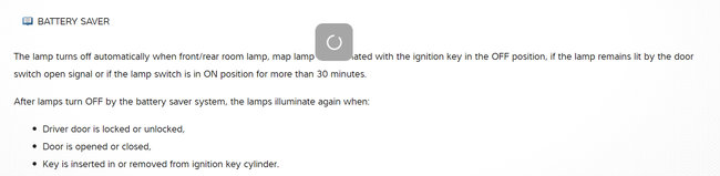

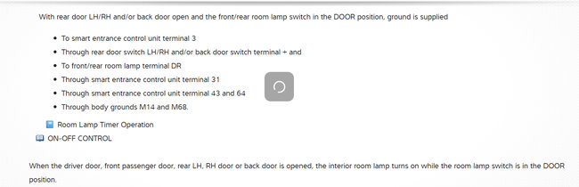

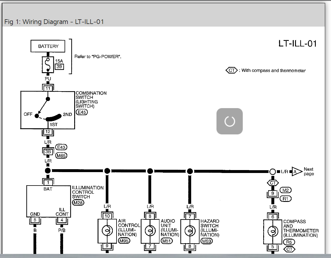

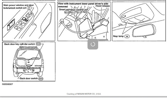

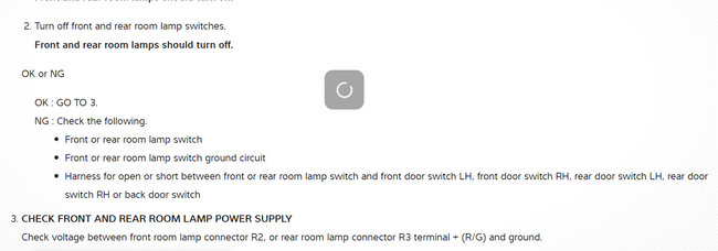

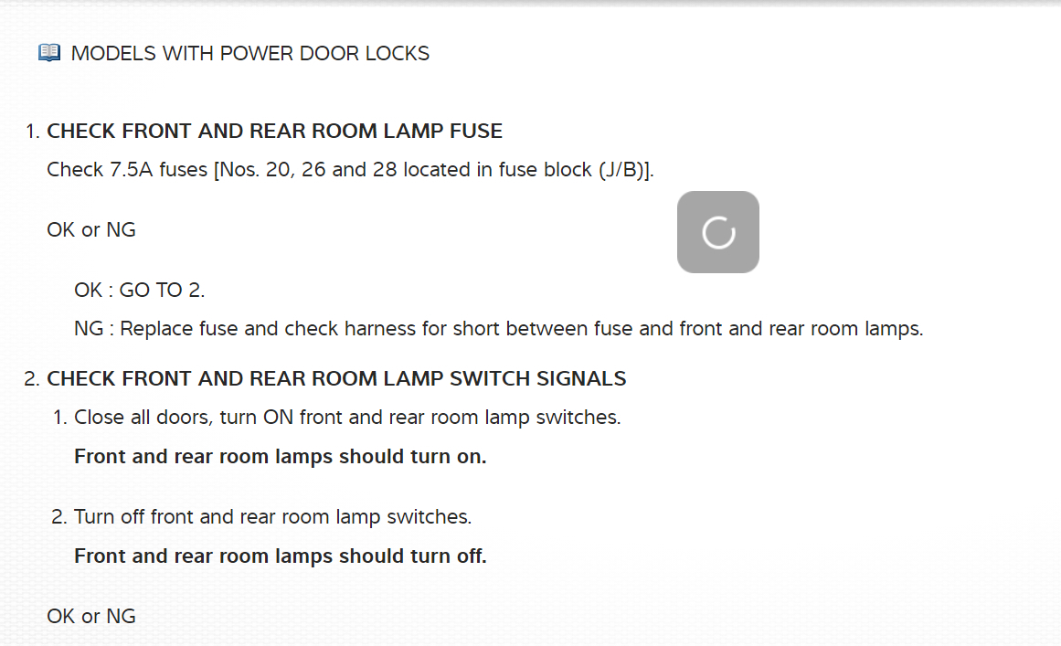

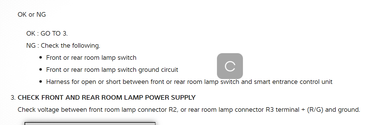

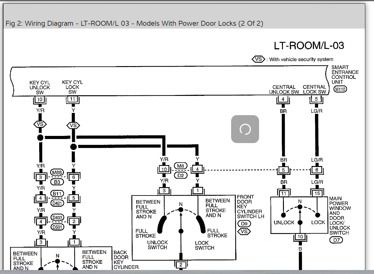

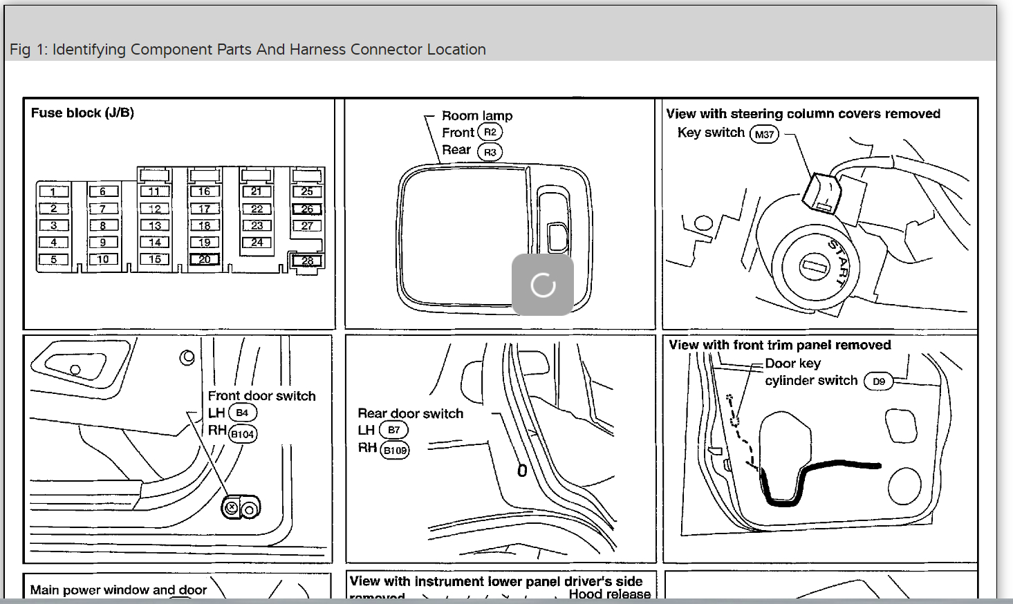

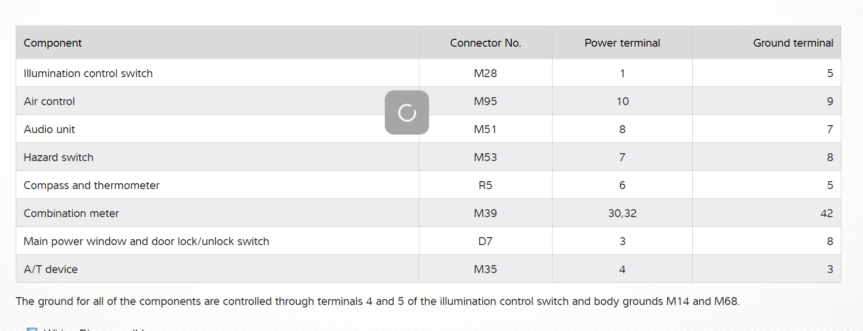

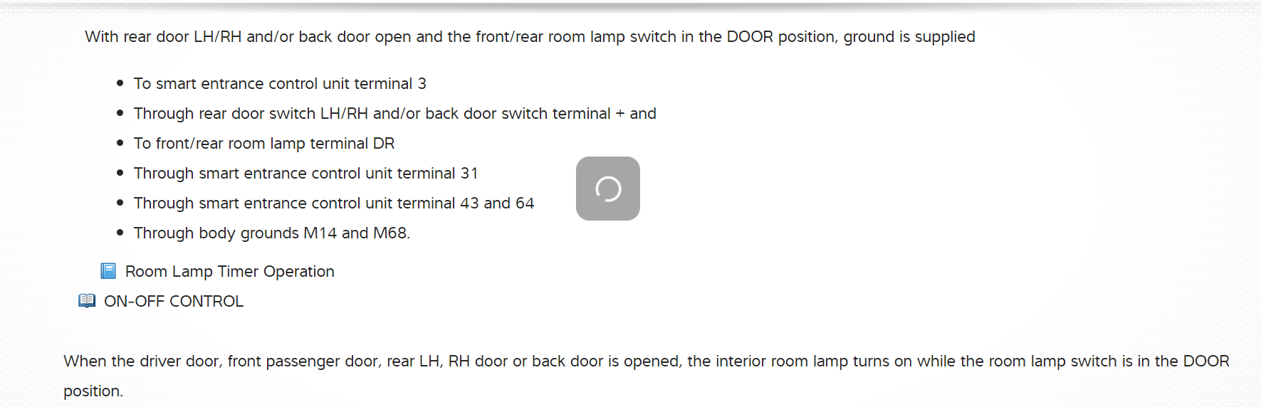

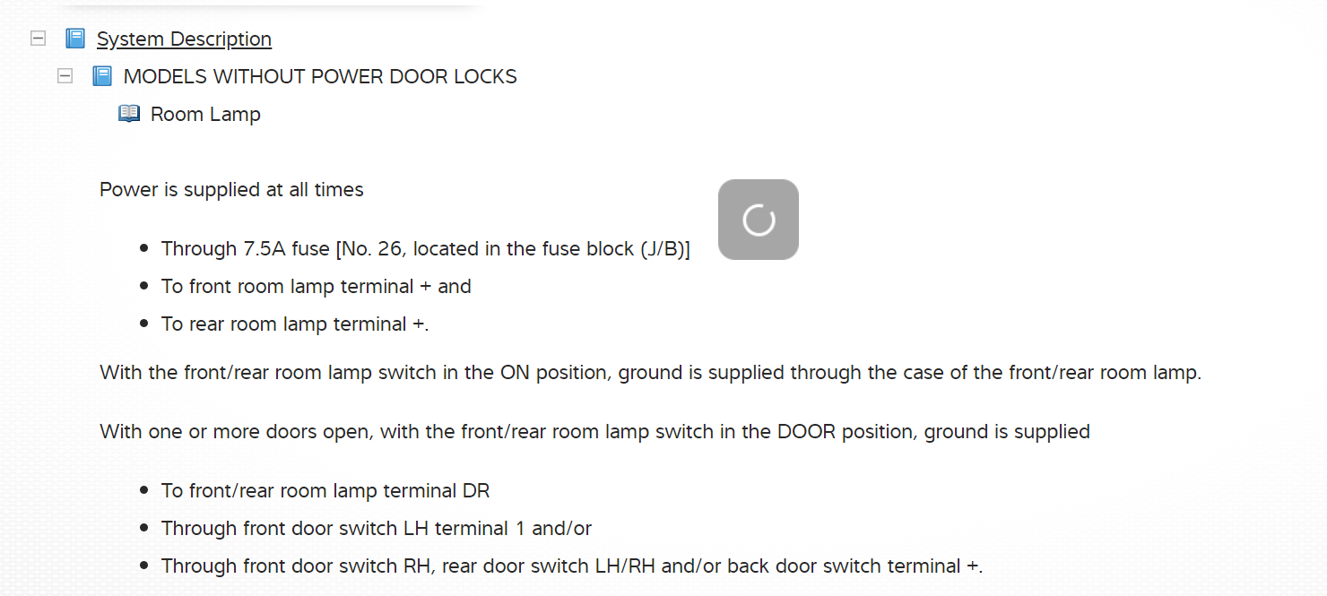

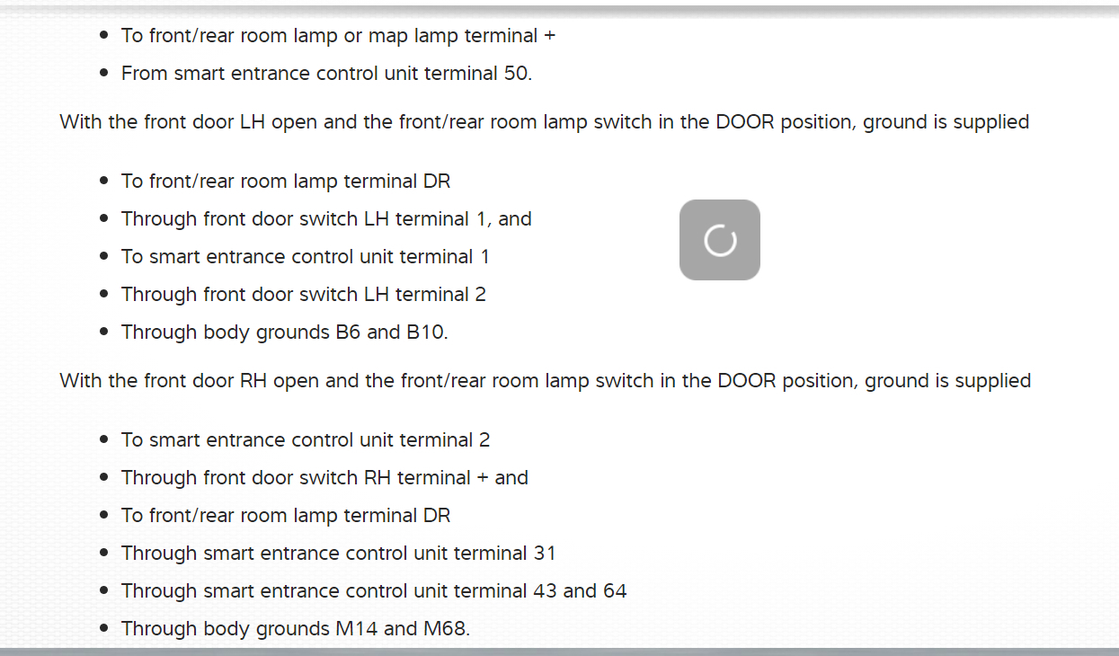

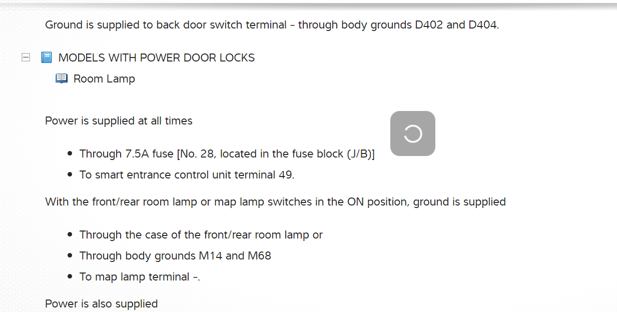

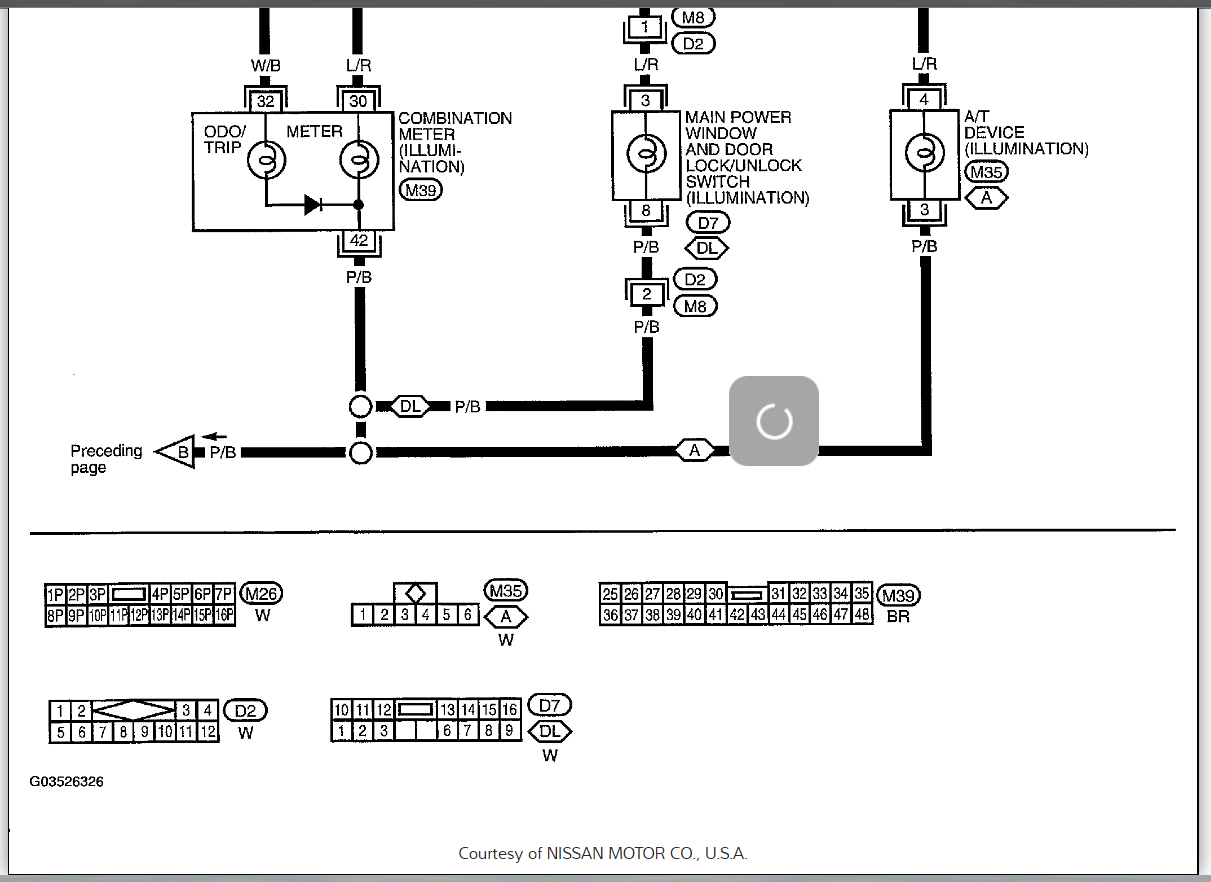

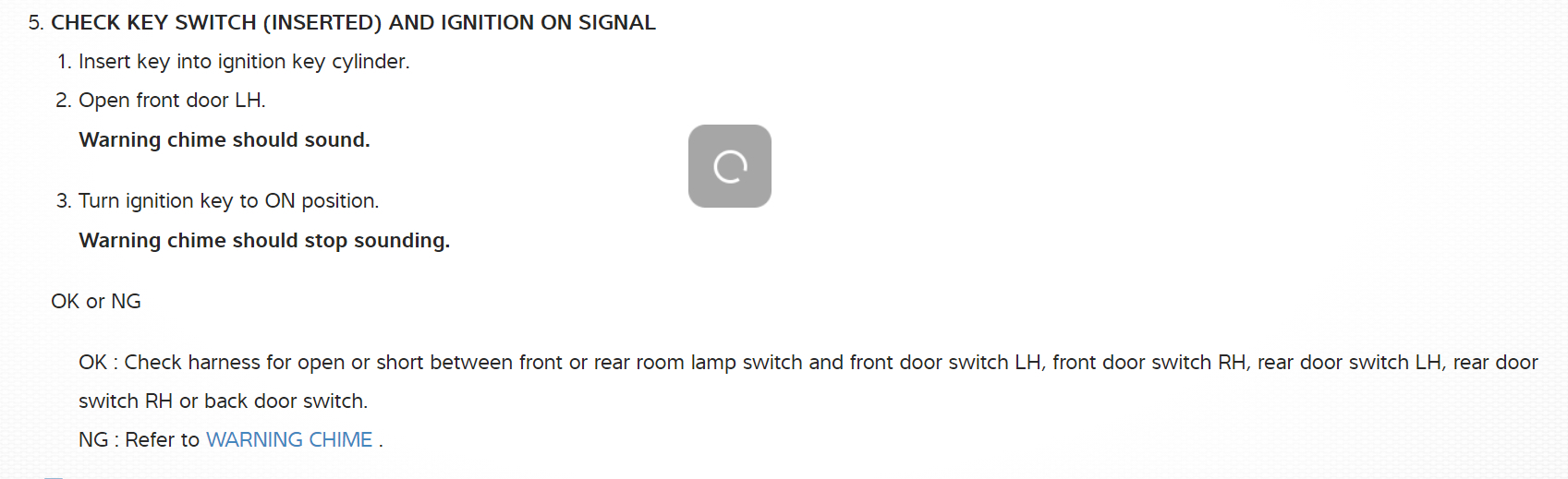

No. The only way to get car to start is to have a key made at the dealership or at a locksmith. This is a chipped key and was designed that way as an anti theft system. The dash illumination and the interior lights is a different story all together. Not only do I have how these system works, I've also got wiring diagrams and a step by step factory troubleshooting flowchart for both the illumination and the interior light systems for your vehicle in the diagrams down below. I wasn't sure if your vehicle had power door locks or not, so I included instructions for both of them. Please go through the flowcharts and get back to us with what you find out.
