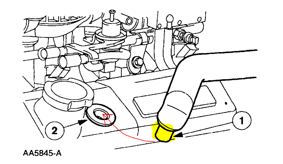

If you were to bring the vehicle to me, here is what I would be checking. First, I would confirm there isn't a vacuum issue related to the PCV valve hose. Additionally, I would test for vacuum leaks. Here is a link that explains how it's done.

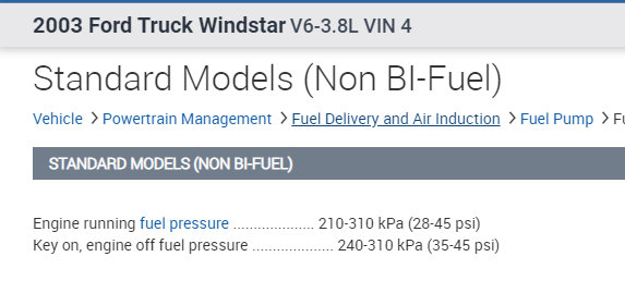

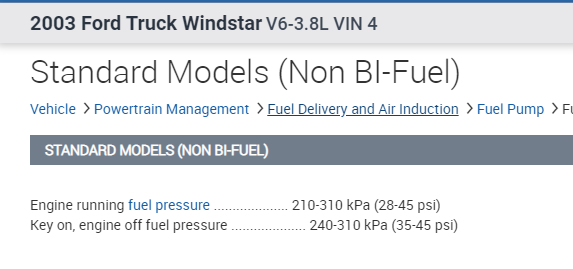

If I determine there are no leaks, I would next check fuel pressure. You will need a fuel pressure gauge to do this, but most parts stores will lend one to you. Here is a link that explains in general how it's done:
At this point, testing of fuel flow through the injectors, engine compression, a faulty oxygen sensor, and the list goes on can cause it.
Let's get through checking the PCV, checking for vacuum leaks, and fuel pressure. I have a feeling the problem is with one of these things.
If you look at pic 1 below, it shows the PCV valve. Check the hose and the grommet that the PCV presses into for leaks. That is on the driver's side valve cover. Pic 2 provides the manufacturer's fuel pressure specifications. Make sure to pay attention to how quickly the pressure drops when the key is turned off.

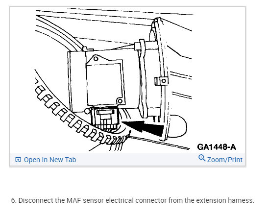

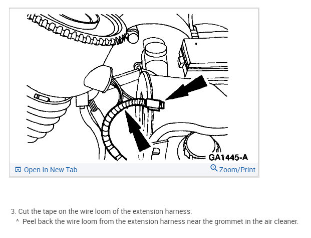

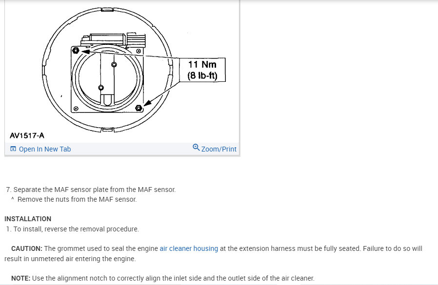

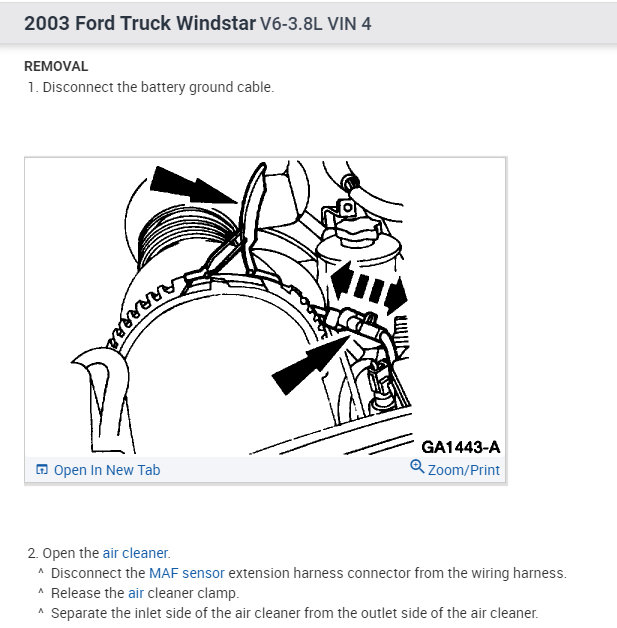

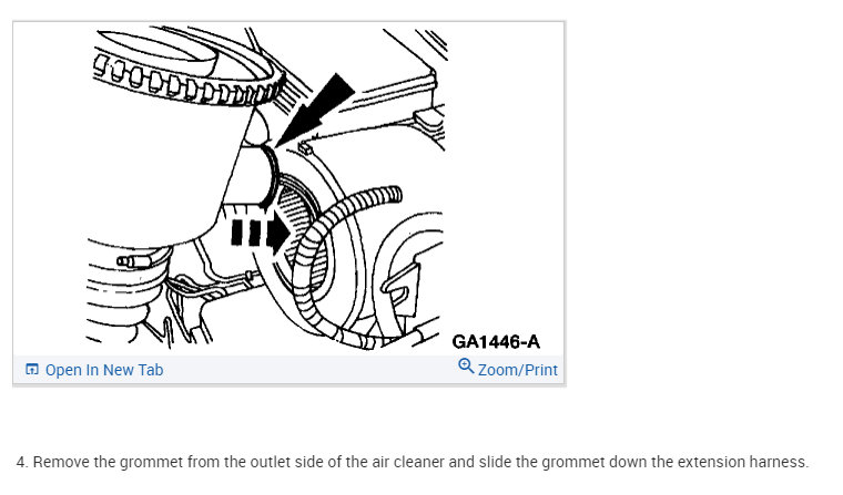

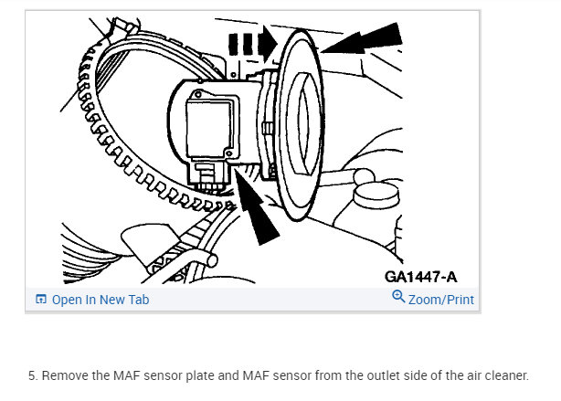

As far as cleaning the MAF, here is a link that explains how to do it:
https://www.2carpros.com/articles/mass-air-flow-service
If you look below, I attached the directions for replacing the MAF. I'm not saying to replace it, but the directions will help you with accessing it.
