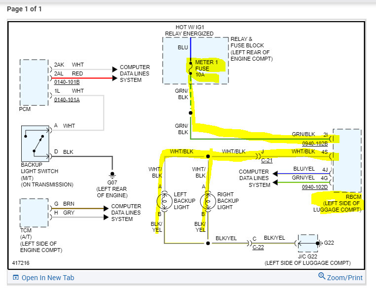

I've got the vehicle listed above, VIN: JM3KE2CY9F0478828. I need to identify the wire on the rear body control module that turns on the reverse gear back-up lights.
The part number on the module is KD45675YOG
Do you have access to this kind of info?
Thanks!

Power to the rear body control module (RBCM) is provided via the meter 1 fuse in the engine compartment fuse box.
Power from the fuse goes to the RBCM via a green wire with a black tracer. From there, power is triggered via the CAN, and power is sent to the backup lamps via a white wire with a black tracer.
I attached the schematic below. Let me know if this helps or if you have other questions.
joe
See pic below.

Thanks Joe! Exactly the info I needed :) My backup camera is working fine now. This is the second time you've been a big help! Mahalo
