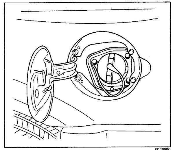

pic 1
2. Remove Fuel filler cap(1).

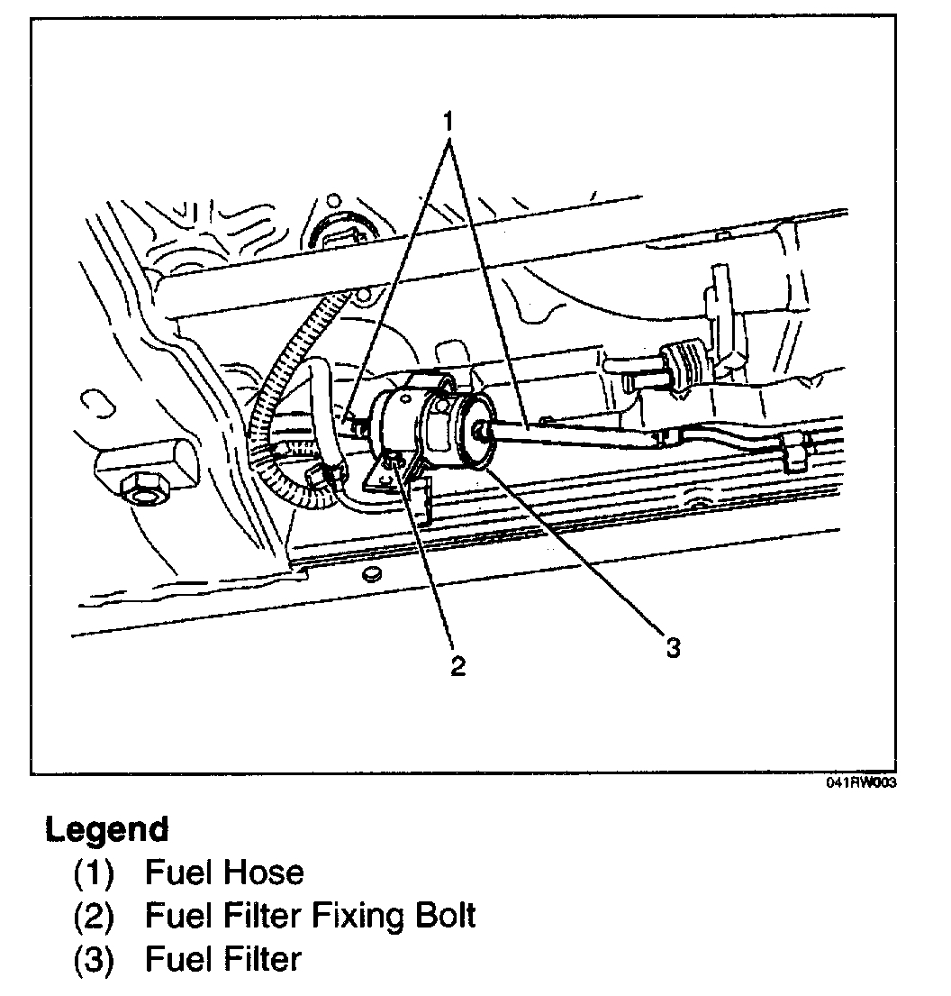

3. Disconnect fuel hoses(1) from fuel filter on both engine side and fuel tank side.
4. Fuel filter fixing bolt(2).
- Remove the fuel filter fixing bolt(2) on fuel filter holder.
pic 2
5. Remove fuel filter(3).

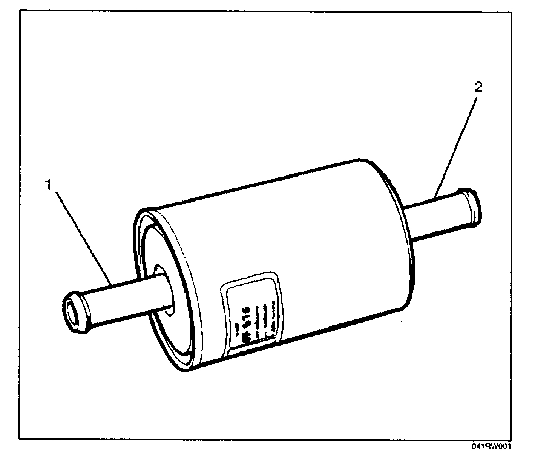

1. Disconnect the negative battery cable.
pic 3
2. Remove the fuel filler cap.
3. Disconnect the fuel hose from the fuel filter on the engine side.
4. Disconnect the fuel hose from the fuel filter on the fuel tank side.

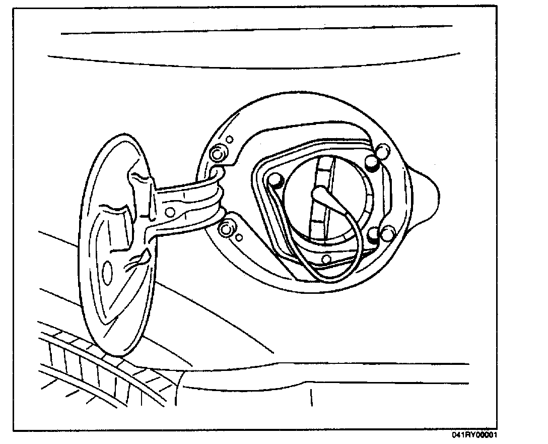

pic 4
5. Remove the bolt on the fuel filter holder.
6. Remove the fuel filter.

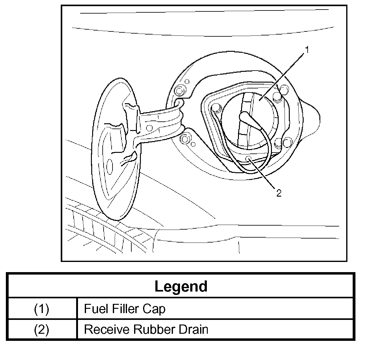

pic 5
3. Connect fuel hoses on engine side(1) and fuel tank side(2).
4. Install fuel filler cap
5. Connect the battery ground cable.
