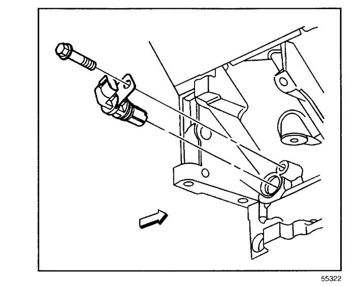

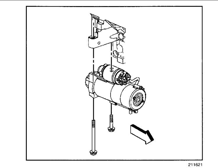

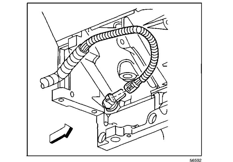

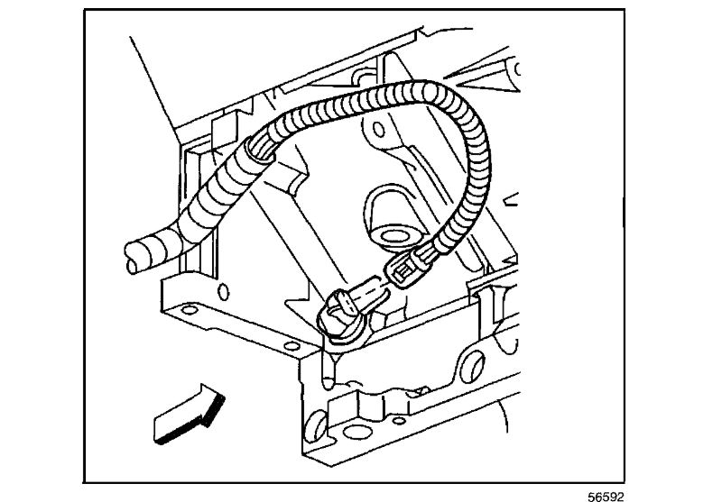

This sounds like it could be a crank sensor.
1. Disconnect the negative battery cable.
2. Raise the vehicle. Refer to Lifting and Jacking the Vehicle.
3. Remove the starter.
4. Disconnect the crankshaft position (CKP) sensor electrical connector.
5. Clean the area around the CKP sensor before removal in order to avoid debris from entering the engine.
6. Remove the CKP sensor retaining bolt.
7. Remove the CKP sensor.
