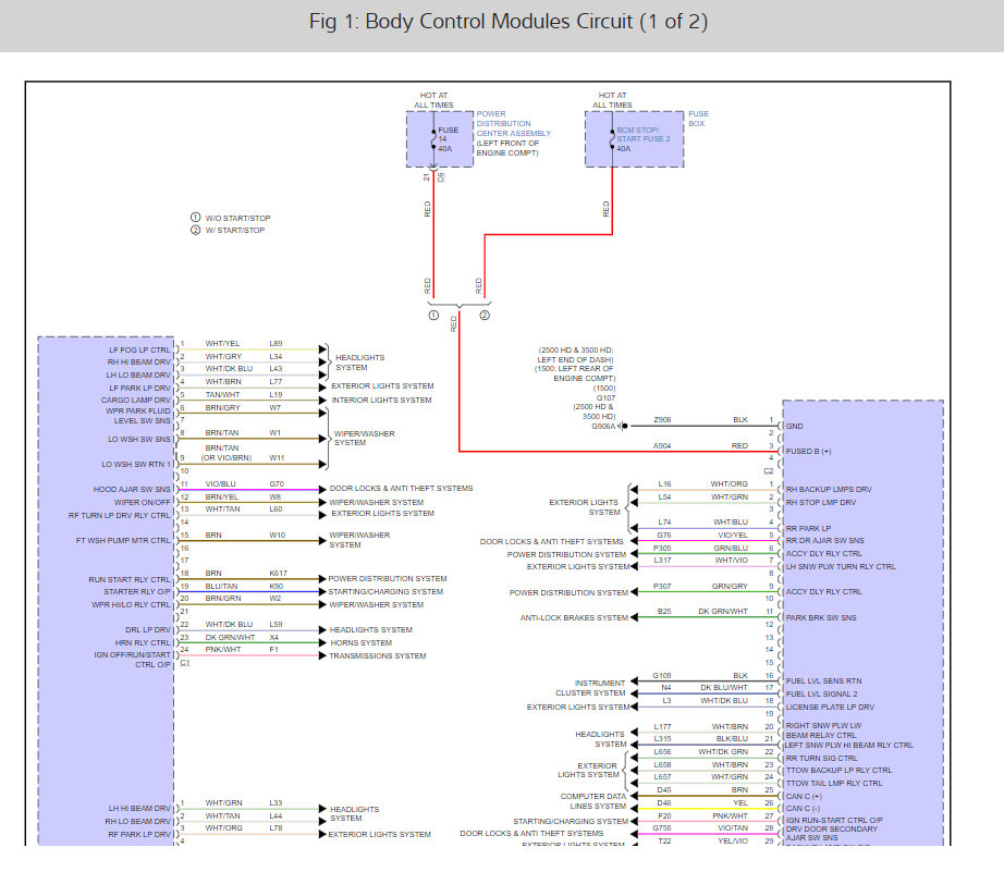

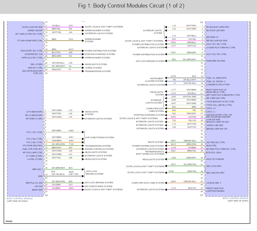

I want to install rear fog lights ,i have a programmer it says; Allows you to activate or deactivate the Rear Fog Lamps. In vehicles for the US market, it may be necessary to add the missing wiring harness between the BCM module and the rear fog lamps. I want to add missing wiring.

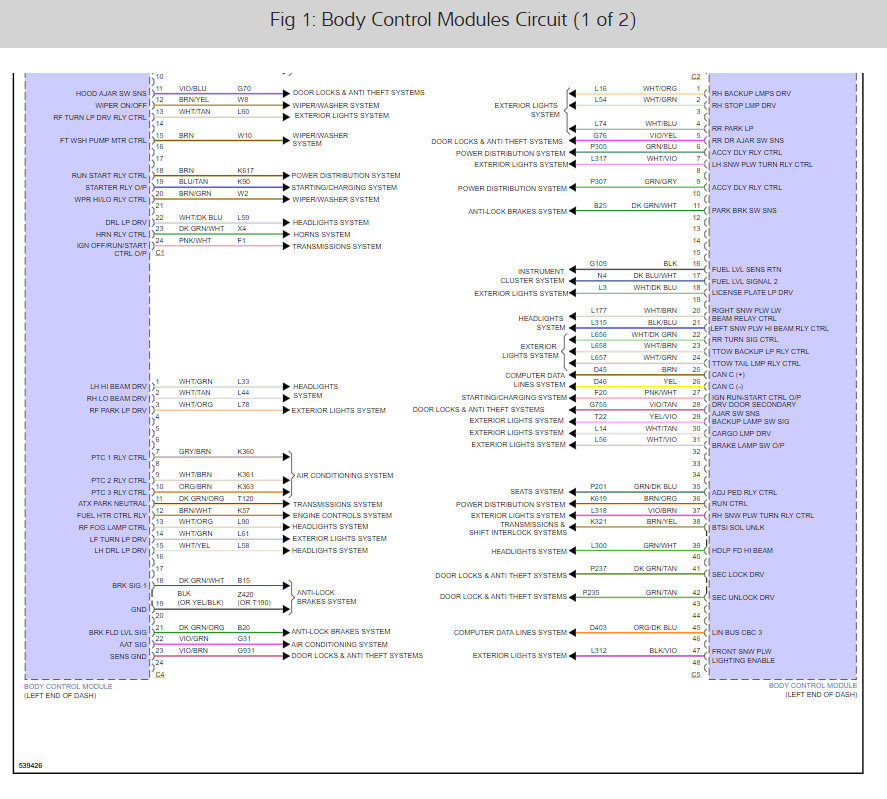

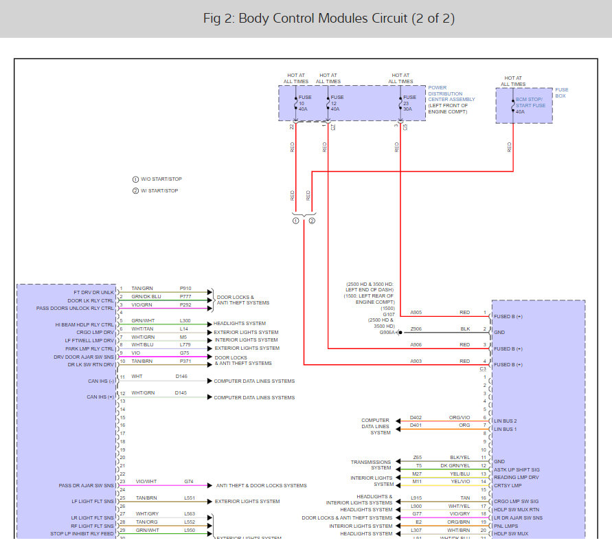

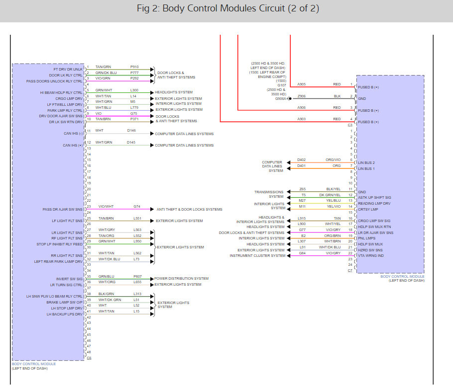

Here is a guide to help you test the wiring and the wiring diagrams for the BCM in the images below:
