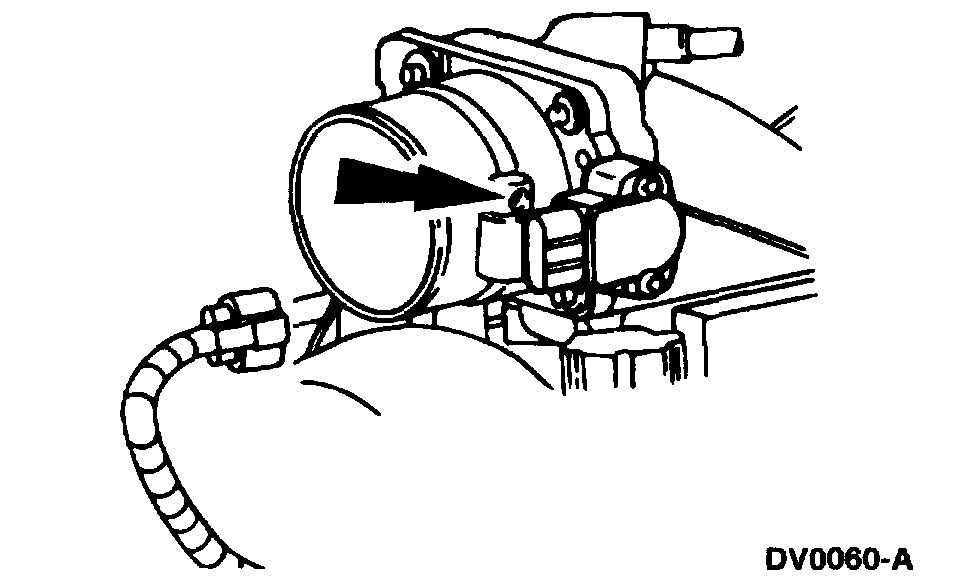

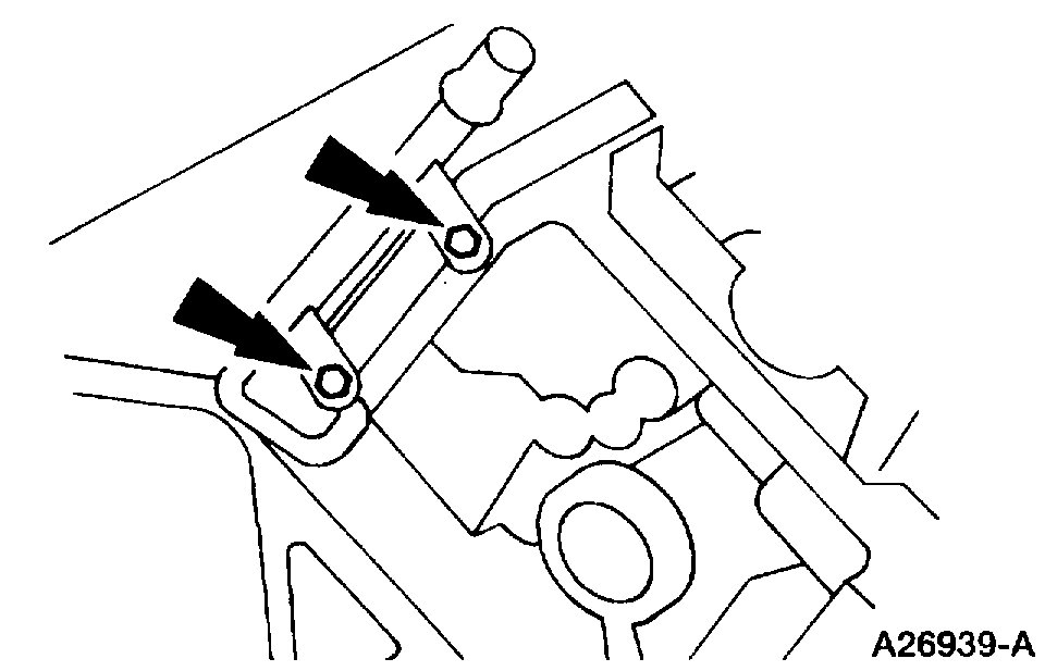

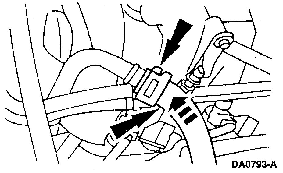

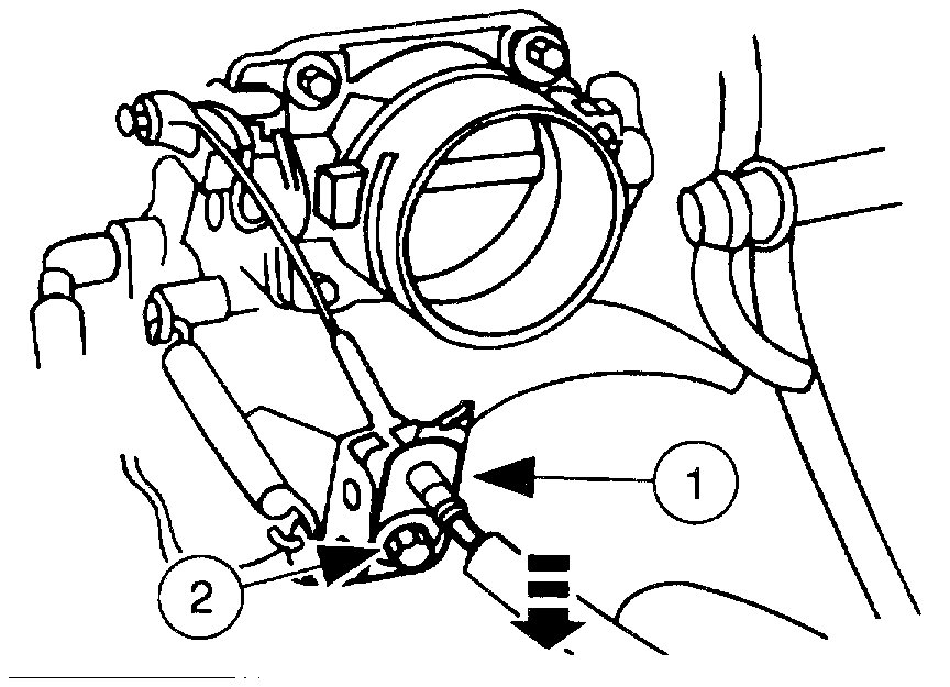

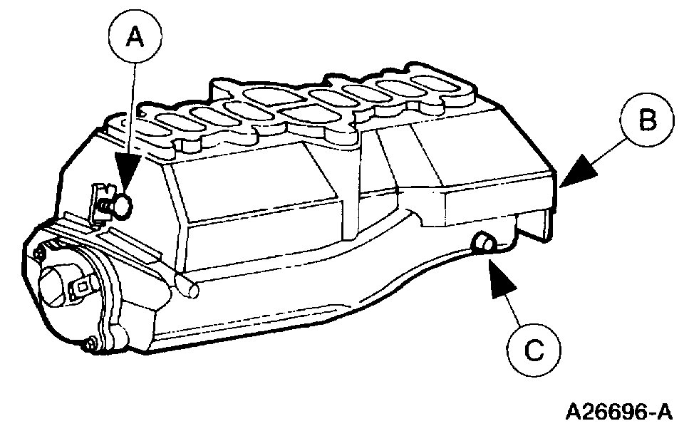

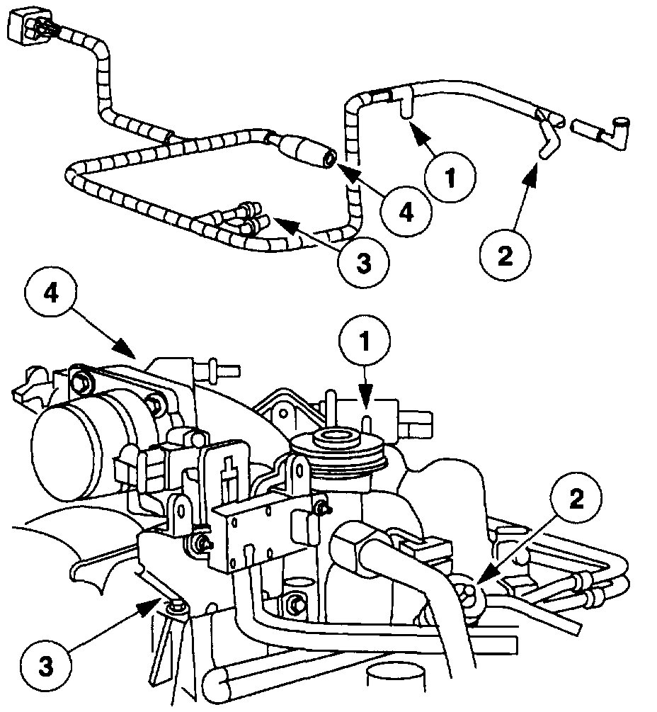

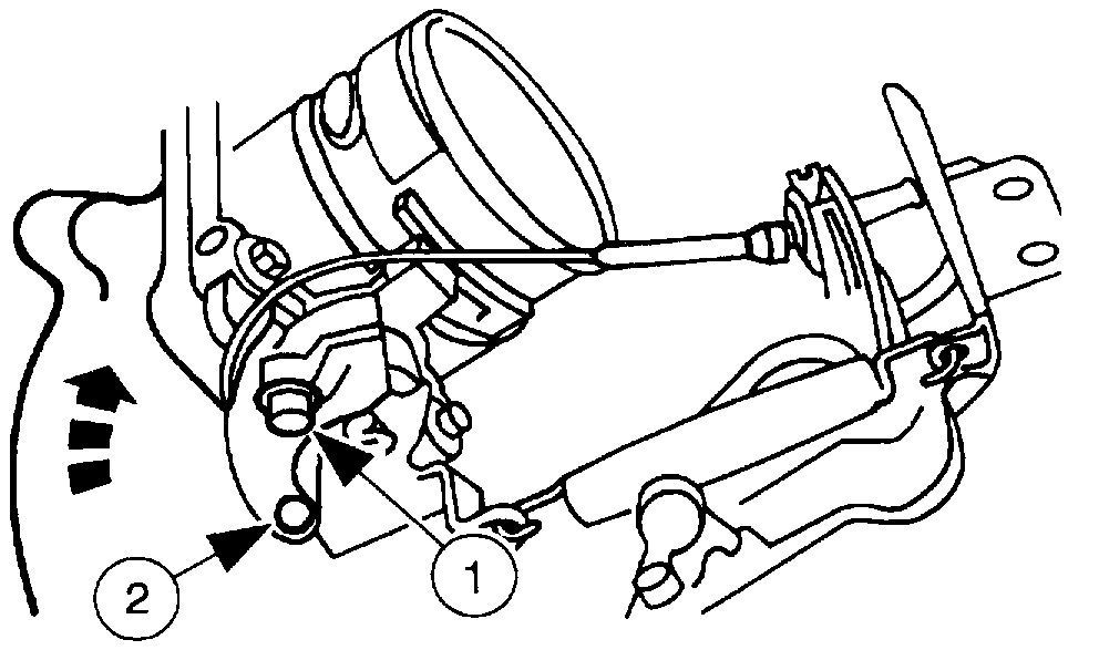

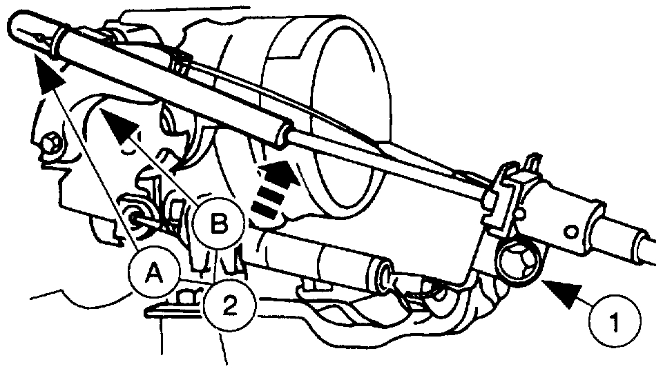

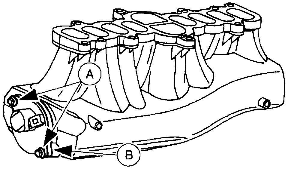

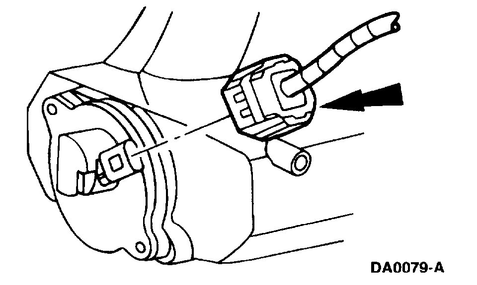

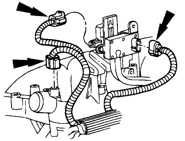

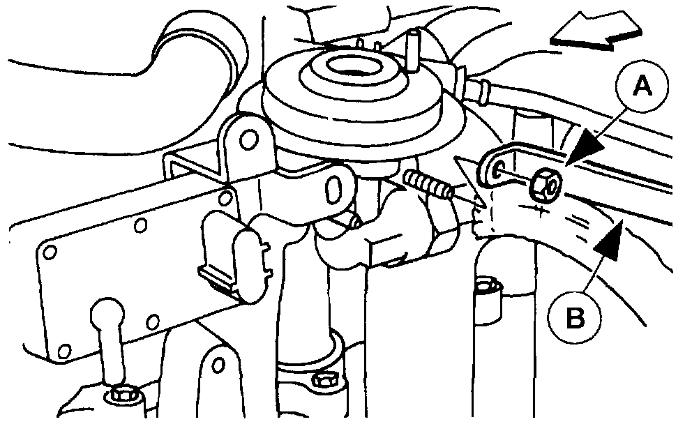

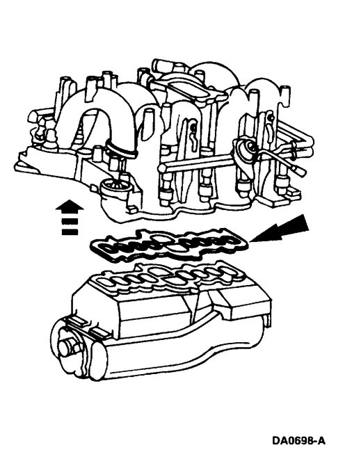

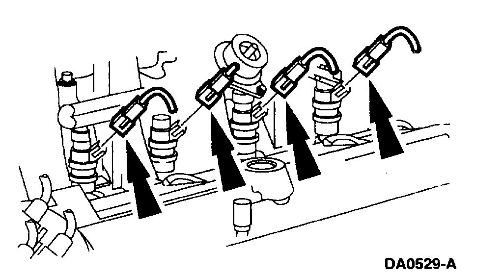

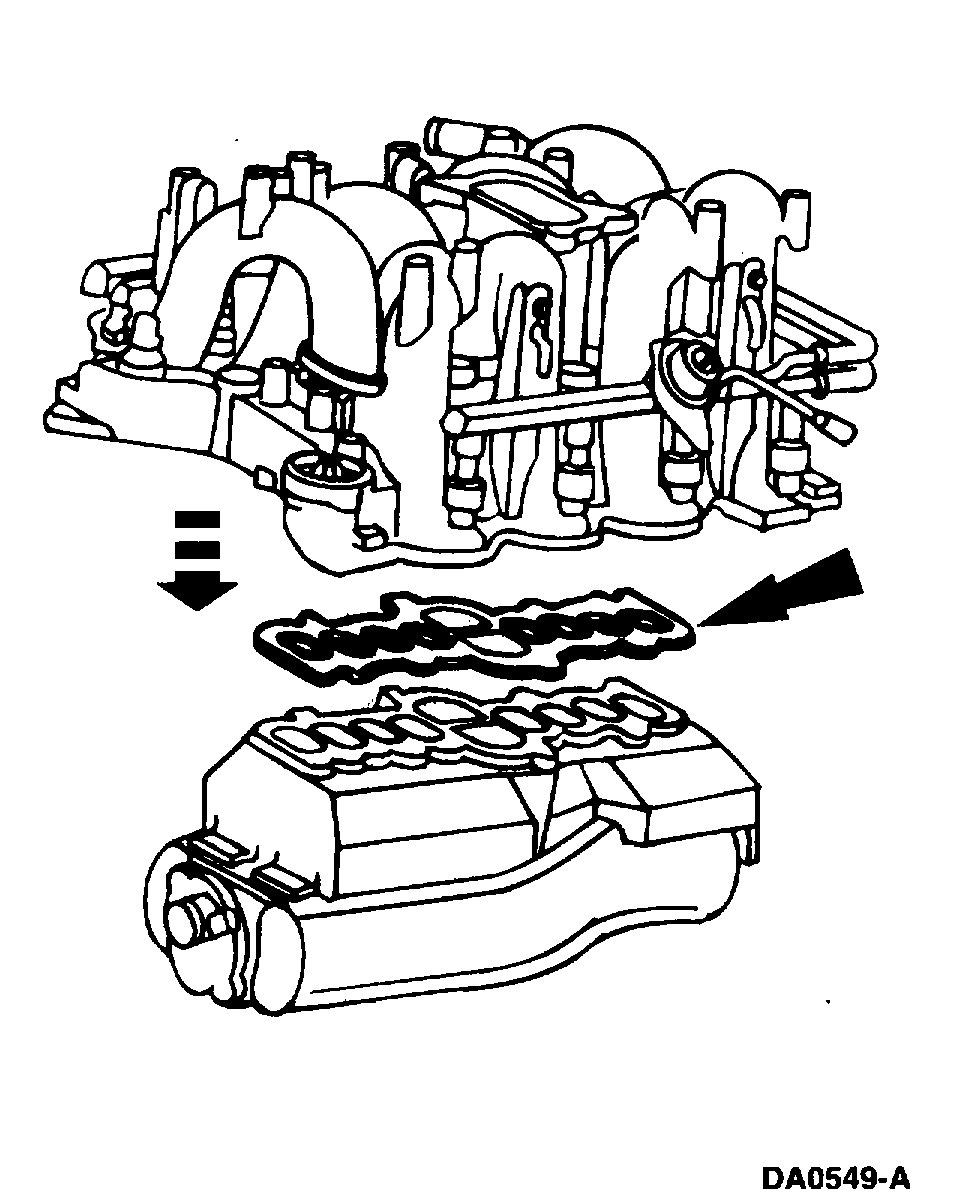

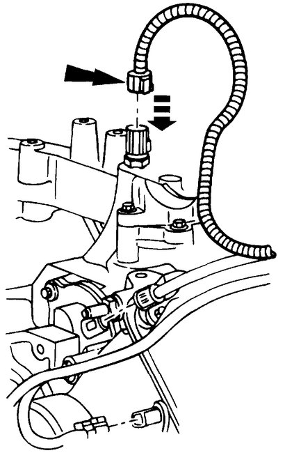

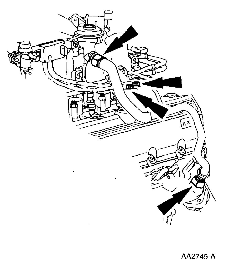

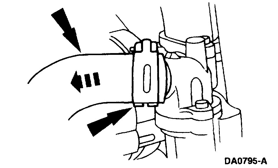

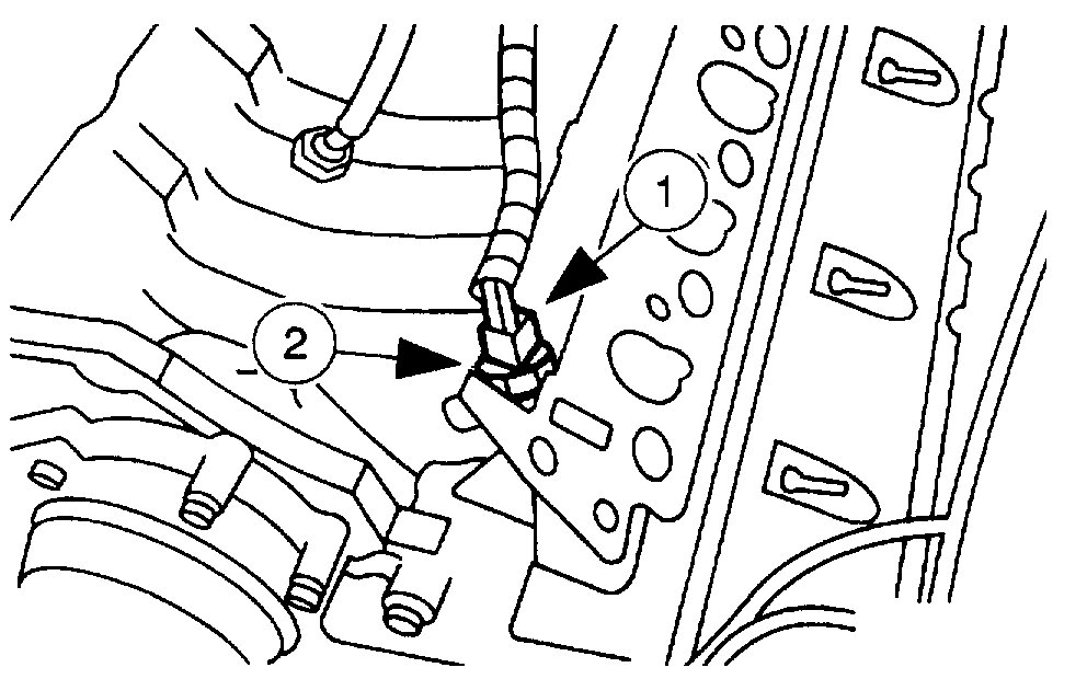

I'm having trouble replacing the intake manifold gasket. Please help.
Nov 20, 2019 at 11:18 AM
  • 110,244 POSTS

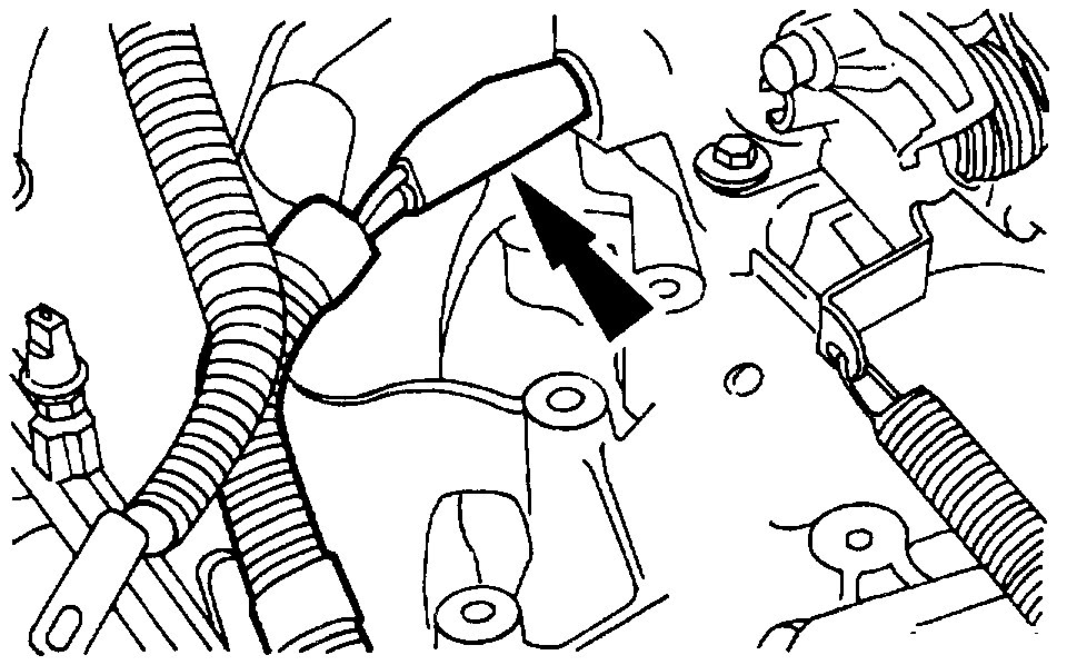

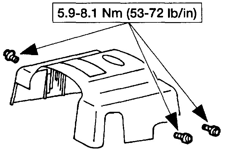

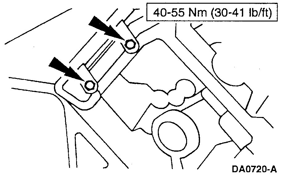

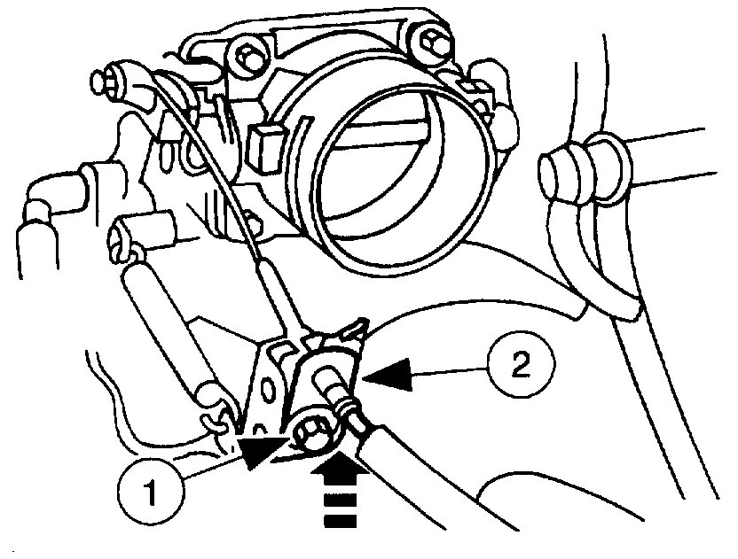

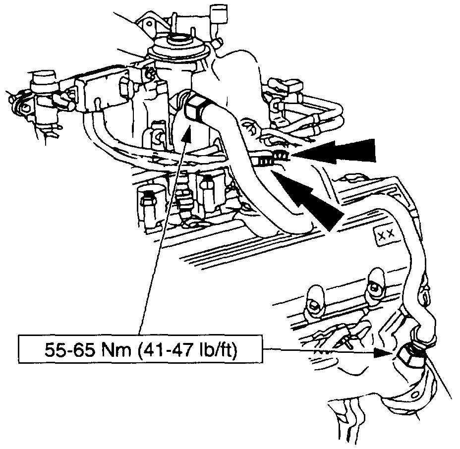

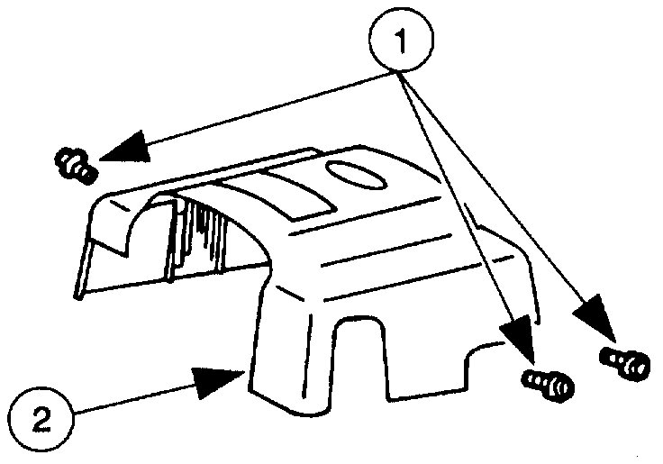

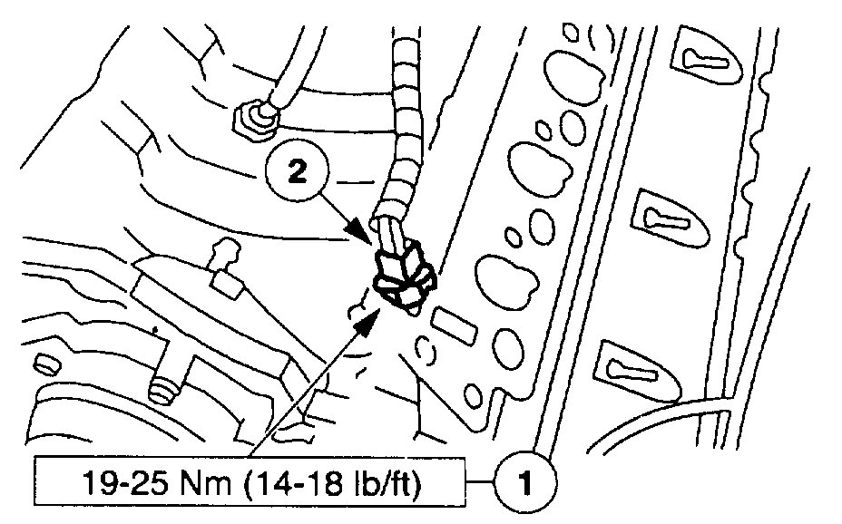

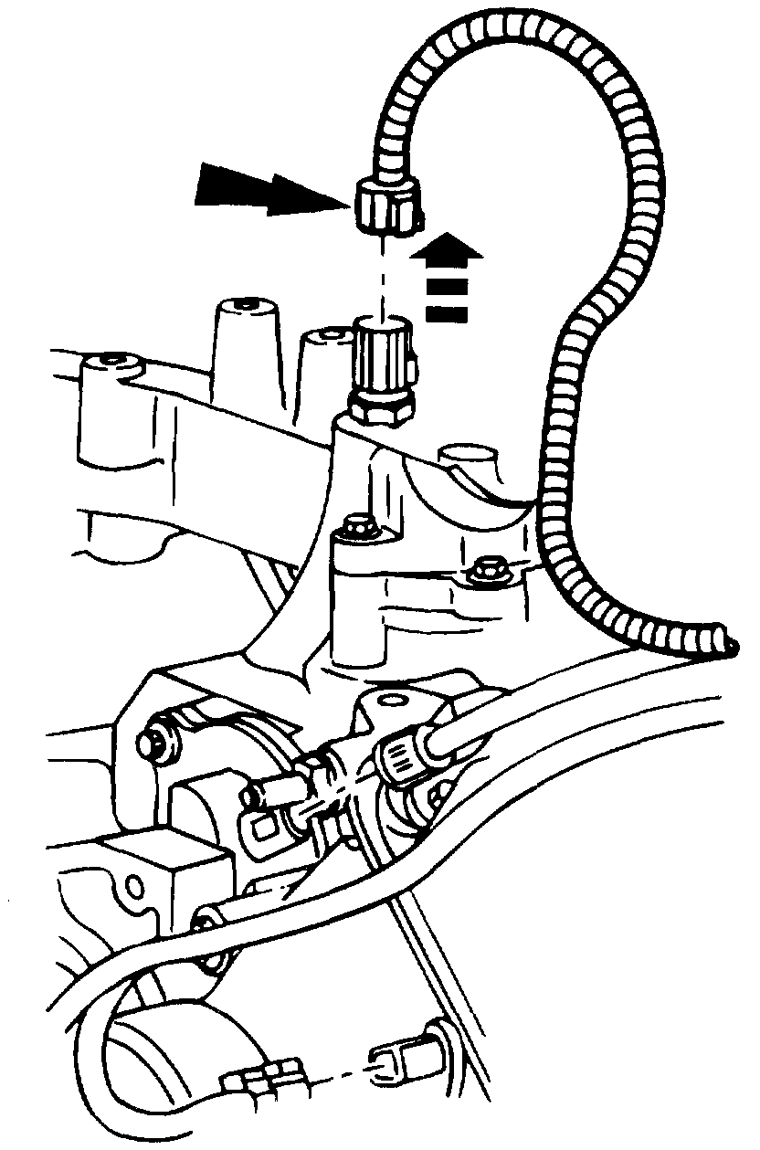

Here are the directions for replacement of the intake manifold gasket. I will include intake removal and replacement second. Check out the diagrams (Below). Please let us know what happens.
1 Disconnect the electrical connector.
2 Remove the sensor..

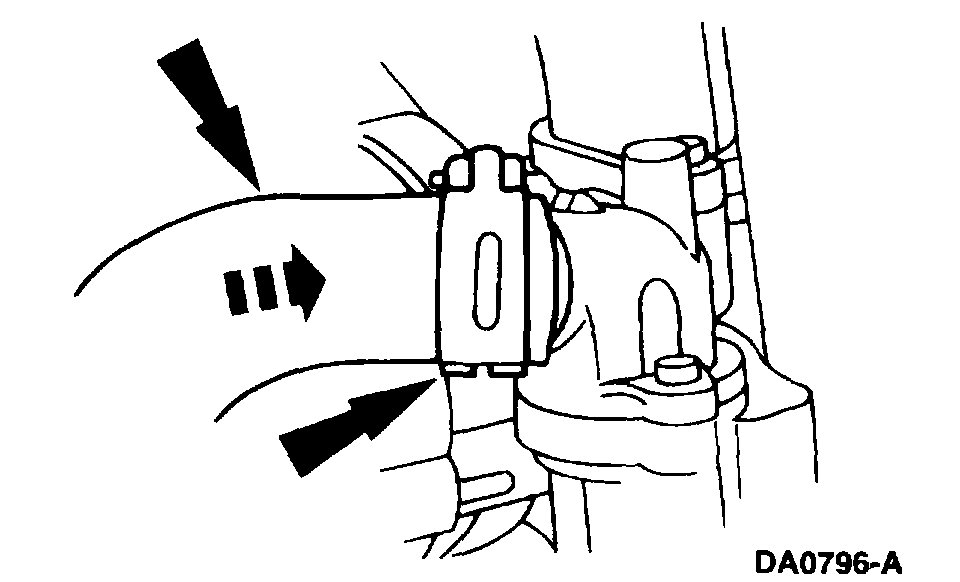

4. Compress and slide the hose clamp and disconnect the upper radiator hose.

6. Remove the accelerator control splash shield.
1 Remove the bolts.
2 Remove the accelerator control splash shield.

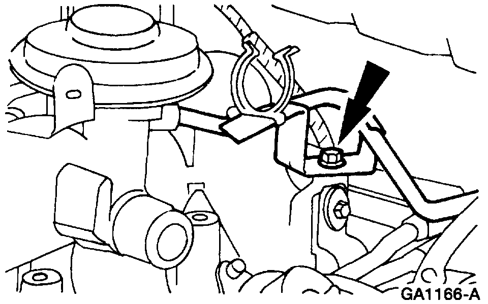

7. Disconnect the accelerator cable from the accelerator cable bracket.
1 Remove the bolt.
2 Slide the accelerator cable up to remove it from the accelerator cable bracket.

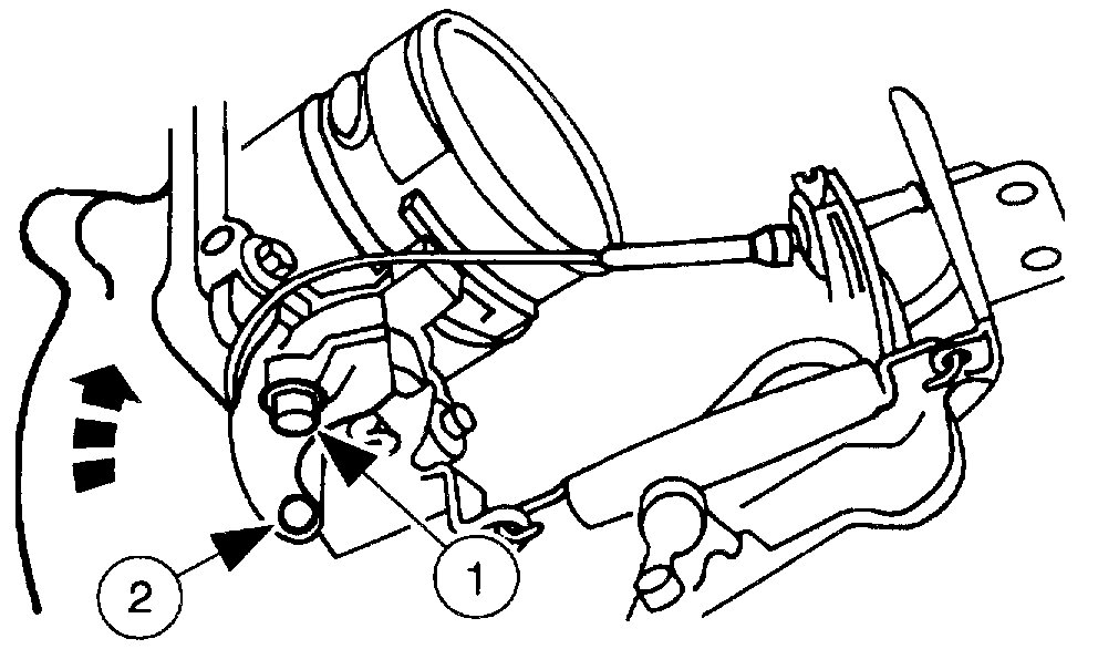

8. Disconnect the accelerator cable from the throttle body cam.
1 Roll the throttle body cam forward.
2 Slide the accelerator cable end from the throttle body cam.

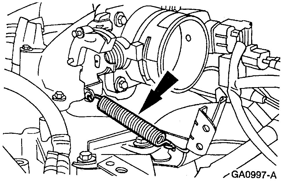

9. Remove the throttle return spring.

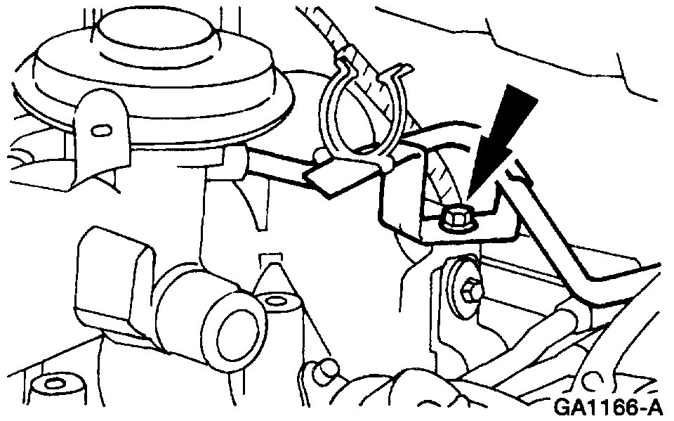

12. Remove the bolt and the brake booster vacuum hose and bracket.

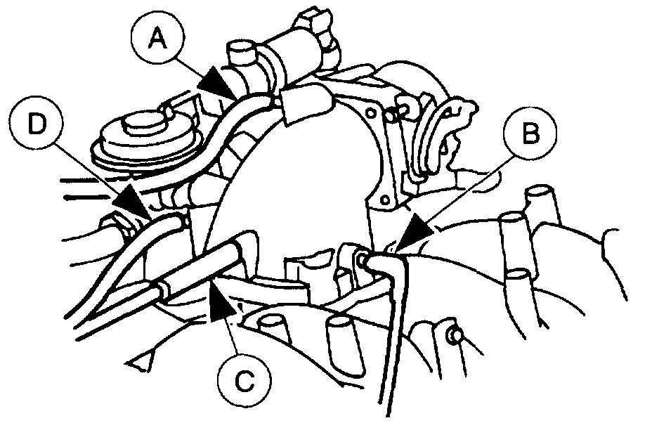

14. Disconnect the following throttle body hose connections:
^ vapor management hose (A)
^ engine vacuum regulator (B)
^ Positive Crankcase Ventilation valve (PCV valve) (C)
^ power brake booster (D)

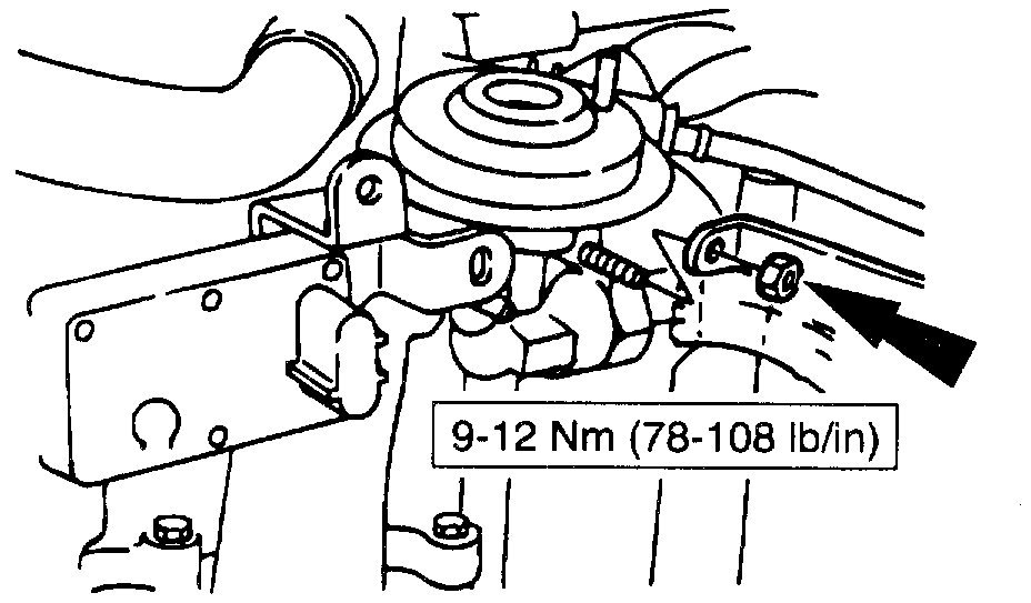

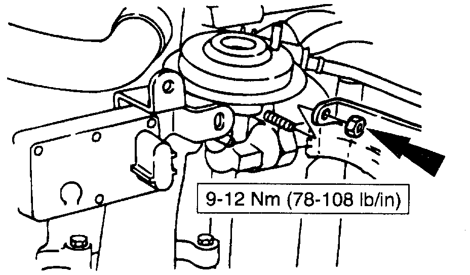

15. Remove the (A) brake booster vacuum hose bracket nut from the (B) brake booster vacuum hose bracket.

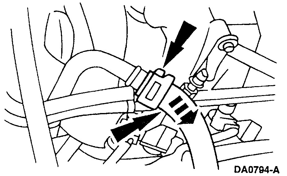

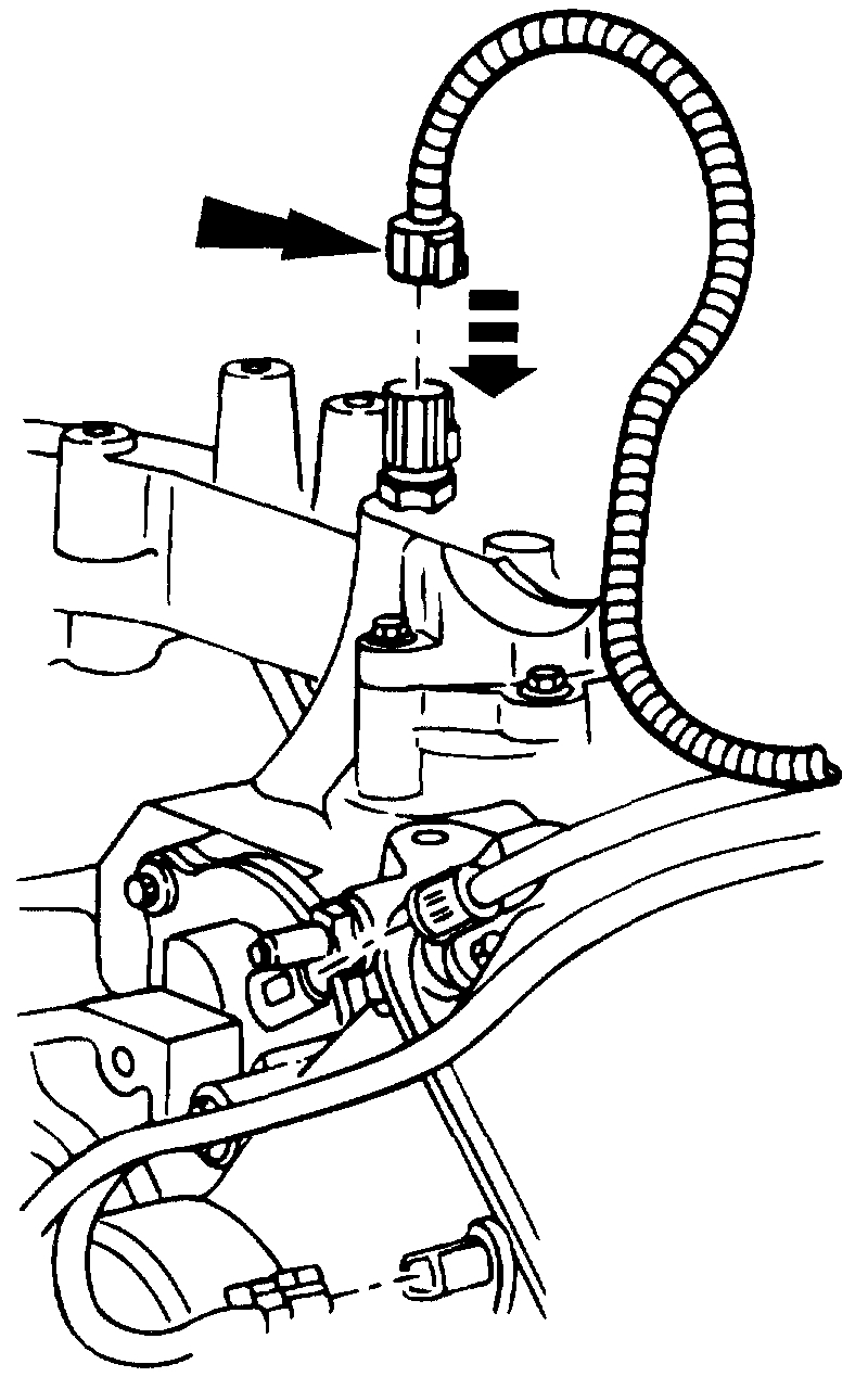

16. Disconnect the fuel lines.

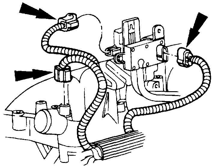

17. Disconnect the following electrical connectors:
^ idle Air Control (IAC) valve
^ Differential Pressure Feedback (DPFE) transducer
^ Engine Vacuum Regulator (EVR) sensor
18. Remove the EGR valve to exhaust manifold tube
^ Disconnect the upper and lower EGR valve to exhaust manifold tube fittings.
^ Disconnect the two DPFE hoses.

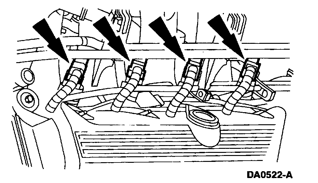

20. Disconnect the RH fuel injector electrical connectors.
21. Disconnect the LH fuel injector electrical connectors.
22. Disconnect the water temperature indicator sender wiring.

28. Remove the studs.
29. Remove the water thermostat.

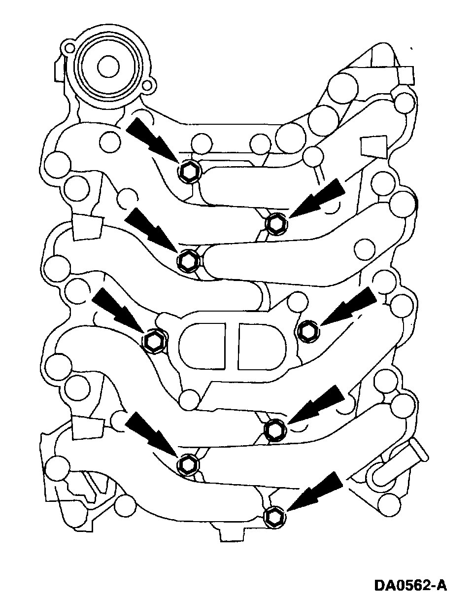

30. Remove the nine bolts.

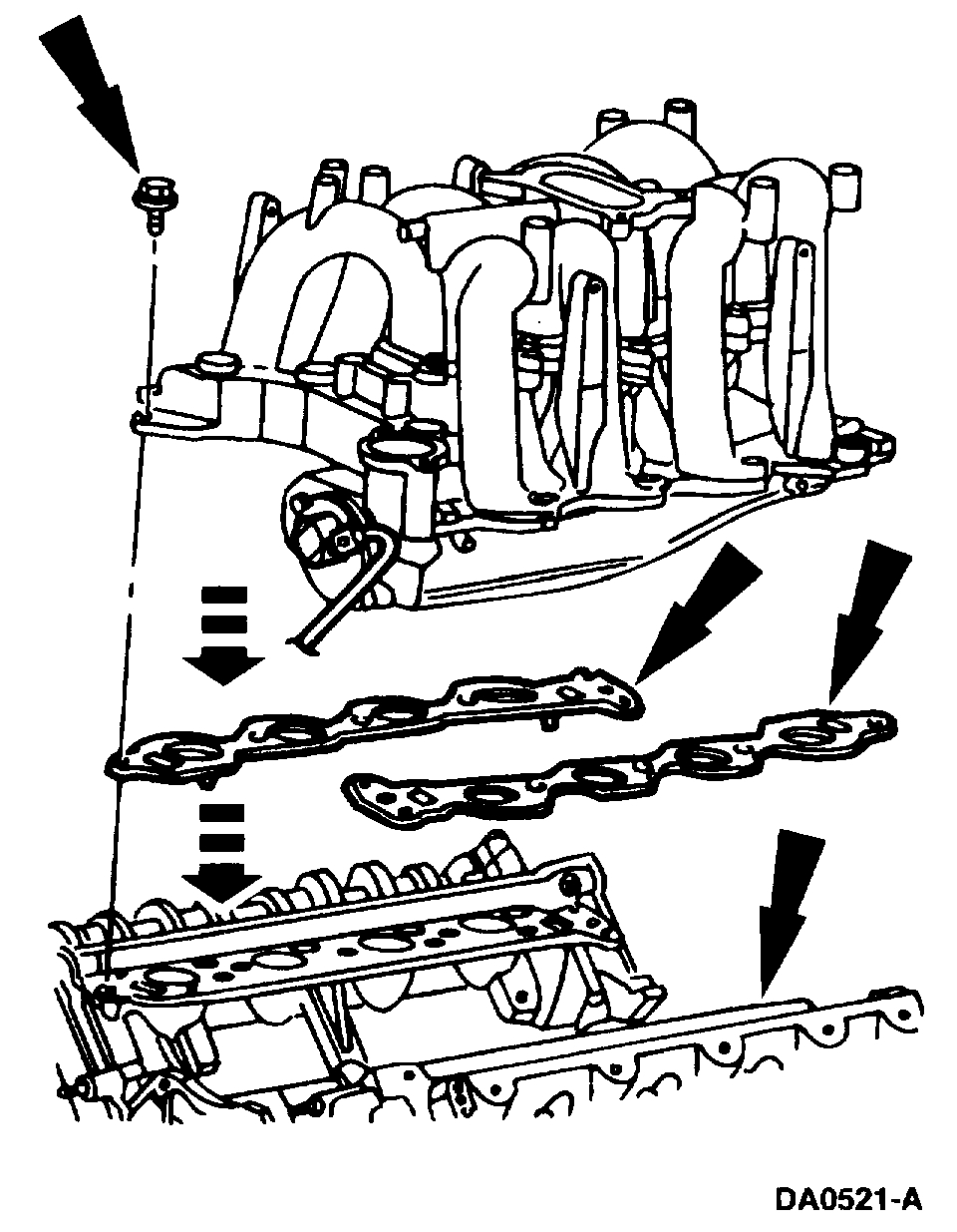

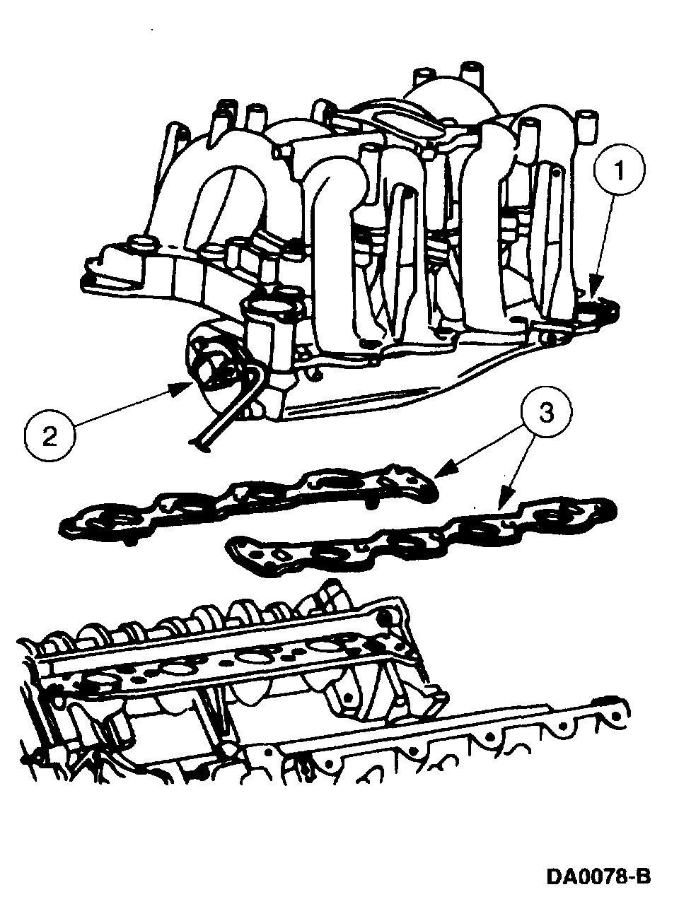

31. Remove the upper intake manifold.
1 Lift the intake manifold.
2 Disconnect the Intake Manifold Tuning Valve (IMTV) connector.
3 Remove and discard the upper intake manifold gaskets.
32. Remove the bolts.
33. Separate the upper intake manifold from the lower intake manifold and discard the lower intake manifold gasket.

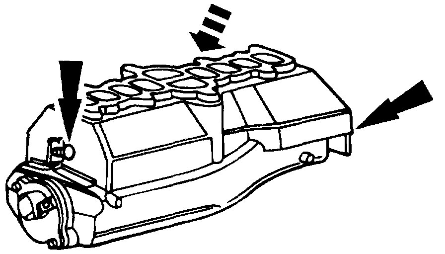

34. Remove the (A) pushpin from the (B) intake manifold insulator and remove from the (C) lower intake manifold.
35. Remove the (A) bolts from the (B) intake manifold tuning valve and remove the intake manifold tuning valve.

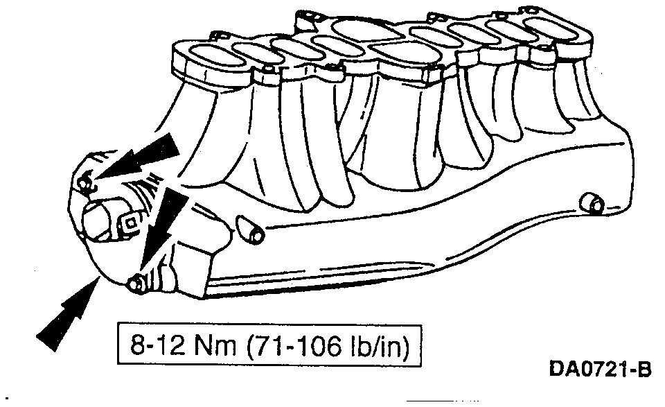

INSTALLATION
1. Position the intake manifold tuning valve and install the bolts.
2. Install the intake manifold insulator on the lower intake manifold and install the pushpin.

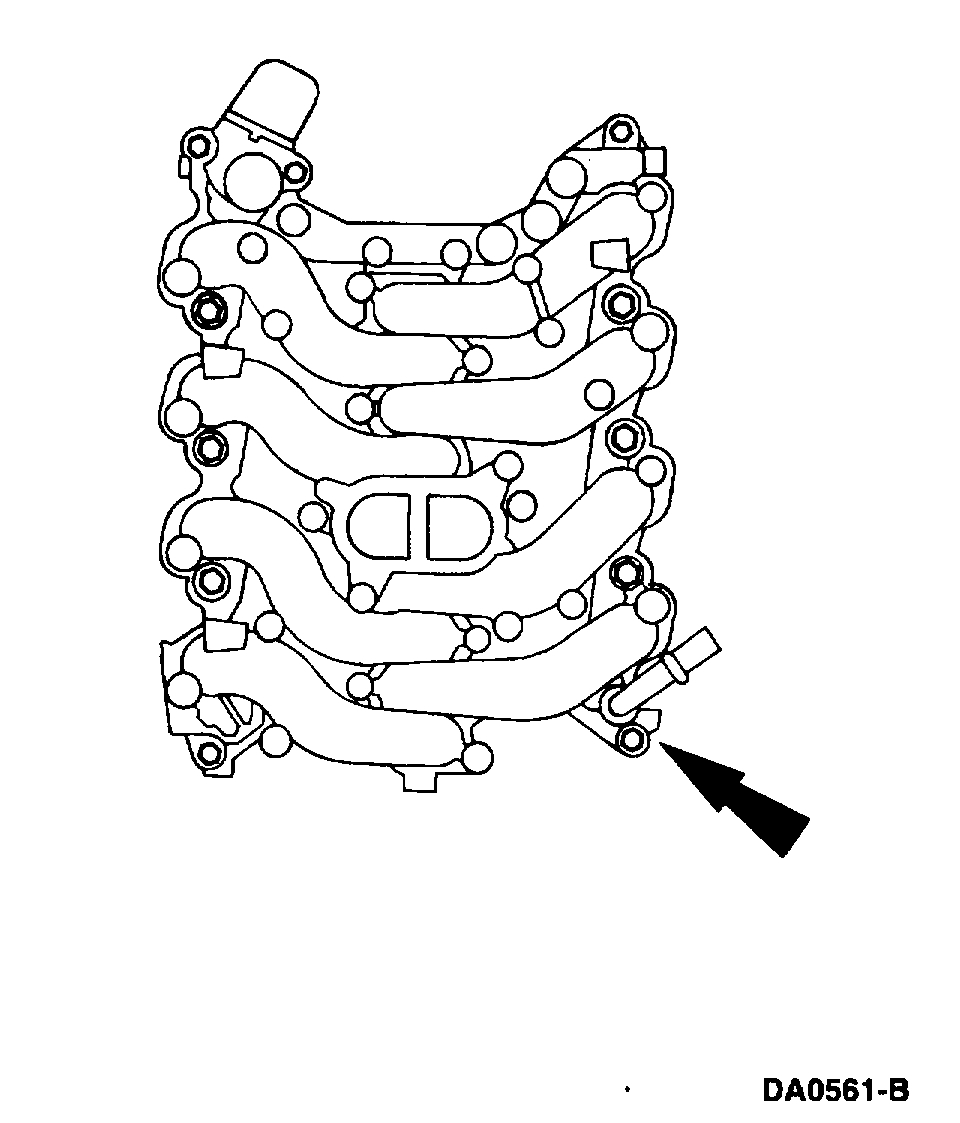

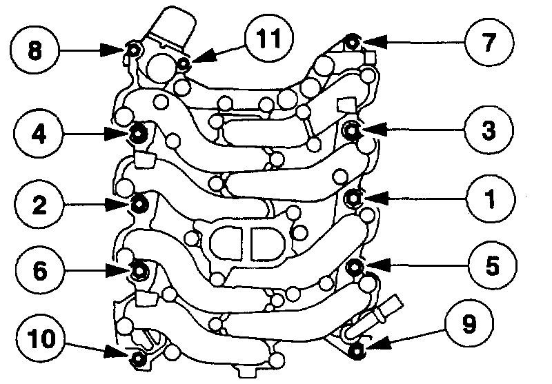

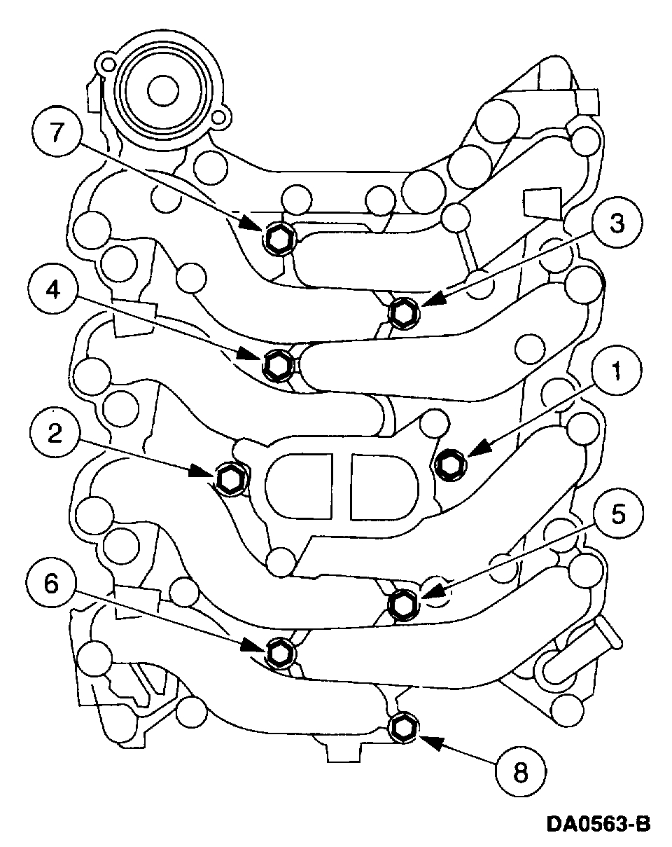

3. Position the lower intake manifold gasket and the upper intake manifold on the lower intake manifold and loosely install the eight bolts.
4. Tighten the bolts in two steps, in the sequence shown.
Step 1: 2 Nm (18 inch lb)
Step 2: 8-12 Nm (71-106 inch lb)

6. Install the upper intake manifold.
^ Position the upper intake manifold gaskets.
^ Position the upper intake manifold.
^ Loosely install the nine bolts.
7. Connect the intake manifold tuning valve connector.

9. Tighten the bolts in two steps, in the sequence shown.
Step 2: 20-30 Nm (15-22 ft. lbs.)

12. Connect the water temperature indicator sender wiring.

16. Connect the LH fuel injector electrical connectors.
17. Connect the RH fuel injector electrical connectors.

19. Connect the EGR valve to exhaust manifold fittings, and tighten to specification.

21. Connect the fuel lines.
22. Position the brake booster vacuum hose bracket and install the nut.

24. Connect the accelerator cable to throttle body cam.
1 Rotate the throttle body cam forward.
2 Slide the accelerator cable into the throttle body cam.

28. Install the upper radiator hose and reposition the clamp.

30. Install the engine cover.
