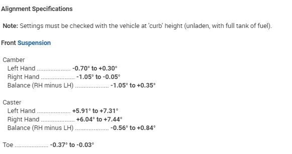

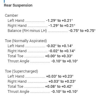

Yes sir I will .Thanks again. Do you know if the car back wheel carries a camber? If yes do you know how to adjust it please?Thank you.
Apr 12, 2019 at 4:23 PM
  • 110,194 POSTS
Welcome back:
Yes, the rear can be aligned. However, this requires an alignment rack to properly do. You won't be able to do it by eye.
I attached all the specs for both front and rear alignment in the attached pics.
