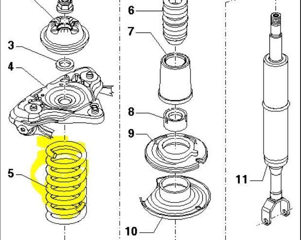

I have noticed the steering on my car is heavy and when driving feels like it has sports suspension on it as I feel every bump.
Also, when reversing or pulling away I can hear a rattle.

Have you checked power steering fluid? Since you noticed both stiff steering as well as a rough ride, have you checked to see if there is a broken coil spring on one of the front struts? Also, can you tell approximately where the noise is coming from? Do you hear it over bumps?
I attached a picture of a strut assembly. I highlighted the coil spring. Carefully inspect it for cracks or damage.
Let me know what you find.

There is a rattling noise seems to be coming from just in front of the gear box but I need to get under the car to check.
The noise is louder in reverse and quietens when I pull away.

Let me know what you find and also, check control arm bushings and ball joints.
