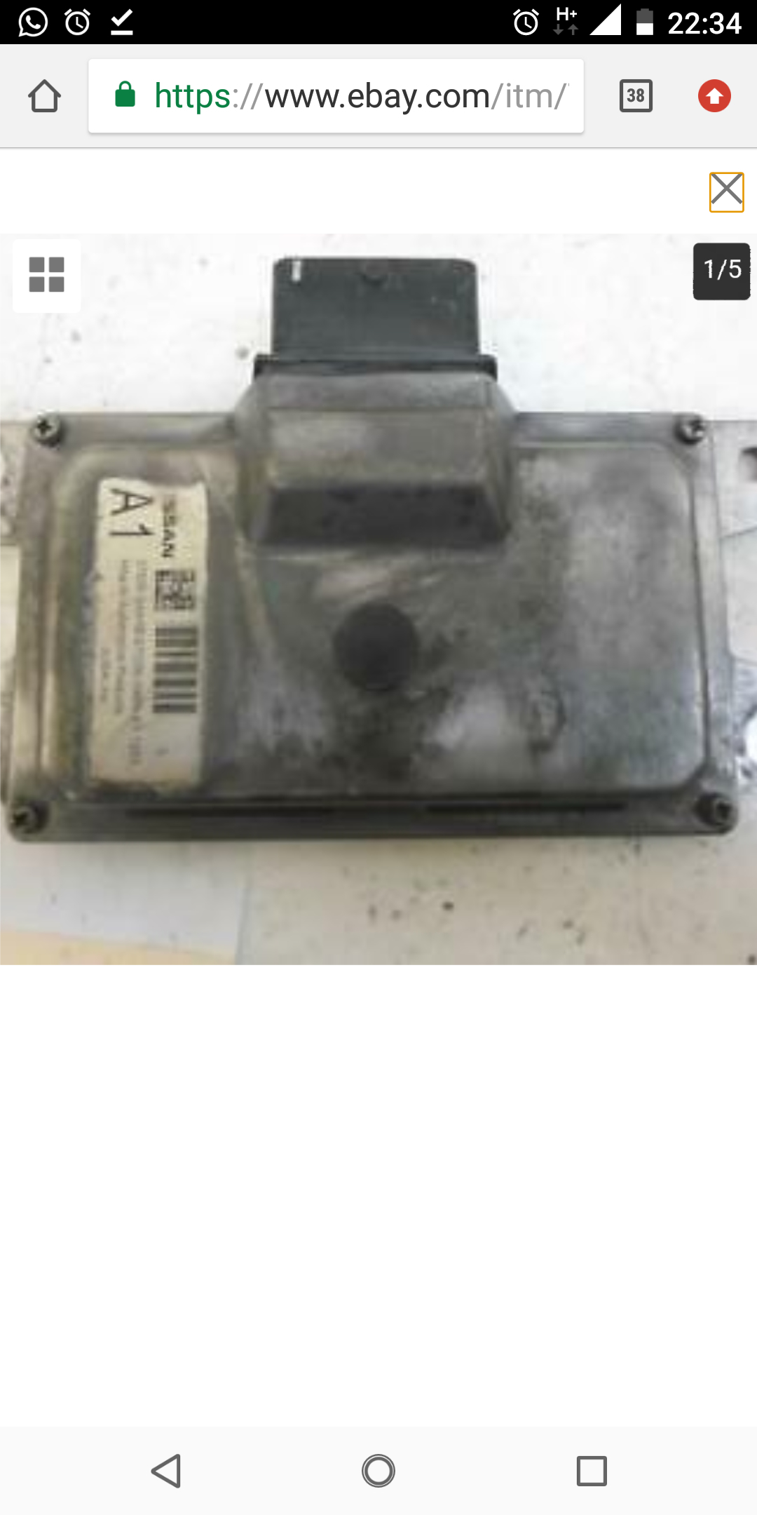

Yes but mine has a hole somewhere at the middle of the front side (the TCM) . I don't know why they put a hole there.
Jun 23, 2020 at 10:18 PM
JADDUN
  • 26 POSTS
The black covering is missing in mine (from the attached pic).
Jun 23, 2020 at 10:22 PM
STEVE W.
  • 15,239 POSTS
If the vent is missing it could have gotten water in. Not much that could be done if it damaged parts though unless you have the proper tools to test and repair it.

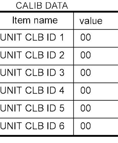

15.Select "Special function" in the Transmission menu.
16.Check that the value on "CALIB DATA" in CONSULT is the same as the data listed in the table attached. Should be all zeros in the values for each calibration.
17.Shift the shift lever to "P" position.
18.Check that the shift position indicator in the dash turns ON.
